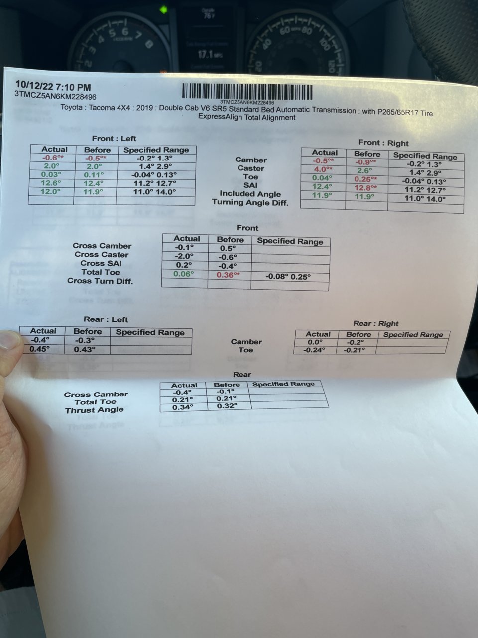

    Well, I never thought it was possible, but Firestone managed to make my alignment worse twice in a row then what it was previously.
    Does anyone know of any reputable alignment shops in Tucson that can fix this?
    Bonus points for a shop that can do a shock rebuild+other general work.
    I’ll post a picture of what they specd it to in a bit once a get back home for your viewing pleasure

    For your viewing pleasure. Alignment 1 had them try and fix a slight left pull to the left. They ended up reducing my caster after I told them to leave it between 3.5-4. Truck still pulled to the left afterwards

    Alignment 2 told, I told them to adjust the caster back and fix the pull to the left. Guy at the stop said this was the best he could get it.
    I’m not entirely ruling out some suspension or other issue that could be causing the overall issue, but I’ll be damned if they could mess it up this bad.
    Luckily I haven’t had to drive the truck much but it pulls like crazy to the left now. I’m taking it to trail boss next week to see if they can clean up this mess

    On my way to pick up my truck from trail boss right now actually. So they had an issue with their alignment machine and aren’t getting parts in for a couple days. But they took it to a neighboring shop since I needed to get it done and will be traveling this weekend. Will keep y’all updated.

    I appreciate the heads-up on their alignment machine, theluharlifestyle. I will call before I head there Friday. "None of my business" is an understandable response, but I'll ask anyway ...what did they $tap you? I'm also interested in the caster numbers. The last shop I used set caster at 2.8*L and 3.1*R. They basically refused to push it out more. And, this was with just a 3/8" spacer on top of the coilovers. I really want to be at 4+. The spacer is gone and I'm now running Eibach Pro with just under two inches of lift. Also have Ironman UCAs which should provide an additional 2*, at minimum.

    Just got back. I forgot to ask what shop they subbed it out to. But it drives MUCH better.
    $160 for the subbed out work. Trail boss would charge less. I would have waited but needed it done sooner rather than later so I was okay eating the cost.
    The owner was the one talking to me, he said if I’m not happy with it then to bring it back in and he’ll sort it out on their machine. They have no problem working to get it to whatever alignment specs you want.
