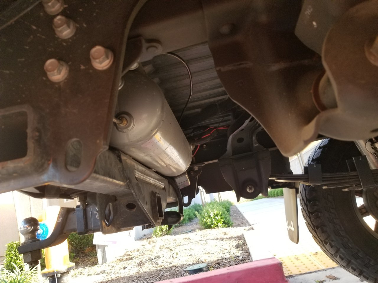

    I mounted my 2.5gal tank to the backside of the rear bumper20190502_184055.jpg you can still fit the spare up there if you have any kind of lift. Otherwise it will hit the rear diff

    I was wondering about that location. Thanks for the photo.

    I did have to cut and reweld the mounting points on the tank to move then inward to be able to mount behind the licence plate

    OP, this is what I was referring to. Apologies. Mine is the same size, 2.5 gal, not 4 that I previously mentioned.

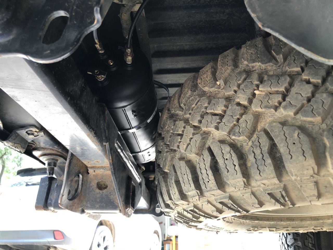

    Well, I dropped down to a 1.5 Gallon and was able to get it to fit behind the bumper with a spare. After looking all over for alternative places, this seemed the be the least risky. It will just barely fit with a 265/75r16 duratrac under there. The spare is fully retracted in case the photo makes it look otherwise.473C0FE2-658D-4EB1-BD1E-99932CCE4169.jpg
    thread title changed in case anyone is searching for this solution.
