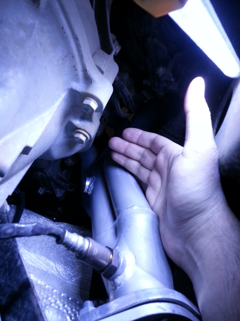

    I've got the code P0051 (H02S Heater Control Bank 2 Sensor 1) which is the upstream drivers side sensor. It's a $&@* to get at. Has anybody done this and found the easiest way to get it? I might have to take the manifold stay off to get room to get it out with a 22mm crowsfoot and a short flex head breaker bar. I'm worried if I take the manifold stay off I could damage the exhaust manifold with how hard I'll have to pull on it. I doesn't look like I'll be able to go at it from the top...Also, would it be best to heat it with a torch or run the exhaust hot and try to work fast with gloves on? It's not easy even getting the crowsfoot on it.

    Justus
    Justus fucks not given
    Jan 4, 2013
    #94417
    9,230
    Nabisco the kid
    In ur toolbox
    not so low, not so slow 2006 6 lug
    stockish
    this one?

  4. Mar 17, 2014 at 1:43 PM
    faller
    faller [OP] Active Member
    Mar 5, 2011
    #52403
    35
    Vancouver Island
    Tacoma
    Bilstein 5100's @ 0.85, Toytec/Eibach coils, 1.5" AAL fbconvert's DIY AUX Input
    It's the one closest to the motor on the drivers side. I used a 22mm crow foot and a short flex head breaker bar (couldn't use a ratchet because there wasn't enough clearance between the crowsfoot and the sensor). I disconnected the front end of the front driveshaft and that gave me enough room to get it off. It actually came off easier than I thought it would. The exhaust was still a little warm but not hot. I decided to keep the manifold stay on because I didn't want to damage the manifold (2005 with 200,000 kms and the studs into the head didn't look like something I'd want to play with if I damaged the manifold). I'm glad my 1/2" set of crowsfoot is 12point style. I had to switch it from one side to the other to have enough swing then I used a 22mm stubby wrench then got it by hand.
    So to anybody that has to do it, just disconnect the front of the front drive shaft and move it towards the centre of the truck. The passenger side looks like it has a lot of room and the downstream sensors are super easy to get at.
