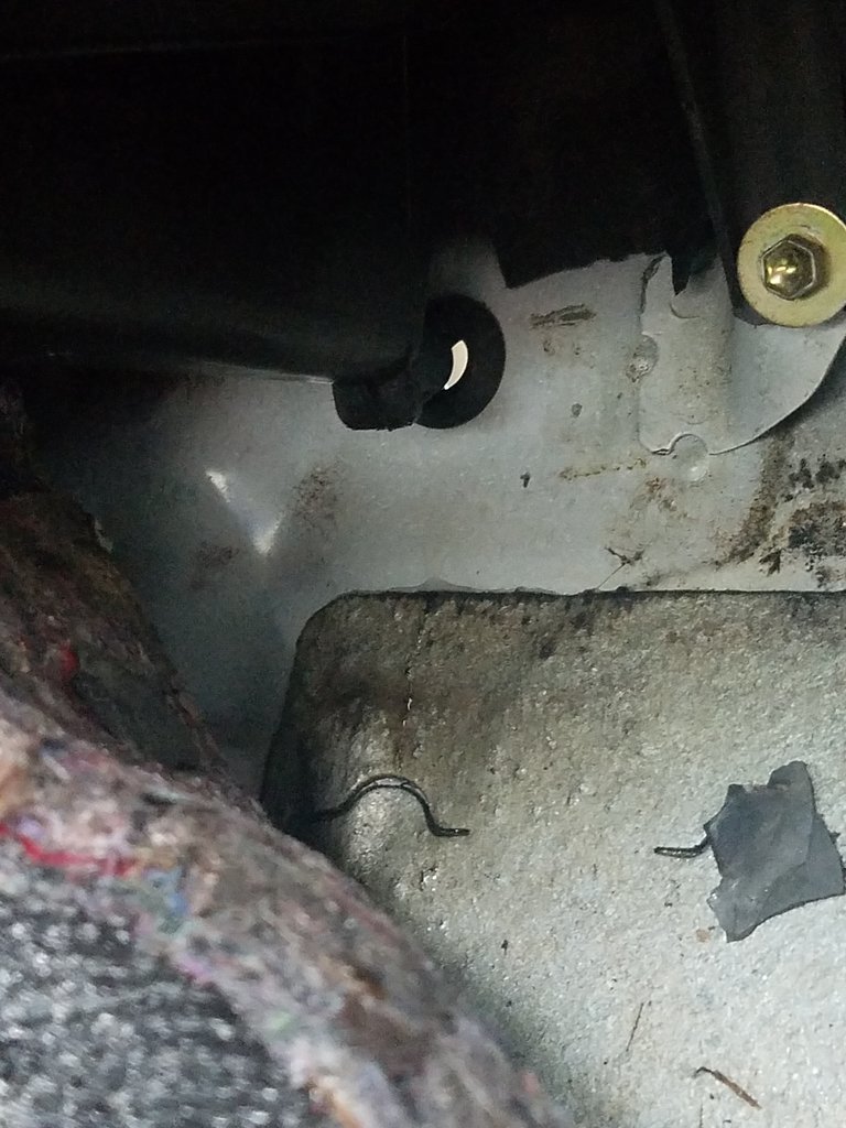

    My solution was plastic vacuum hose connector, 3/8" ID hose, and zip ties
    Finished Product
    Hose connected to coupler, the tabs get snipped off with Diagonal pliers
    Parts and tool​
