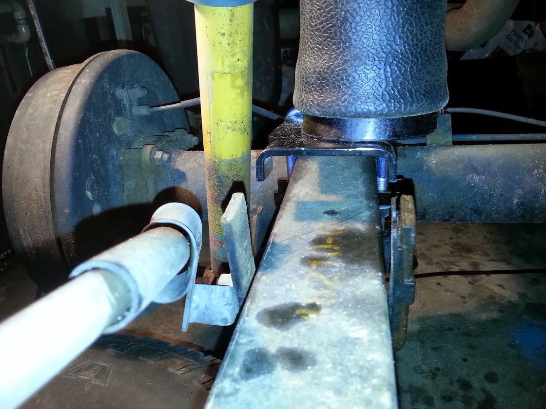

    I installed these on my 2011 TRD Off Road and took this photo before connecting the lower brace. The gap is about 1.5 inches:
    The truck here is suspended by the frame so the spring is completely relaxed. Note that the air bag would stretch some, I don't know how much.
    Once inflated, these definitely level the load and ride nice. To find level I made up a small chain with a hook. When hooked in a safety chain eye on my hitch, the small chain just reaches the pavement when the truck is level. To level the load: Air up until the chain isn't dragging.

    Shown in the photo above are the Air Lift #59561 air bags. The original post was about articulation and this type of suspension helper. I promised I would post photos, then procrastinated about the install until now.

    One other thing I noticed about AirLift is that it shortens the upward travel of my axle as well as the downward extension I posted about previously.
    That is, if the air bags are completely deflated, it is they and not the OEM bumpers that hit first when you go over a speed bump.
    The air bags must be kept inflated. They're surely not intended to be used empty as bumpers, so they hit pretty hard with a thunk that you hear and feel. I thought my shocks were trashed but it was a flat air bag. I found the air line leak, re-inflated the air bag, and no longer have that hard-bottoming-out problem.
    So -- AirLift definitely adversely affects articulation for off road. However if your truck is lifted then the upward travel limitation might not cause a problem. Contact the manufacturer and see if they can substitute longer air bags to allow for the lift and to lengthen the downward extension.
