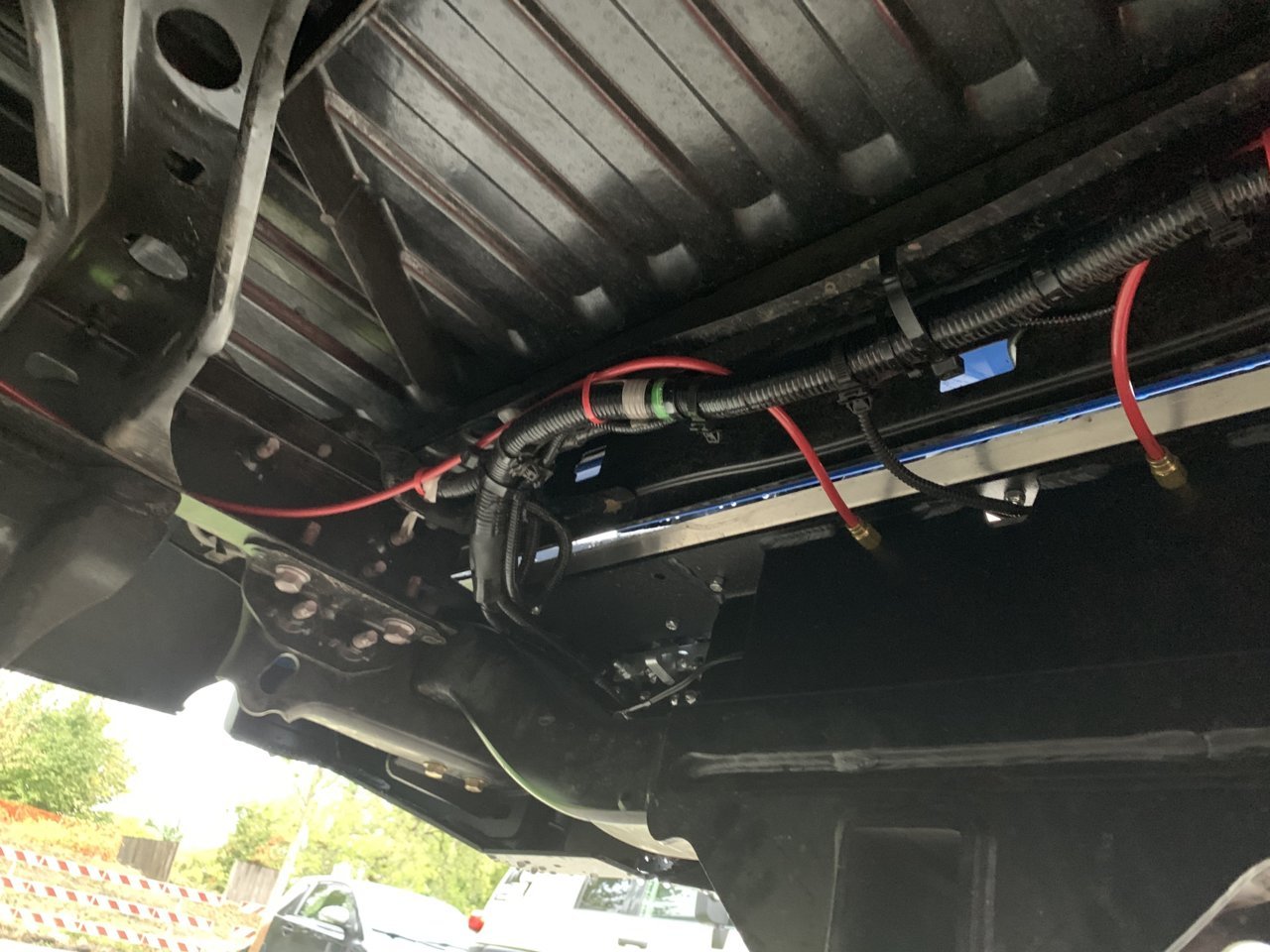

    Won't hurt to wrap the air lines with wireloom when you install.

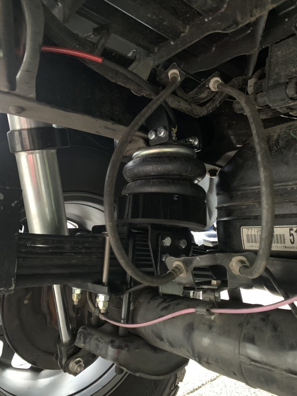

    As above, I've got Firestone bags, Daystar cups and an OBA compressor. I carry a constant load of tools and supplies so not just an empty bed. I have to have about 10-15 psi in there to keep from bottoming on the internal "stops" while using as a DD. No big deal if you ask me - this is the third vehicle I had with bag assist and it has always worked fine for extra capacity "on demand". The Taco has way too small capacity standard leafs in the rear - maybe 1/4 ton load? They were maybe designed for a single passenger, personal transportation sort of life - not what I expected from a "half ton" truck.

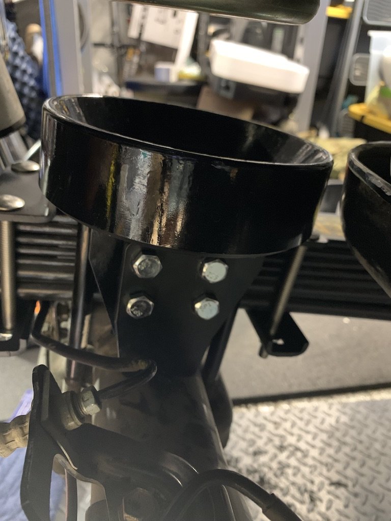

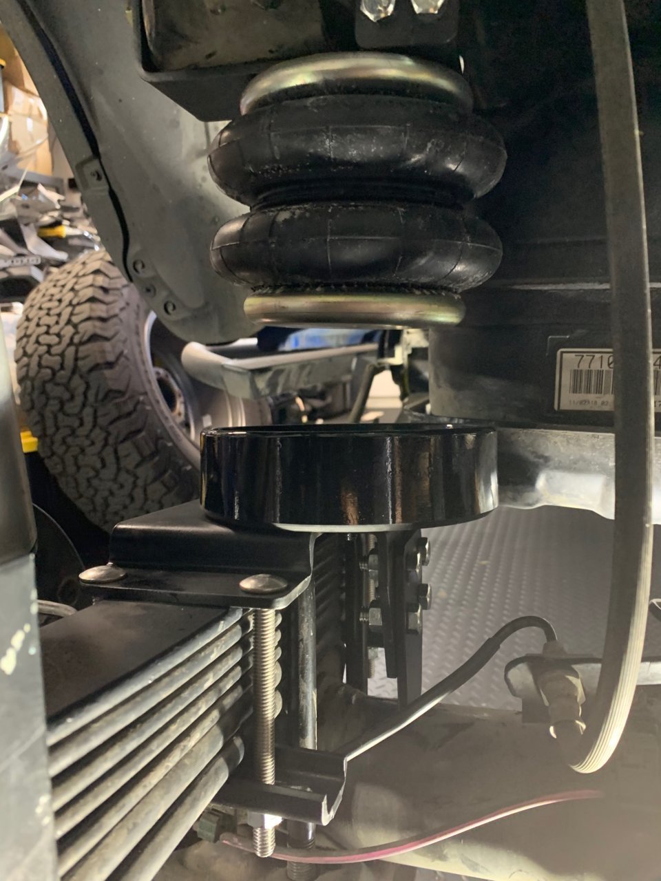

    I've had my airbags on for about 4 years, and just recently added cradles. I always have a bike pump with a gauge on it in the truck for mt biking, and it only takes a few pumps to get the airbags up to 20psi. I've never felt the need for a sensor or on board air with them. As long as they don't leak they're pretty much "air up and forget about them" for a while. I put my shrader valves inside the gas cap door to keep them clean and easy to check. Probably doesn't even take 2 minutes to adjust the pressures. (I put each bag on it's own air valve so that it would help reduce body roll, and so that I could lean the truck to one side when camping and sleeping in it)
