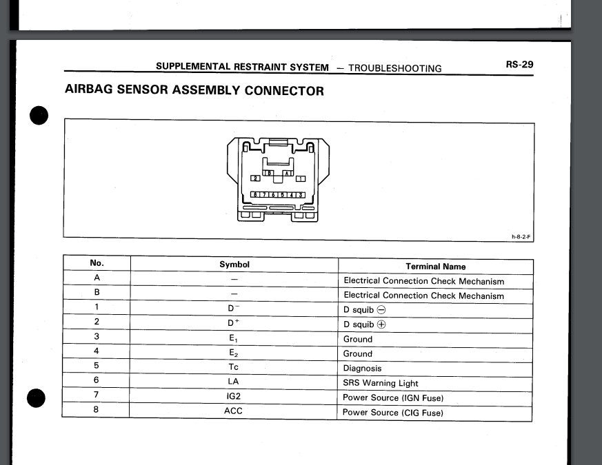

    I ended up finding the service manual, it said to jump the pins at the diag port under the hood. I jumped them and cruise flashes as it should, airbag light is steady on. manual says to check the voltage of the diag pins, as long as they're between 10 and 16v the circuit for the light is good. it was at 13. I do not get any blink codes, the light just stays constantly on.
    I don't understand this diagram though. this is the connector to the airbag module, where does the crash sensor come into play? alot of people say to check the sensors, but i couldn't find them, or atleast even find how they connect to the module.
    I ended up pulling the module out and the light went away. for now i can atleast get to work and not have to worry about my battery draining ( i think)
    i'm going to run the diag on the assembly connector tomorrow, i have to read about it some more but depending on the resistance of some if the pins i'm starting to think the module might have went bad.
