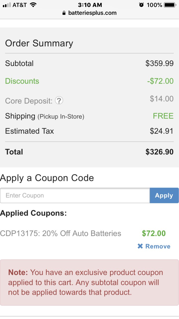

    Btw, code CDP13175 gets you 20% off so that’s $72 savings then $30 mail in rebate for a $102 saving until March. Damn good savings!

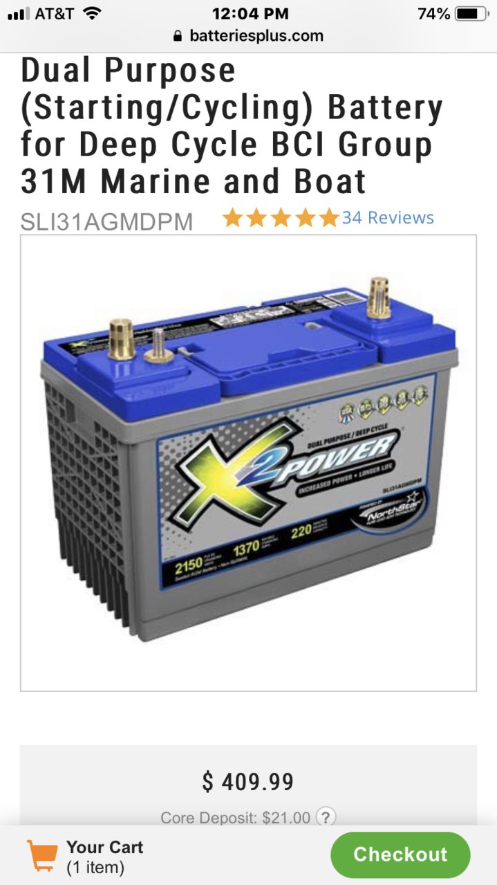

    Been there, done that. They call the X2 Power a “Deep Cycle, Dual Purpose (Starting/Cycling), Starting“ battery. It’s either a lie, which I doubt, or a new style configuration.

    There’s no way you can get that for $109. That’s a $400 battery. If it WILL let you buy it for that then order 10 of them and make a small fortune.
    Can you post a direct link to that so I can buy some????
