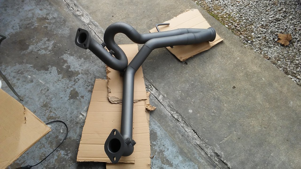

    Needing to replace my y pipe has anyone ran a aftermarket y pipe? Any good brands or any other information about them?

    JFR is not taking new orders. I sued one would have to be sourced. URD offers two version of the Ypipe. Regular and an Equal Length set up that is part of a complete system. I had the Doug Thorley until the hangers rusted off and decided to go with the regular URD version. All is well.

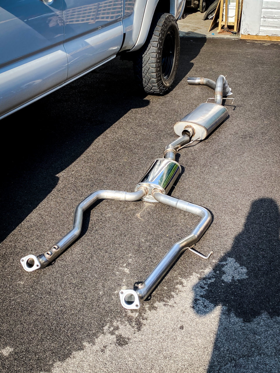

    Are you running that Spec-U exhaust on stock headers ?

    I do not love how you coated it. When you first posted it was awesome!

    Whole exhaust is ceramic coated. We all know how beautiful the welds are but I'm going for longevity.

    Def I love the look of the ceramic set

    The top cats have long tubes that remove those cats to remove the later 2, which would be any aftermarket Y pipe.
    URD used to have one. AFE and a few others do, but the other route is custom. I would say yes, a bunch of people do that. The aftermarket Y not only removes the Cat but the goal is to get better flow and equal length as well since the stock has that big bend i think on the right side.
    A couple of folks in the boosted thread have gutted their cats but still have the sensor, so it looks "stock" but has a more passthrough design. Older 2nd Gens can use DT or JBA shortie headers and weld on the stock cats for low-end improvement. Later, 2nd gens are out of luck. JBA used to have an approved CARB exemption, but they no longer sell the set due to low sales. When I called and said sites still had it up, he laughed about adding it back. Not with only selling maybe 10 a year. Dough Thorley had a set of shorties pending CARB Exemption since it came out, but it's pretty clear they have abandoned that. A few of us have tried to contact them, and they just say oh, it's being delayed and SEMA blah blah, but they have a ton of newer makes/models getting approved, so it's likely never going to happen. It sucks, too, as I have 2 sets of new shorties in the box. I was going to put on a set and ended up with a second I would sell.
    The CA folks that run Y pipes are in every 2 years swap out the aftermarket for the Stock Y for Smog, then swap back in the aftermarket.

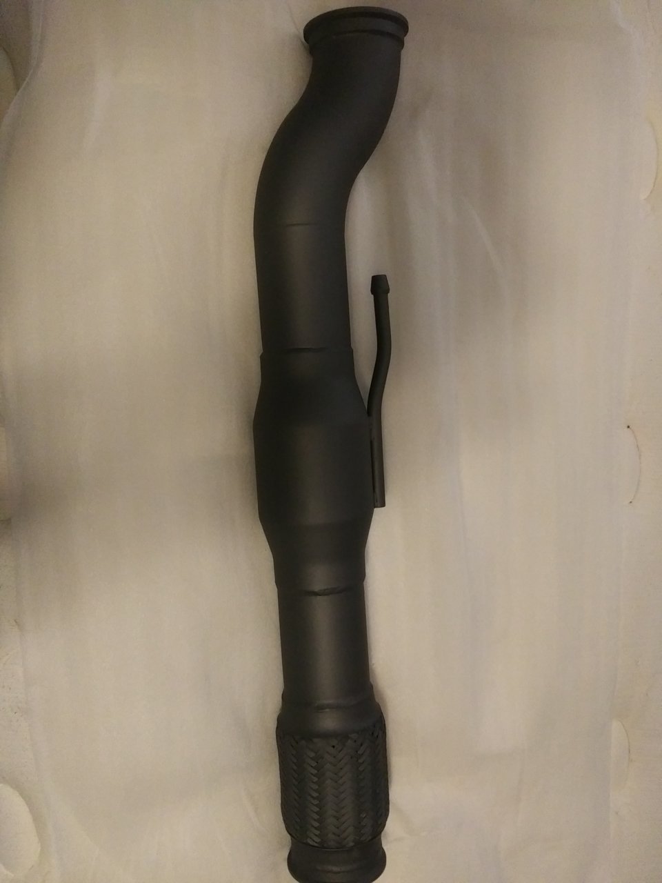

    That does look nice! meant to say do not do not.

    Do you know the measurements between the bungs on each side? I need to modify the JFR I picked up as its for a N/A not boosted. Does not look like I can send you a message.

    OP hasnt been here for ~6mos. I bought the final prototype of the JFR. Swing by.. measure the bungs and test fit the skid plate at the same time.

    ah yah that was more in response to @TacoTuesday1 but yah Imay have to drive down with mind and line it up. The last shop told me to draw where i wanted the bung so it was a bit of a guess at that point.
