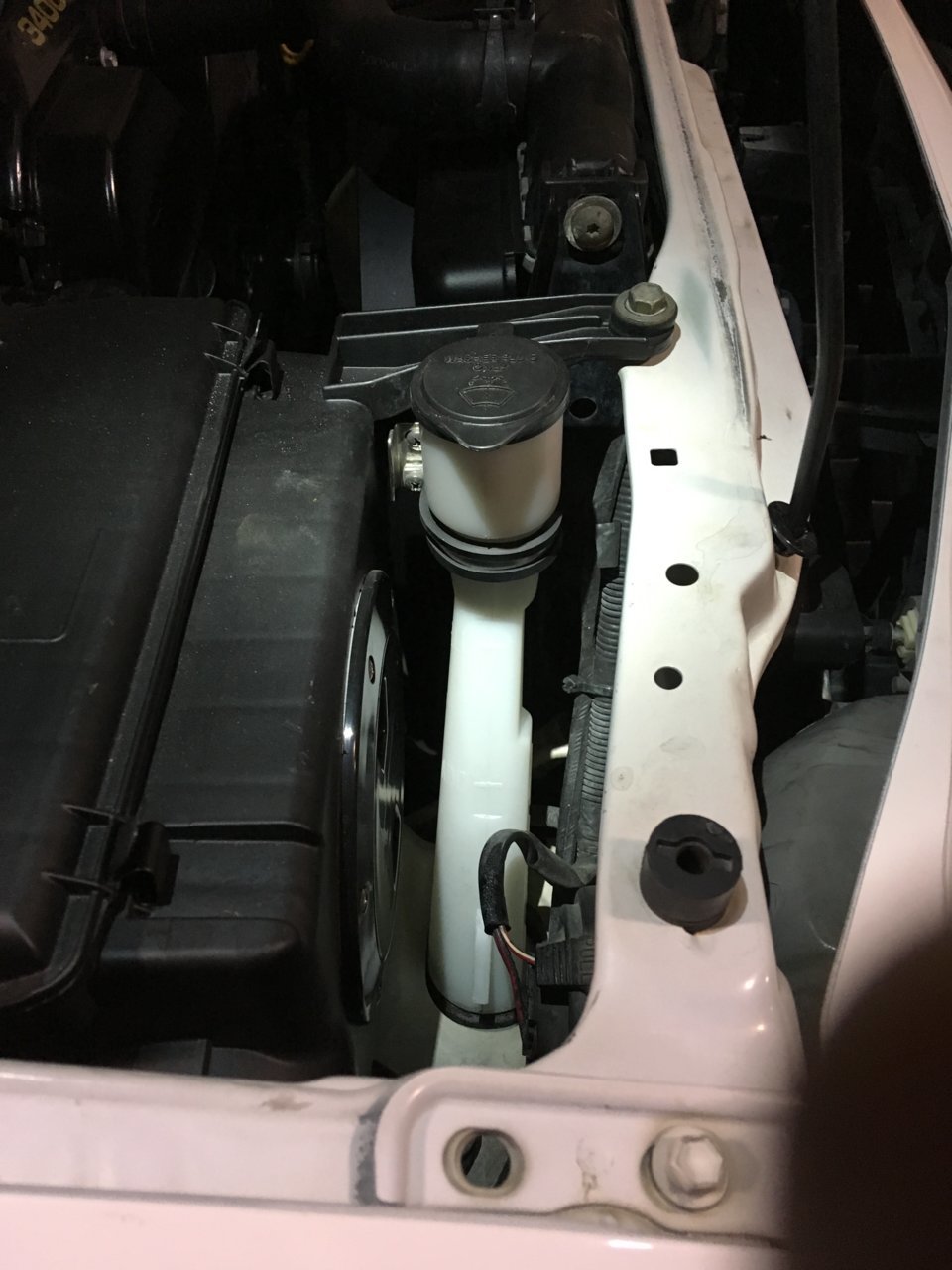

    I bought the washer tank that is similar to the op’s first post on eBay. Mine didn’t come with a washer pump, but I did wish I had gone ahead and bought the factory one. The filler neck doesn’t fit tight enough and you can move it around pretty easily. I ended up strapping the top of the filler neck to the air filter box bracket. The cap won’t fit over the factory drop in filter screen, and I had to reuse my old washer pump grommet, because the one it came with leaked. I got it to work, but if I had it to do again, I’d just buy the damn oem part.

    I just ordered the same one (but with the sensor hole) for $52. FWIW I am planning on swapping all the grommets and the pump from the old tank to the new. I am also probably going to seal the neck insert area with RTV. I don't trust it and the OEM design doesn't have the filler neck as a separate piece. But, who's to say the OEM one won't disentegrate again? Not worth the $110+ gamble IMO.

    I agree with you. That’s the same reason that I bought the one I did. I actually thought about fiberglassing my factory unit back together and reinforcing it. It’s too easy to spend the money. Haha! Good luck! In the end, I’m happy with my washer tank, it was just more work than I expected, that’s all.

    This is a picture of how I strapped it to the airbox frame. I used a metal clamp with a small spacer to drop it down to where it fits. I also used riv nuts and machine screws, so no nut to hold with a wrench if I wanna unhook it for services or whatever.925A6FC6-A50E-49ED-BFFF-8BF61D3F8997.jpg
