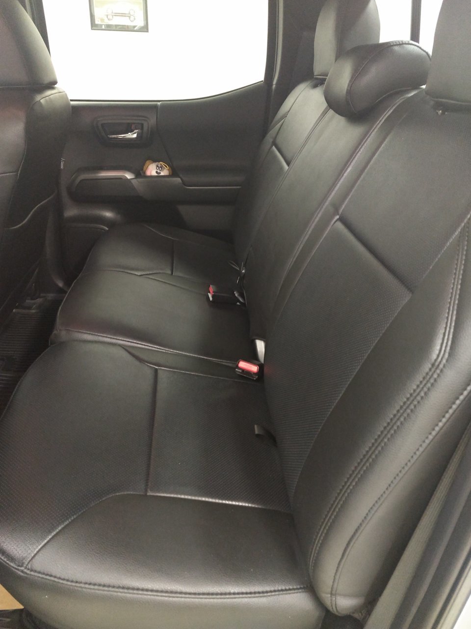

    I installed the Clazzios too with a kit off ebay, worked perfect and I too attached them to the bottom of the covers. Don't worry about it, the seats will be fine. I was worried too but not too concerned after talking to my friend who works for a local shop that is a famous TV car show. IMG_20190220_104258103.jpg IMG_20190219_215900261.jpg IMG_20190219_215912580.jpg

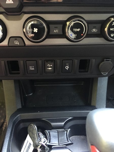

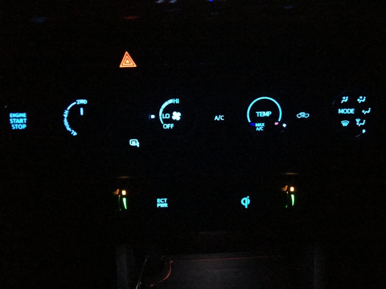

    I have an offroad with the technology package and this is where I put my clazzio switches
    TRDPro916 likes this.

    #275726
    431
    So how hard was it to mount the switches where you did? My switches came in and they are too big for the lower switch panel so they may have to go where yours are.
  20. Apr 11, 2019 at 2:36 PM
    #20
    Jamesr913
    Jamesr913 Well-Known Member
    Dec 26, 2018
    #277028
    160
    2019 Cement Tacoma offroad
    The hardest part was just getting them both lined up to be in the same spot. Other than that it was real easy. Just used a razor knife with a brand new blade and scored it repeatedly until it went through. Behind there is open space.
