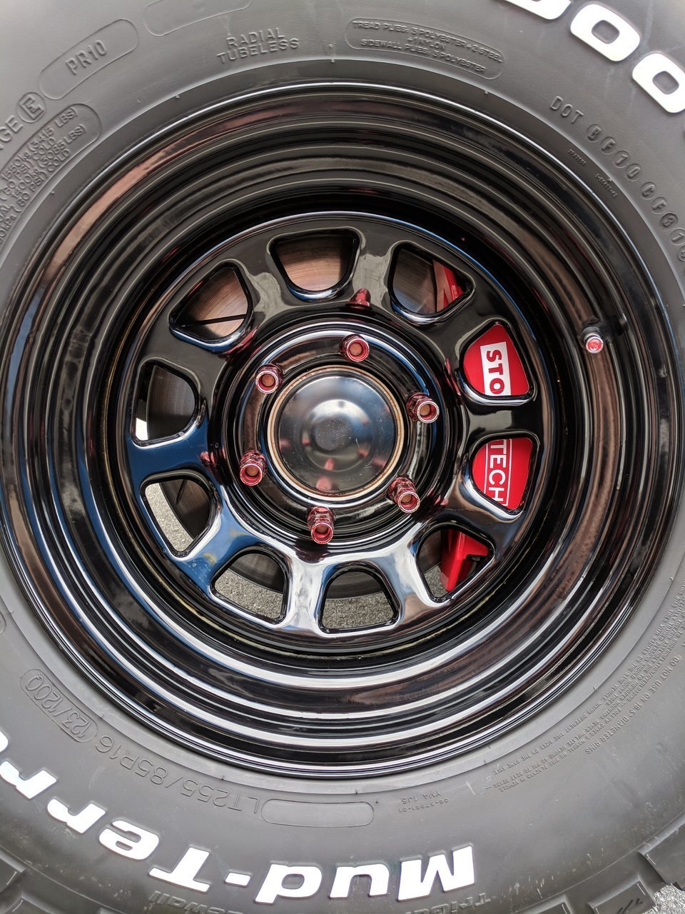

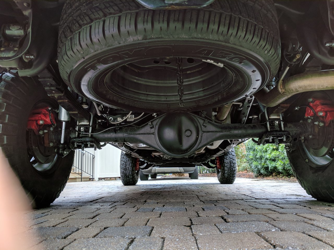

    Personally, I ended up going disc conversion/BBK upgrade in the end. I know stoptech also makes nice Cryo treated stock size rotors (PN 126.44129CSL & 126.44129CSR) as well and those will last a lot longer than non cryo treated ones and take a good bit more abuse from towing and stuff like that.

    gkomo and Biscuits like this.

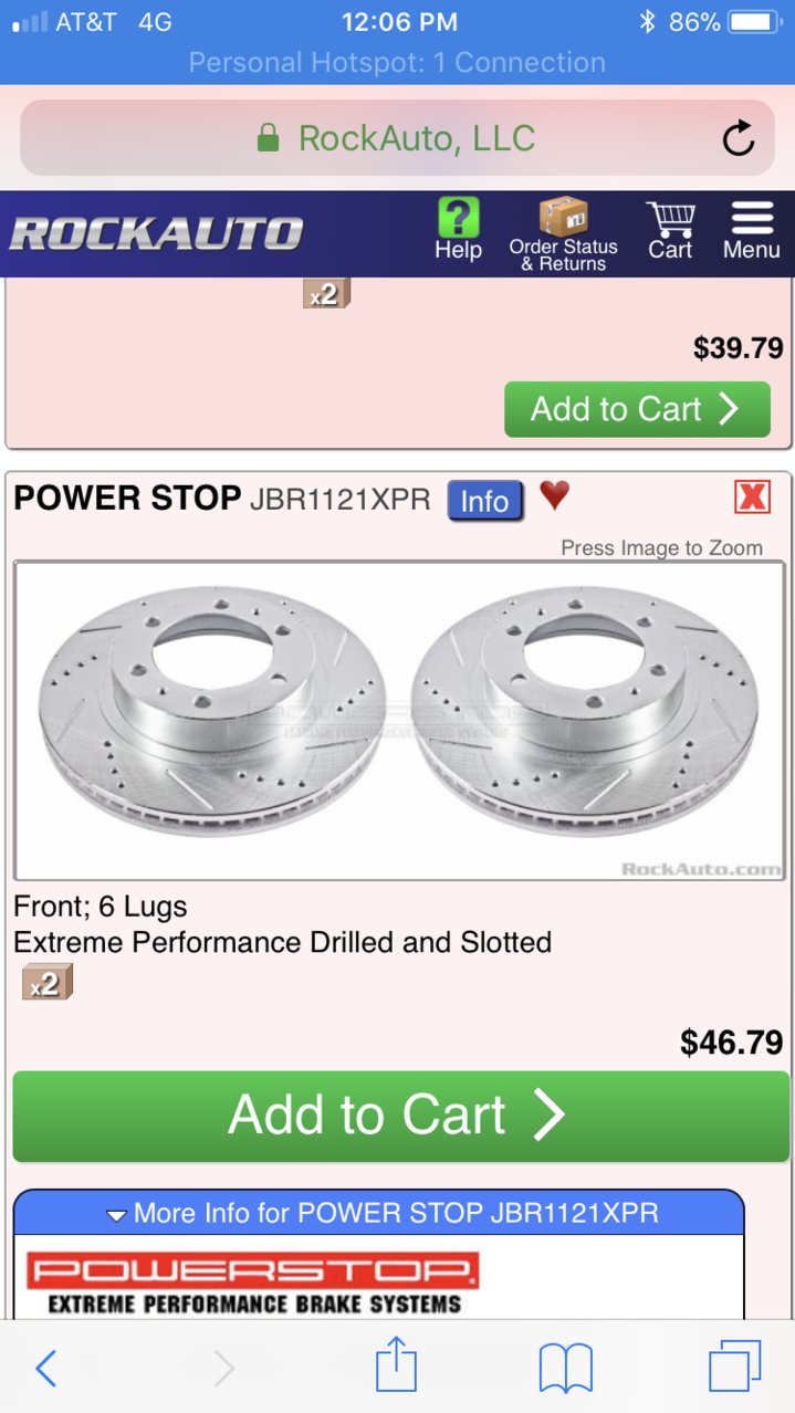

    EFDD3B3F-09BC-4985-9C30-7B829A8CB996.jpg These? I’m also about to order some new rotors and was curious if anyone had experience with them.

    Oops.....i went ahead and pulled the trigger on em. I tow maybe once a year but I drive 150 miles per day to and from work. We’ll see how they hold up on mostly highway commutes
