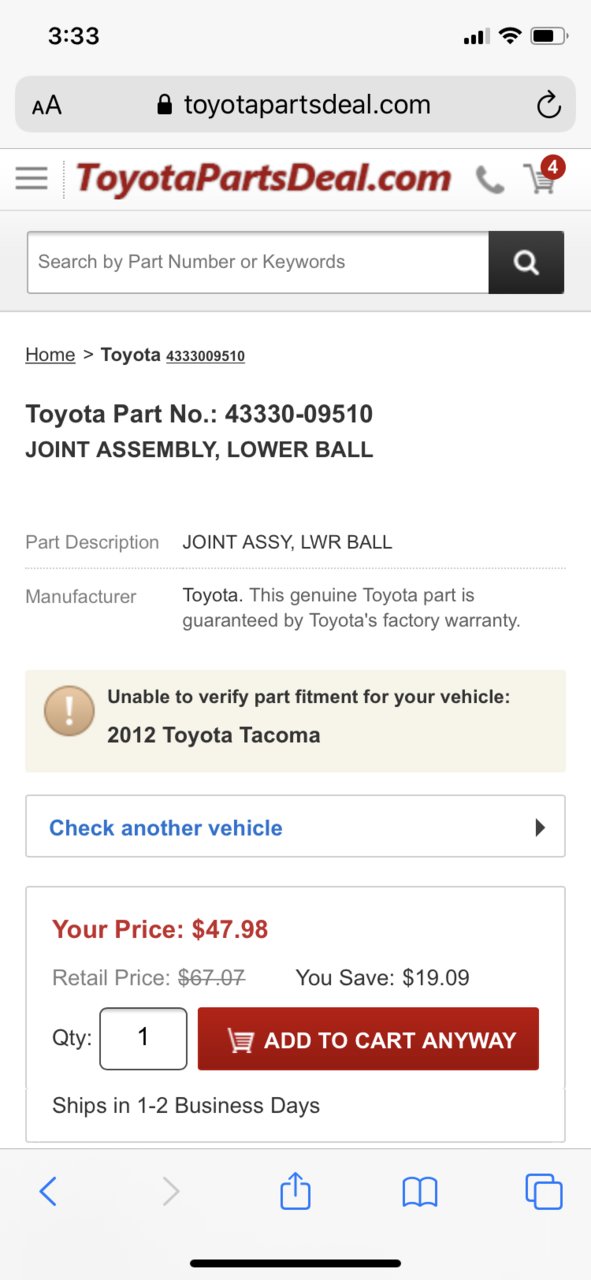

    Op, I do not know your skill set or tools you may have available but for quite awhile I have rebuilt a number of LCAs using OEM parts. The bushings can be had from a number of discounters like bochtoyotasouth, and others but the ball joints were a bit of a challenge since Toy goes to great lengths to make you buy the whole arm for big$$$ and hides info on the ball joints. And no they are not Moog or any other aftermarket variant, not even kinda sorta.
    The OEM ball joint is part number 43330-09510 but Toy has it locked out from sale in N. America. I've tried. Solution: get directly from Japan or the UAE. I have purchased many through Amayama.com an exporter in Japan and I just checked to see that there was no Japan availability but hundreds in the UAE starting around $44 ea. but shipping is costly so keep that in mind. For me having OEM parts is the preferred solution.

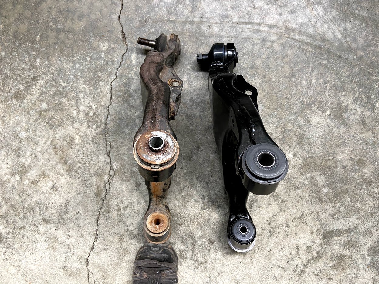

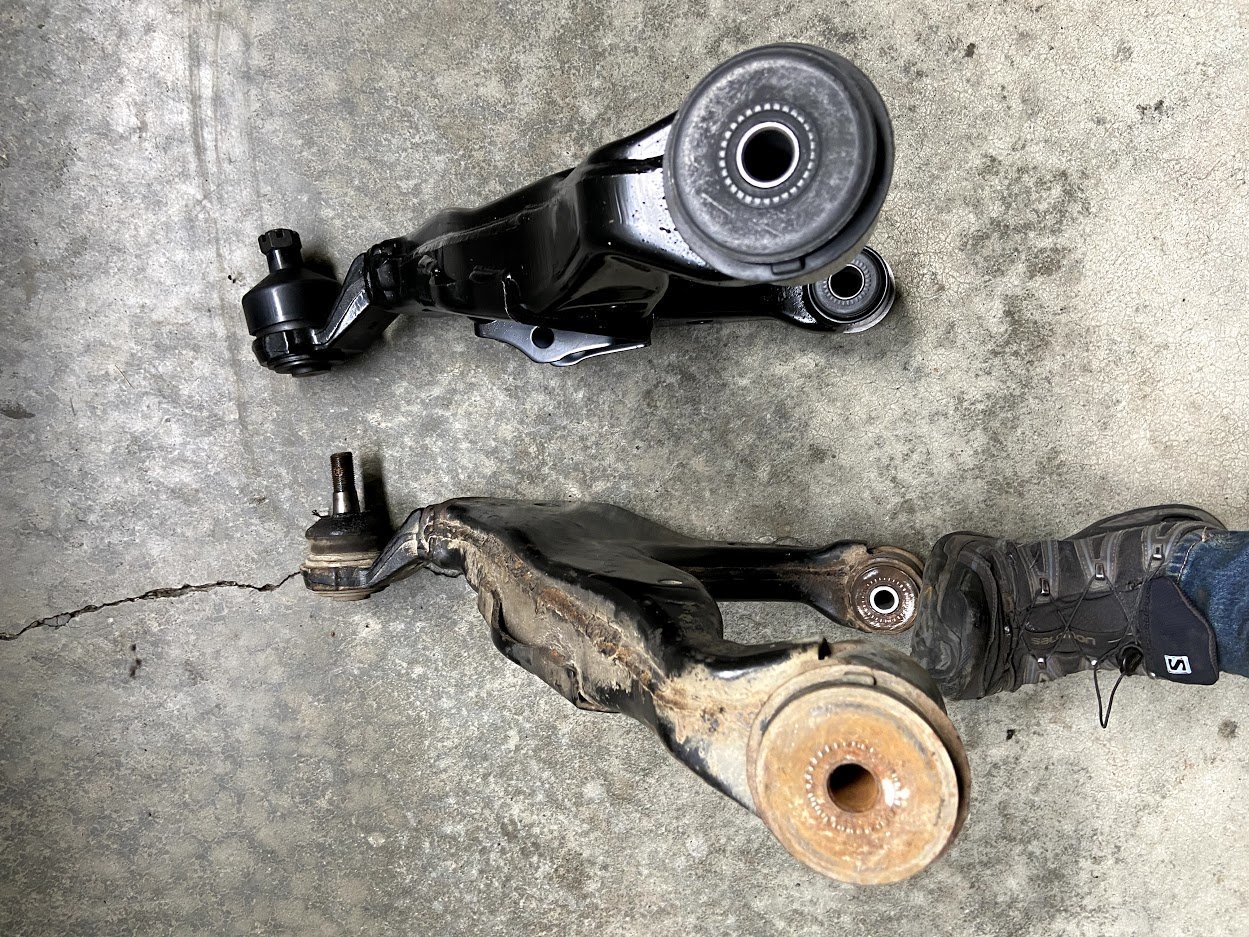

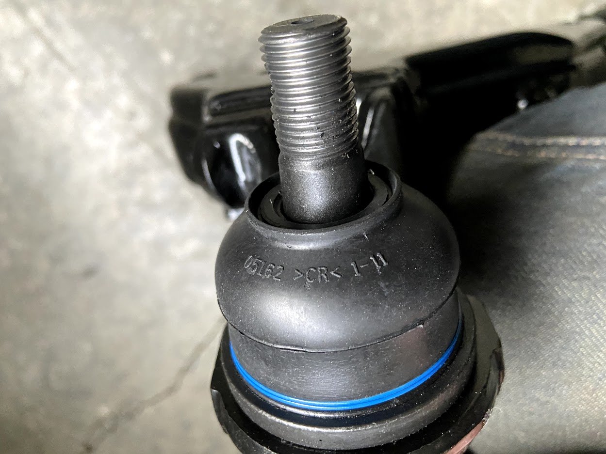

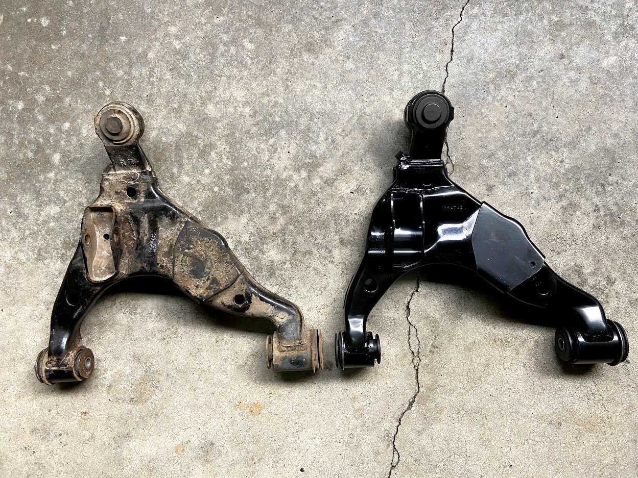

    I ended up buying BECK/ARNLEY lower control arms. part # 1026431 and 1026429
    Box says "Made in Taiwan" / Rock auto documents indicated country of origin as: Japan
    Will see how they last, but this is how right (passenger) side looks compared to OEM.

    P.S. Adjustment sleeve was seized on mine. Your's will probably be too. This is the part #: 48409-60020

  19. May 24, 2020 at 7:05 AM
    #39
    Aardvark13
    Aardvark13 Sultan of Squeeze, Wizzard of Slide
    Mar 23, 2018
    #248164
    1,275
    Byl
    Knoxville
    2014 DCSB OR
    Aardvark4x4 Built for Go
    Looks good. I went BECK/ARNLEY on my front drivers wheel bearing hub assembly on my FJ, seemed high quality.
