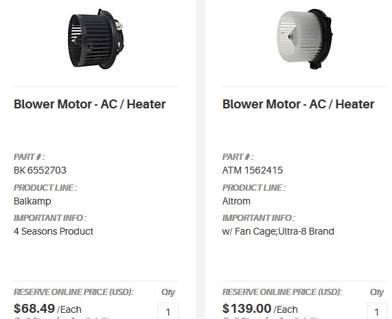

    Jon, do you remember the model #, etc. I only see two listed on Napa's website. One is around $60 and the other is $130 which is more than the oem one.
    Thanks for your help.

    I paid around $60

    In case someone is looking for the model numbers from NAPA.

    Bringing a thread back from the dead. I installed the NAPA blower today (BK 6552703) $63 with online discount. Metal body, made in Canada, feels quality. Installed without problems. Blows more air than the original but the original was 14 years old. I'm happy with it and I'll see if this one lasts 14 years.
    I could have saved a little money with the eBay or Amazon blowers. They look more OEM but 1. I wanted to finish this today and 2. I have had generally good luck with NAPA products.

    Link to the part?
    https://www.napaonline.com/en/p/BK_6552703
    Never mind lol

    Yep. That is it. It does look a little different but the fit was perfect. Just remember to look in the box for a plastic air vent. I installed mine and was about to throw out the box when I noticed a plastic "L" shaped piece. I really thought that it was for looks but it helps direct air across the motor.
