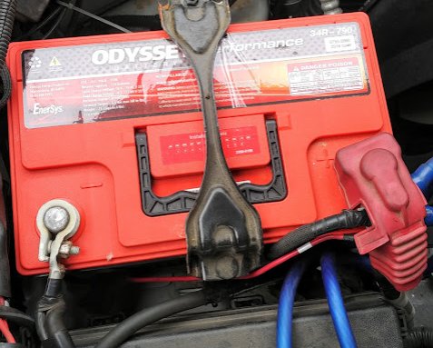

  9. Mar 24, 2022 at 1:52 PM
    su.b.rat
    su.b.rat broken truck
    Jul 30, 2016
    #193316
    9,869
    Odyssey 34R-790
    stock fit, big improvement over stock in every way.
    shakerhood likes this.
