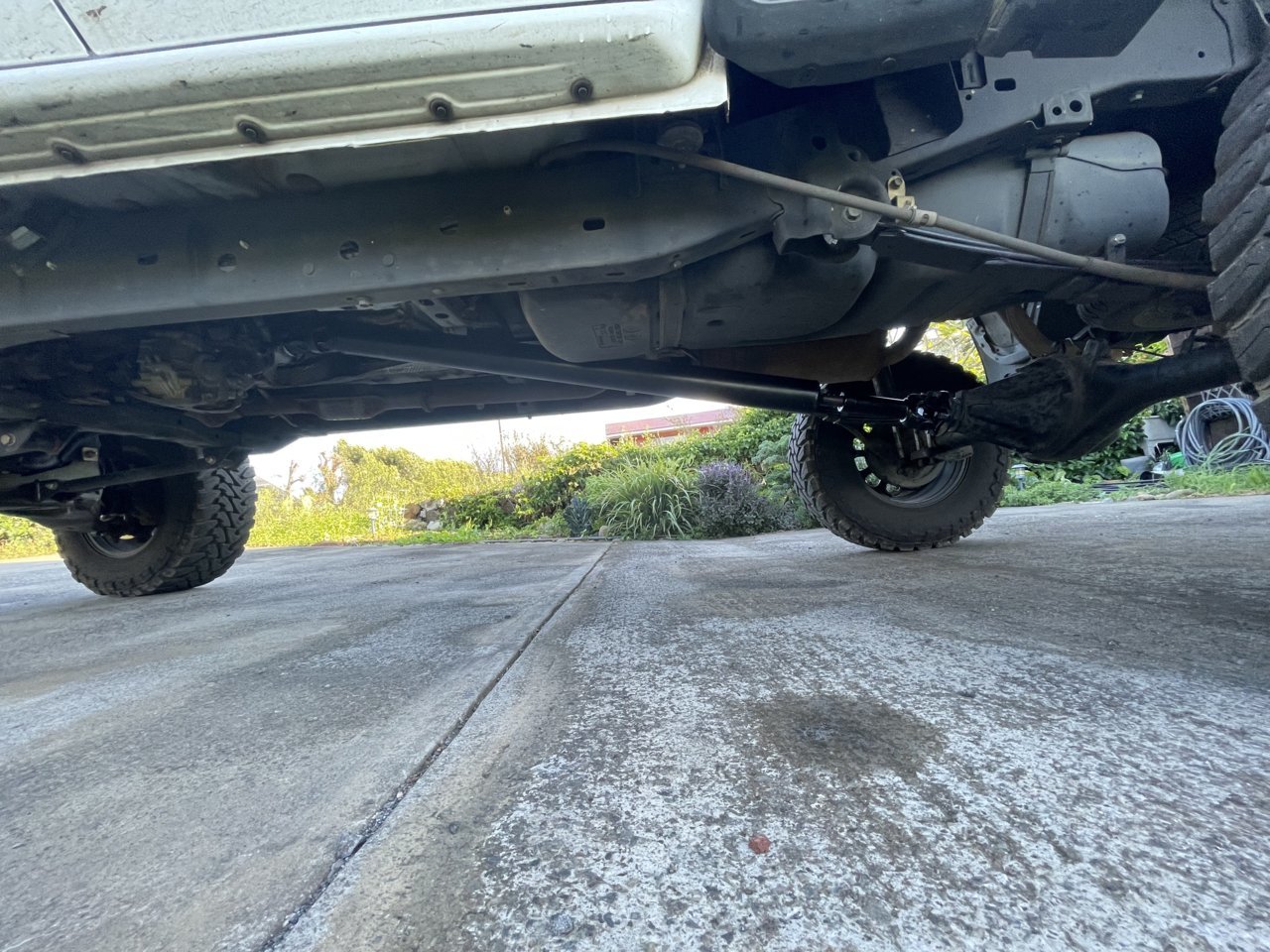

    It’s the two piece drive shaft that’s is shuddering when you accelerate. The center support bearing is probably worn out a little. I just replaced my whole driveshaft with a Tom woods 1 piece. Best decision I’ve done. Completely eliminated all vibrations and shudders have been eliminated.

    Ya closer to $800 I think. But I’m in Hawaii and everything is more expensive out here. It’s worth every penny. The truck is really smooth and very responsive. 58049FF3-D0F7-474F-87D8-9907EB944E5D.jpg7B63F014-273E-4B01-B6C9-7401257845FB.jpg
