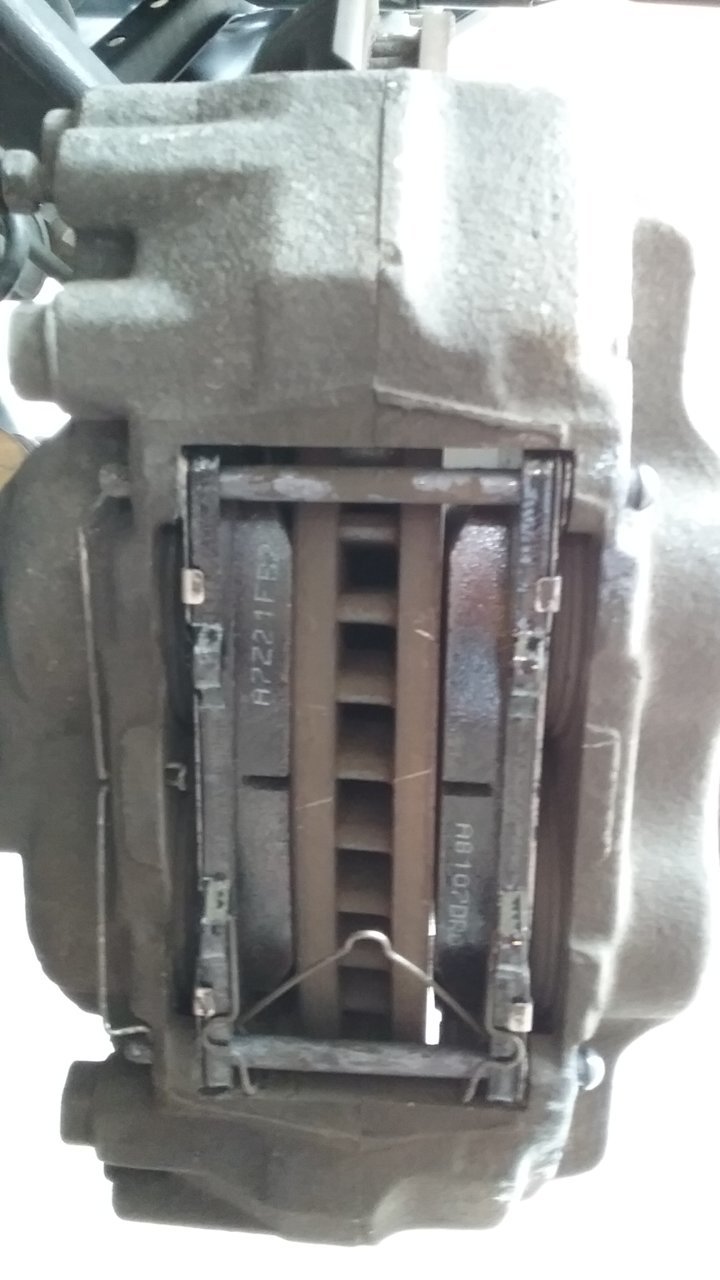

    Tundra shown. Tacoma is the same except it has 6 lugs:
    Just put a screwdriver or pry bar between the pad and rotor to push the pistons back. Damage to the ABS module is unlikely (Eric at South Main Auto hasn't seen it after 1000+ brake jobs). However, if you're concerned, make your own bleeder bottle, crack open the bleeder, then push the pistons back. That way, the fluid displaced by the pistons will go into the bleeder bottle rather than up into the ABS module.
