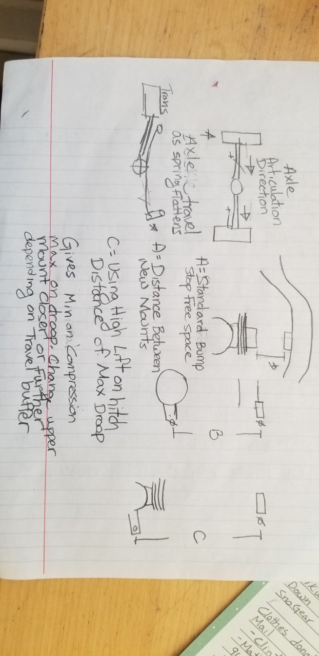

    With the small amount of travel we're talking here, and without adjustment to spring rate or damping, any valving will be a compromise of some sort. Make it plush for the street, it will blow through on big hits. Make it firm for big hits and it will be terrible on everything else. Sit it in the middle and it will be just decent for each end of the spectrum, which is where most people end up. I go on trips with linked/LT guys so I end up pushing my truck hard to have fun/keep up, so I'm a little more to the aggressive side of things. I've tried a few shocks and a few tunes with AccuTune since I'm buddies with them and they want to use my truck for a bit of R&D, and it seems to get better each time. Currently, I'm on their DD tune, which is pretty soft and plush over everything, but when I load it for a trip and/or head for the rough stuff, I can crank my DSCs and notice a difference. I did personally like my last tune slightly better, because the DSCs only have so much range, and because I have almost nothing for valving in the rear 2.5s (to make it this plush, plus DSC adjusters offer some damping vs a shock with no DSC just by design). If I really want to go fast, I can still blow through the travel pretty easily with the DSCs closed. On the last tune, they were getting too many complaints of a rough everyday ride (I thought it was just fine), so they developed this one to better cover the customer base. I liked the last one better loaded and/or at speed because it had a little more of a baseline to build on, so it was better all around for me, compromising for a slightly firmer DD ride. Even with these, I left them closed by accident as we left San Felipe on our last trip and I made it about 15 minutes on the highway before pulling over to open them up again, it was just too firm.
    Do you have front plans (or already done?), because having a good balance front-rear makes a huge difference as well. If your front isn't doing it's part, it will make the rear work harder. I've heard good things about the ADS stuff.

    This has likely been covered already- but I can't be bothered to read all 1800+ posts... ;)
    Make sure you measure the full droop, too- not just the point at which the freehanging axle comes to rest. Likewise, compression (of course with the standard expected loadout in the bed, and a forklift to do the compression, that should take care of itself)

    Interesting. Will see how it goes. I'm sure I'll be happier than I was previously, regardless! And yep, front write-up coming as well.
    Stay tuned :) :thumbsup:

    Another piece to this puzzle though is that I very the load in my bed by a lot, compared to you. You seem to use the truck for trips only, or with a very similar amount of load, so your valving won't need to change much to "cover the spread" if you will. I think you should be able to get to a good spot pretty easily.
    Looking forward to the front write up!

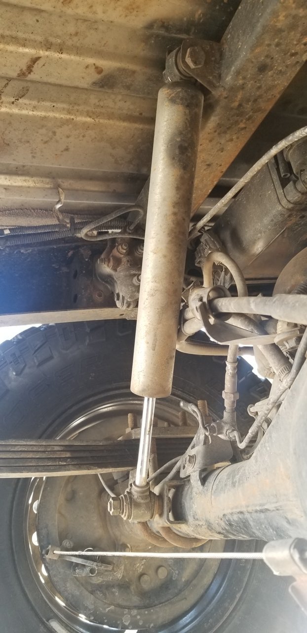

    With plenty of light, and knowing that rain was on the way, it was a good time to evaluate the shock situation. I laid out the Trasharoo under the back of the truck and scooted my way under. Yep, there was definitely a problem.
    I still didn't know why - I mean, we'd measured more than twice and (I thought) done everything right - but we quite clearly hadn't allowed for enough up-travel and the shocks were close to hitting their rubber bumps and bottoming out - even at rest - when the truck was loaded up.
    There were two options - abort the trip and head home on the highway, or remove the shocks and run the Mojave Road with leaf springs only. The answer - to me - was obvious: adventure was waiting.

    Boy, was I glad I stopped. The passenger rear was stuffed way up into the wheel well and it was clear by looking at this situation that the amount of uptravel I needed on the rear axle was way more than I'd thought when we tried lifting the rear axle with a floor jack. The axle had moved a good 3" further up and the bump stop was touching the frame rail. The leaf springs themselves looked OK too - slightly inverted, but not too shabby.
    I'd need to make sure, when I re-worked the mounts, that I could get at least to this point with the rear. I hoped I had enough room to move the upper mounts to accomplish that, but I was pretty sure I didn't. Oh well - now wasn't the time to worry about that - and we continued down the moguls to the bottom of Watson Wash and up the wash to Rock Spring.

    @Speedytech7 a forklift, and breaking down the leaf pack is a little over thinking it man. A high lift or floor jack and tape measure are all you really need. Since im not good with words I hope this picture makes sense, even though you all ready figured it out maybe it will help someone else.
    You can see how my mounts are pivoted 90 degrees from each other. I did this to decrease bushing wear and binding of the shocks. Max comp and droop I have 1in of travel left doing it this way.

    Very true, which is why when you combine a flutter stack with DSC adjusters it lets you cover an even wider spread of situations.
