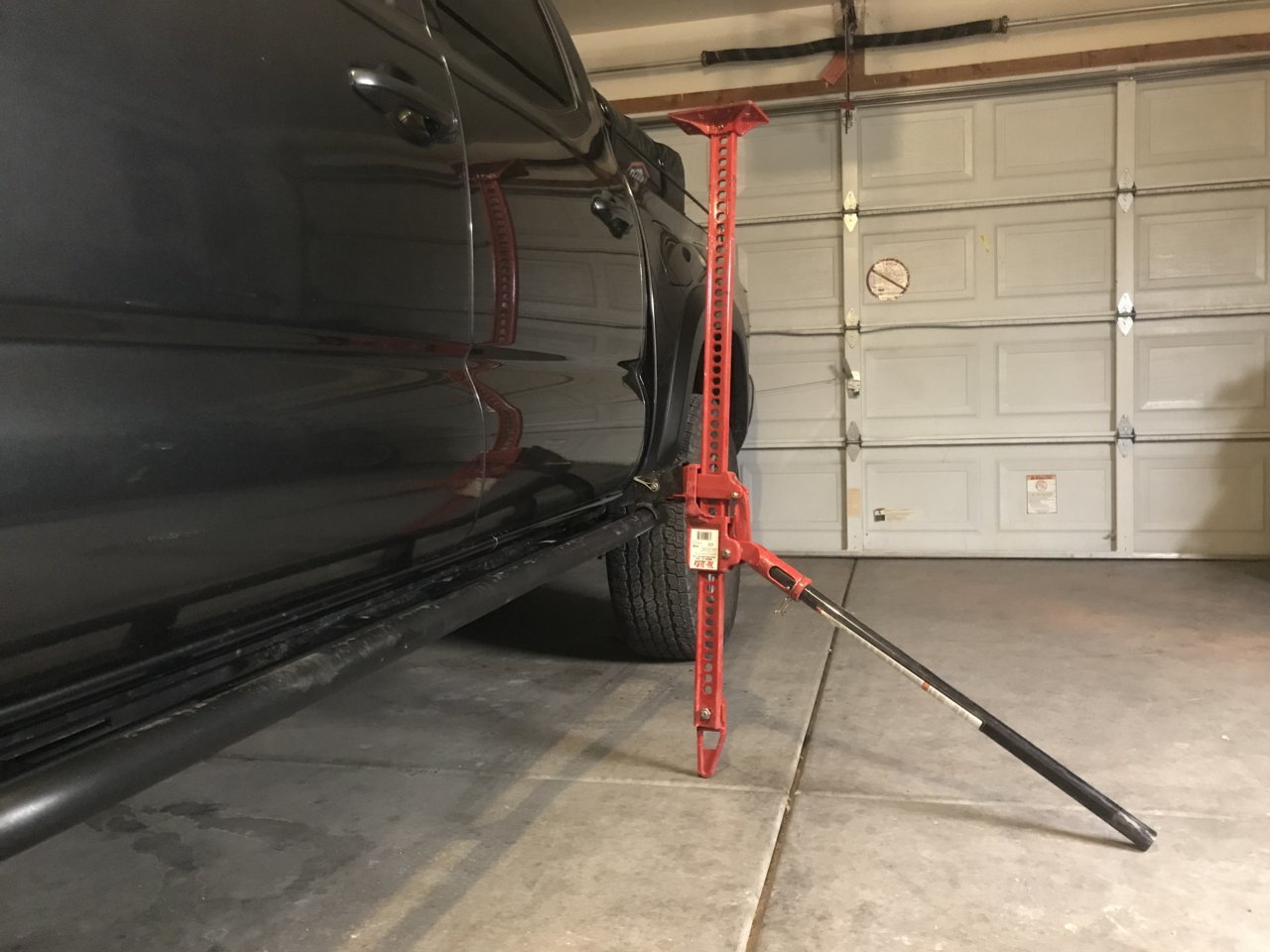

    Am I doing it right???

    LOL, couldn't resist. Isn't that what first gen-ers are supposed to say at this point in the Tacoma cycles? I mean, you know that once they have flying Tacoma's, we'll all be like - "dam, those 8th-gens suck."
    That's how I use mine, so you must be doing it right. :fistbump:
    (hahahahaha! love that you went out and took that photo. freakin awesome.)
