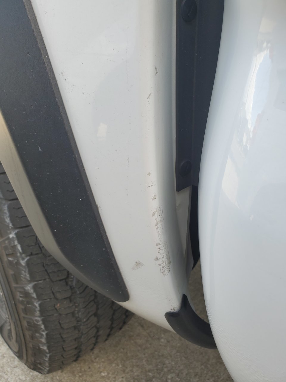

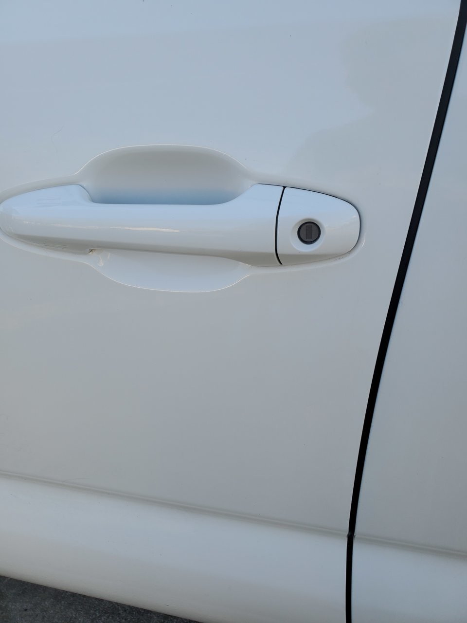

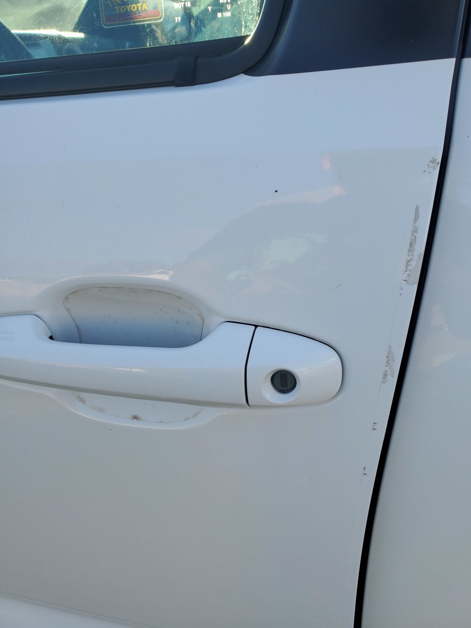

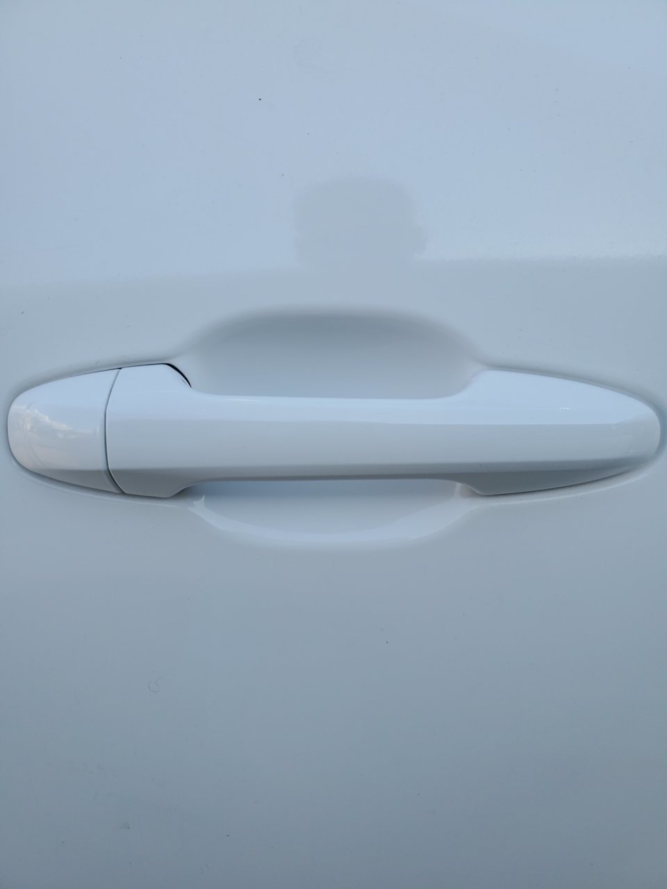

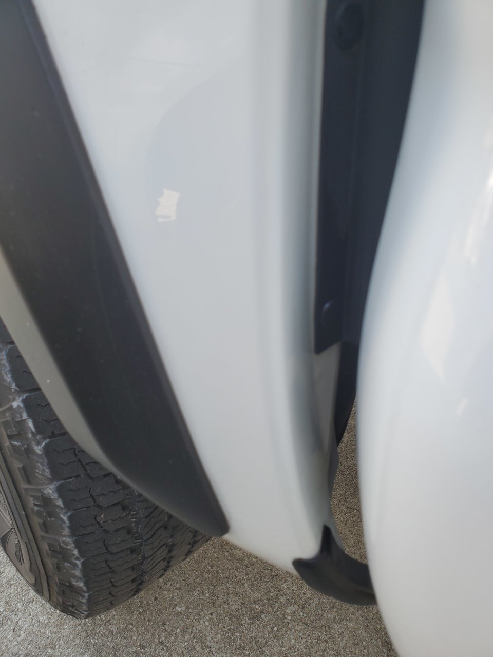

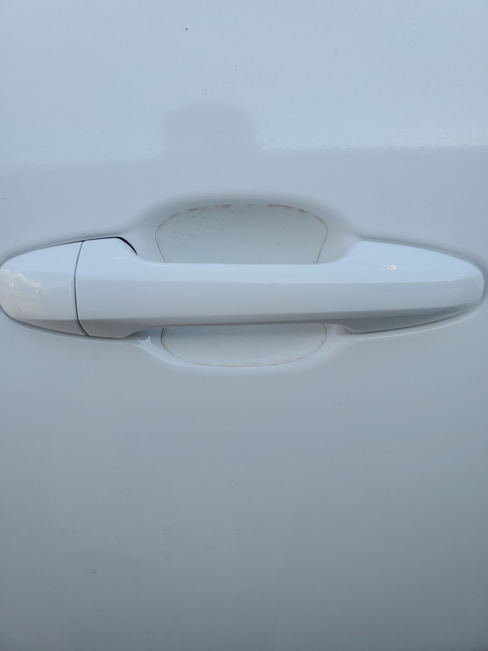

    I had sticky residue from plastic adhesive protective films along the door, the side view mirrors, and the front bottom corners of the bed that were getting dirty and looked really bad. I tried goo gone but even letting it soak for 5+ minutes resulted in nothing.
    I read online and some folks suggested the Turtle Wax Label & Sticker Remover so I gave it a shot. This stuff was a miracle worker. Old and new residue just wiped right off after spraying it on and letting it soak for 30 seconds to a minute, almost no elbow grease required.
    I wish I'd known how well this stuff worked when I replaced the TRD OR bed side sticker when I first got the truck. I absolutely recommend this product and will use it any other time I have any type of sticky residue on my vehicle.

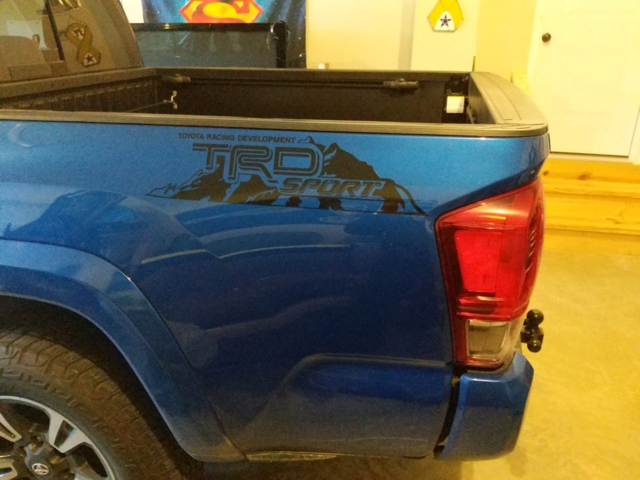

    Had a custom sticker made, and couldn't put it on, because I couldn't get the adhesive res off. Went and got a can of the Turtle Wax you recommended, and it came off like butter...literally. Thank you, now my taco has a new look.

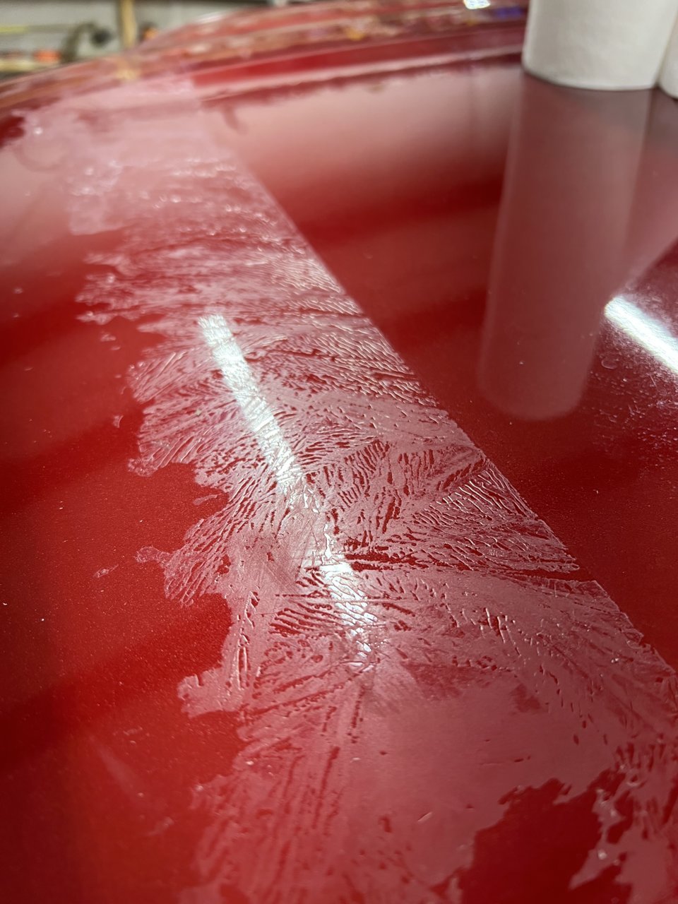

    I had taken the clear paint protection film off the hood of the truck and it left a very sticky glue residue on the hood. Nothing touched it. We tried mineral spirits, brake parts cleaner, alcohol, 3M general adhesive remover, turtlewax, everything; yet nothing came close to touching it. I went by a graphics shop and they put me on “Rapid remover” and that stuff works!!! Using that along with a plastic squeegee and it came right off. This is commercial grade stuff and not the dilute store bought stuff. This is the stuff to use for stubborn glue residue. I’ll post before and after pictures.651D7220-CC9C-403E-8EAD-219DCC0EF895.jpg7431679F-80FF-497F-9AC0-4604D943926D.jpg
