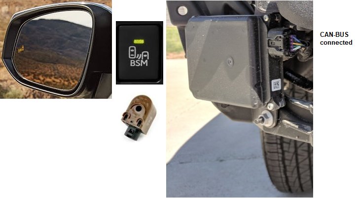

    There are sensors in the rear quarter/bumper that you'd need to make it work, and from what I hear, they're pricey. No idea on whether your computer is programmed for it either, but you'd need that too.
    If you're lucky, sometimes you see the sensors on this board from a member that took them off for a steel bumper install.

    I would not be surprised if it is pre-wired for it. You would need mirrors, sensors and the button at absolute minimum. Hopefully someone else can confirm this. I honestly would not waste my money on it. I don't find the blind spots all that bad on these trucks (Even with the topper). I honestly find that once you get used to the truck it is just another thing that blends in and you forget about it. I don't like nanny features to begin with so my opinion is slightly jaded.

    No sensor hidden and unwired (way expensive)
