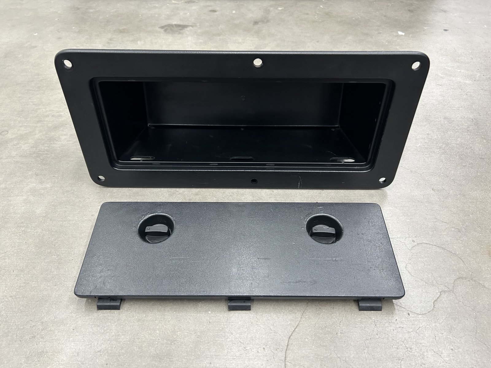

    Toyota removed the driver side bed storage cubby on 2019+ models. Nobody really knows why, but 2018 was the last model year that had the glorious extra storage cubby in the bed. Makes no sense other than cost savings, because nothing changed structurally that would prevent them from keeping it in the same spot.
    So I decided to add it back!
    These are the 2 main components:
    Storage Box - Toyota (64742-04010)
    Truck Bed Storage Box Lid (Left, Right) - Toyota (64074-04011)
    They're pretty expensive brand new, but I was able to find a set on eBay in great condition for $150. You can definitely find them on the used market, or search your local junkyard for a score.

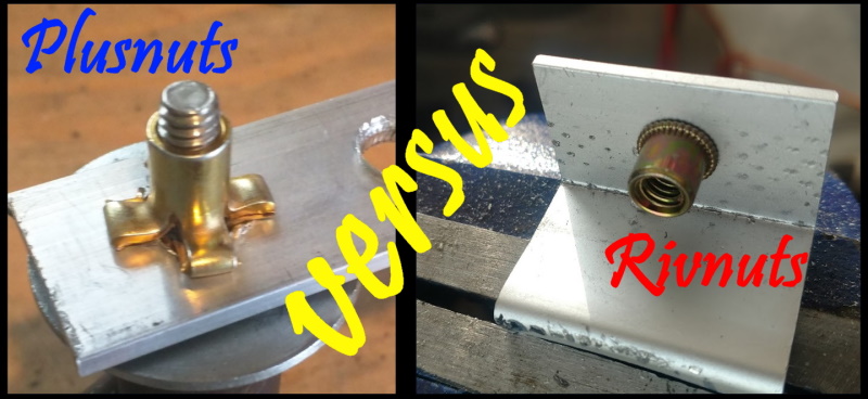

    In terms of installing the plus nuts, you can use a riv-nut tool (like this), but I didn't have one or want to buy one. You can make your own DIY version using just a bolt, coupling nut, and a couple washers. I'm not going to go into detail on how to do this, because there are plenty of tutorials online and also plenty different ways to do it, but the way I installed them was using the first method shown in this video from the 1:10-3:30 minute mark (assembling) and 4:55-6:07 minute mark (installing).
    I can't stress this enough but if you are new to installing these types of fasteners like I was, do as many practice pieces as you need to in order to feel 100% comfortable (just make sure you have 6 left for the actual install). You don't want to mess this up while in the bedside and risk having to cut it out.
    Two reasons I went with "plus-nuts" instead of normal riv-nuts:
    1. When plus-nuts compress, there are 4 large "wings" that fold down and compress against the backside. You can see these in the photo above. In contrast, when a riv-nut compresses, you only get a thin "ring". See this pic for reference. I felt that the larger wings of the plus-nut would provide a larger surface area and thus be more secure.
    2. The thickness of the composite bed (measured from the above offcut) is 0.13". This is significantly thicker than your average sheet metal that riv-nuts are more commonly used for. This is called the "grip range" so make sure that whatever plus-nut/riv-nut/jack-nut you use can accommodate 0.13" thick material.

    Great write up. I have pre 2019 with the box and note it is NOT even close to being watertight. I have tried to get it dry for strap storage. So spending +$300 for a wet box you could put a waterproof box in the bed

    You are correct it is not weatherproof, just like the small one on the passenger side. There are some solutions (see Mike's Cubby Caps), however, it's not that important to me. I keep rachet straps inside a Ziploc bag in there so it works for me. I spent about ~$170 all in and I enjoyed the DIY project.
