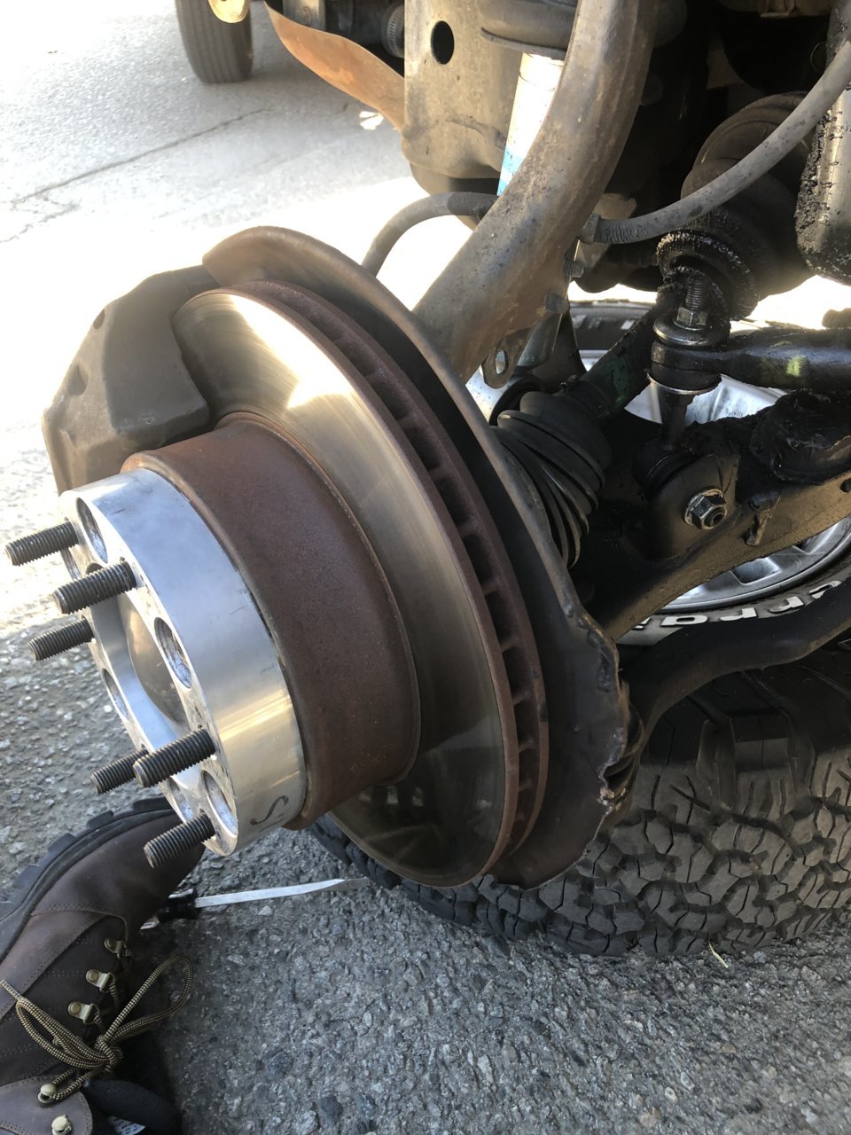

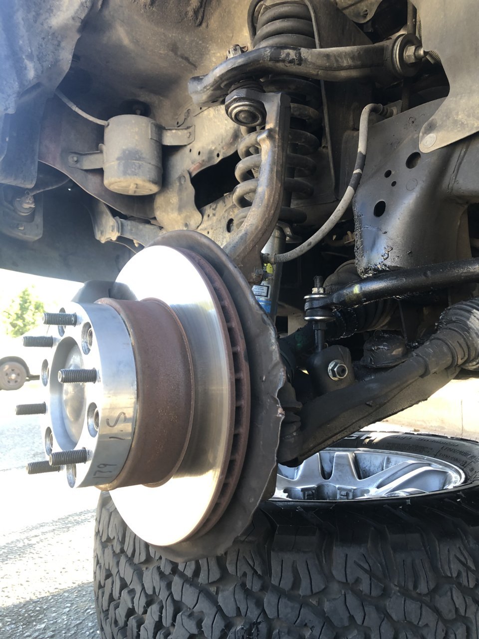

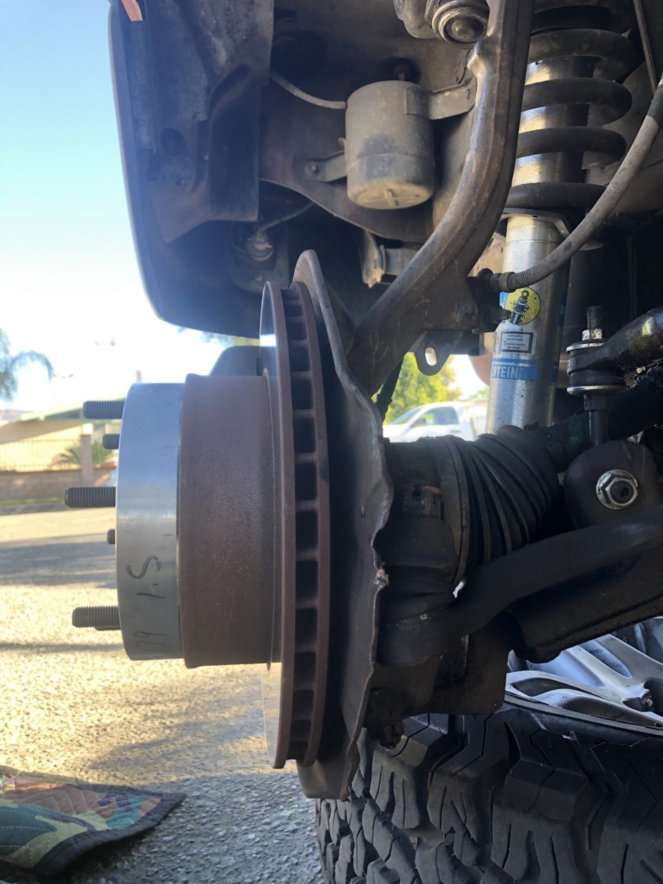

    So I threw on these wheel spacers to fit my Goodrich on the truck since the Bilstein lift caused my OEM UCA to perch down a bit more.
    Now after driving it I definitely can tell I’ll need a balance/alignment but I’m also feeling this odd kinda tick in my steering wheel that felt like it was coming from the left (only when I would hit bumps or get a shake at 70mph.)
    Lifted the truck up and yanked on the wheel while it was still bolted on - had a little play.
    After removing it I see this dirt shield all chewed up so I hammered her back a bit.
    Maybe that’s the problem?
    Really don’t want a wheel flying off on me on the freeway
    Wheel spacer lug nuts held their torque for 300 miles now so that’s good I think??C6EBC37E-973F-436B-A2D6-9F76253EAB16.jpgBB94EEFD-641E-4FFF-9A09-D63CB9513F6C.jpg1BE81419-E226-456B-B674-C6189390D801.jpg

    Possible issue: you're using non hub centric wheel spacer on a hub centric wheel?

    This is true. Don't know if this is the issue but those spacers and shank lugs don't go together.

    Spacers exagerate problems, if the tires are the issue, its worsened by the spacer.
    Could be a ball joint or tie rod, I'd get someone to look at it.

    You might have a few issue to began with. Yes, lug centric spacer (what you have) will fit on hub centric setup regardless. Tundra wheel are hub centric by designed from Toyota, just like the Tacoma wheel, which the weight is assisted by the hub. You're using lug centric spacer, now the weight is assisted by the stud instead of the bore to match hub. This can result in play between the lug centric spacer and hub centric wheel.
    Also, tundra wheel uses mag seat lug nut, not acorn/ball seat lug nut. If you're using acorn/ball, you won't be able to torque and center the wheel on.

    So they're second hand spacer? I thought you bought them from 4wp? Was going to say, take them back and exchange them for hub centric. I never tried mag lug on mag designed wheel on lug centric spacer, that might be your issue? Under load, there's nothing to help distribute the weight.
    Another possible issue, the spacer is worn from where the stud is seated. Under load and stress, they wobble.

    Gotta stop listening to people at part stores, you want/need the hub-centric spacers.
    I wouldn't even run those on my truck with those wheels (I have the same tundra split spokes).
    First, the hub centric spacer will locate the hub to spacer right, then it has another lip to locate the spacer to wheel right.
    Right now you are in a everything is lined up by the lug nuts situation, and unless you have that magic touch things will vibrate.
    The factory lug nuts and the factory wheels aren't designed for lug-centric centering even if you get new lug nuts, the hole in the wheel isn't designed for that.
    Here is an example picture of broken lugs and what happens when you stick an acorn/cone shaped lug centric nut in a hub centric wheel or hub (a flat hole that is not acorn/cone shaped), basically it makes contact only at the edge, wears it out into a cone over time and then it falls off cause it loosens up.
