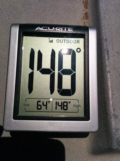

    This project has been fast-tracked and is my highest priority for the truck right now. Going to source parts and
    acquire tools as necessary.
    Measured from the roof of the truck shell, ambient temp is 90F. Direct sun all day.
