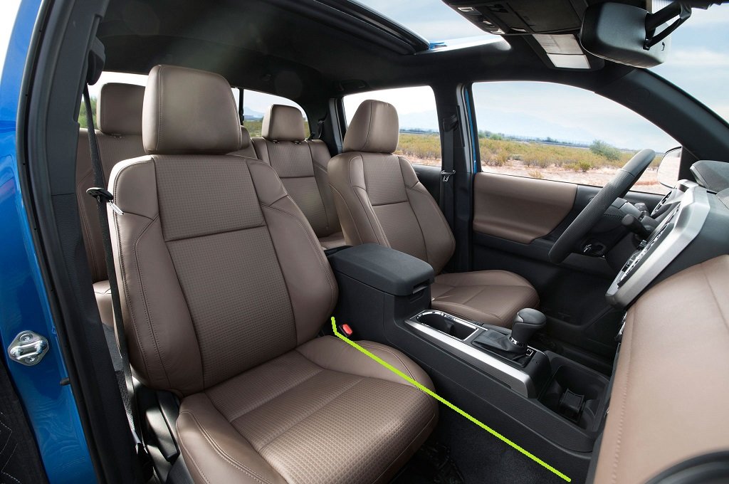

    For my mobius dash cam mounted on the gopro mount, I run a mini usb cable from the headliner to the pillar (remove the pillar plastic cover to run the cable behind it) and drop the cable down to the right of the glove box, from there I run the cable under the underside of the dash by the passengers feet held by zip ties, along the right side of the center console just stuffed in the plastic/fabric gap, then into the center console arm rest. There are 2 bolts in the arm rest you and remove to pull the rear up a bit, make a couple small cuts to make one of the holes a little bigger to fit the USB through and then plug into the adapter there.
    Running the camera and the radar along with the mirror dimming/gps link I think you would blow a fuse all the time.

    This is how I ran the wires
    The hardest part was dropping the wire from the pillar to the bottom of the glove box, was a tight space.

    Use small zip ties and when you run the cable behind the pillar, zip tie the USB cable to the existing cables being held in by clips, dont zip tie it to the airbag though and dont unplug any connectors.
    There is a black plastic clip in attached to the pillar cover you have to turn a specific way in order to get it released (from what I remember... Or this could be on the camry, I did this same setup to my GFs Camry at the same time)
    So if you take it off and you dont see this black clip, it was on the camry
    I used a 15ft cable and had roughly 2 1/2 feet extra I had to coil and zip tie tight under the glove box.
