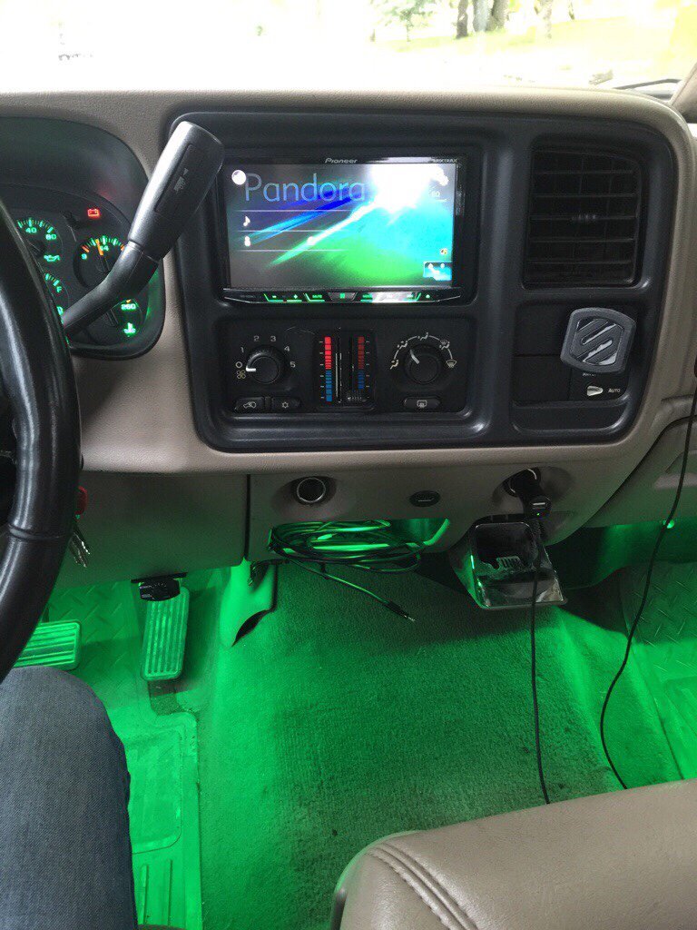

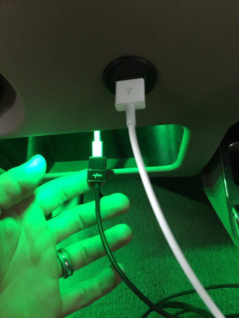

    Got at a local audio shop... Easy install for usb1 out of my pioneer nex
    And this is hdmi/usb2 with the only lightning female to male plug that transfers video on the market... Cable jive

    I got this on Amazon. Works great.
