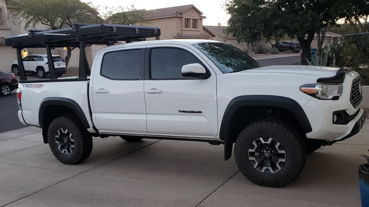

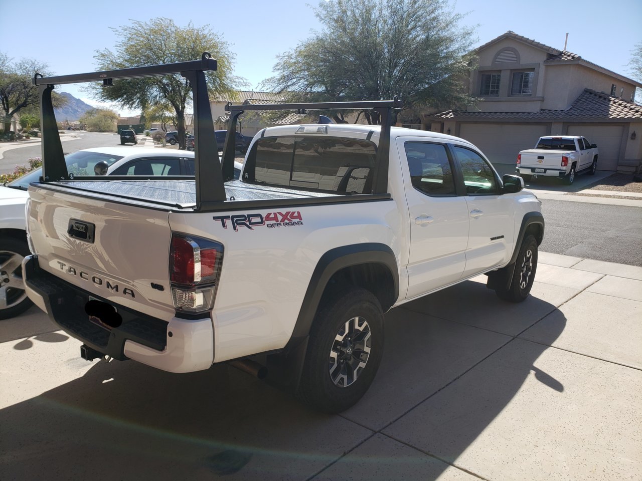

    The installation was pretty straightforward, and the rack feels solid. I was worried about having to trim the Gator FX cover, but there is plenty of space. 20210214_151347.jpg

    Looks good. It looks like the rack channel hangs out over the side a bit at the back but not in the front. Do you see any problem with that in terms of appearance or function?

    The rails are parallel so no issues functionally. The appearance doesn't bother me at all, and I love that the rack is barely visible in the mirrors and doesn't block the brake light. You could probably mount it closer to the tonneau cover to avoid the overhang, but I stuck to the provided template to be safe.

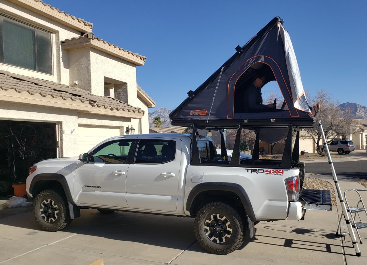

    Added a third crossbar and tent, happy with the result! 20210227_231317.jpg 20210227_231419.jpg

    Looks great. Thanks for the update. I definitely think I will go with the Adarac.
