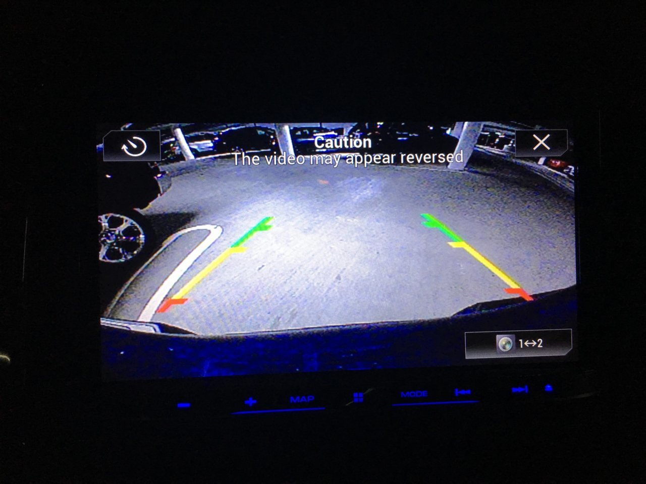

    I replaced the factory backup camera with the camera-source 12v drop in camera. It required running a new harness to the tailgate from behind the head unit, but it made integrating the backup camera behind the dash 10x easier since space is very limited & has a better picture.

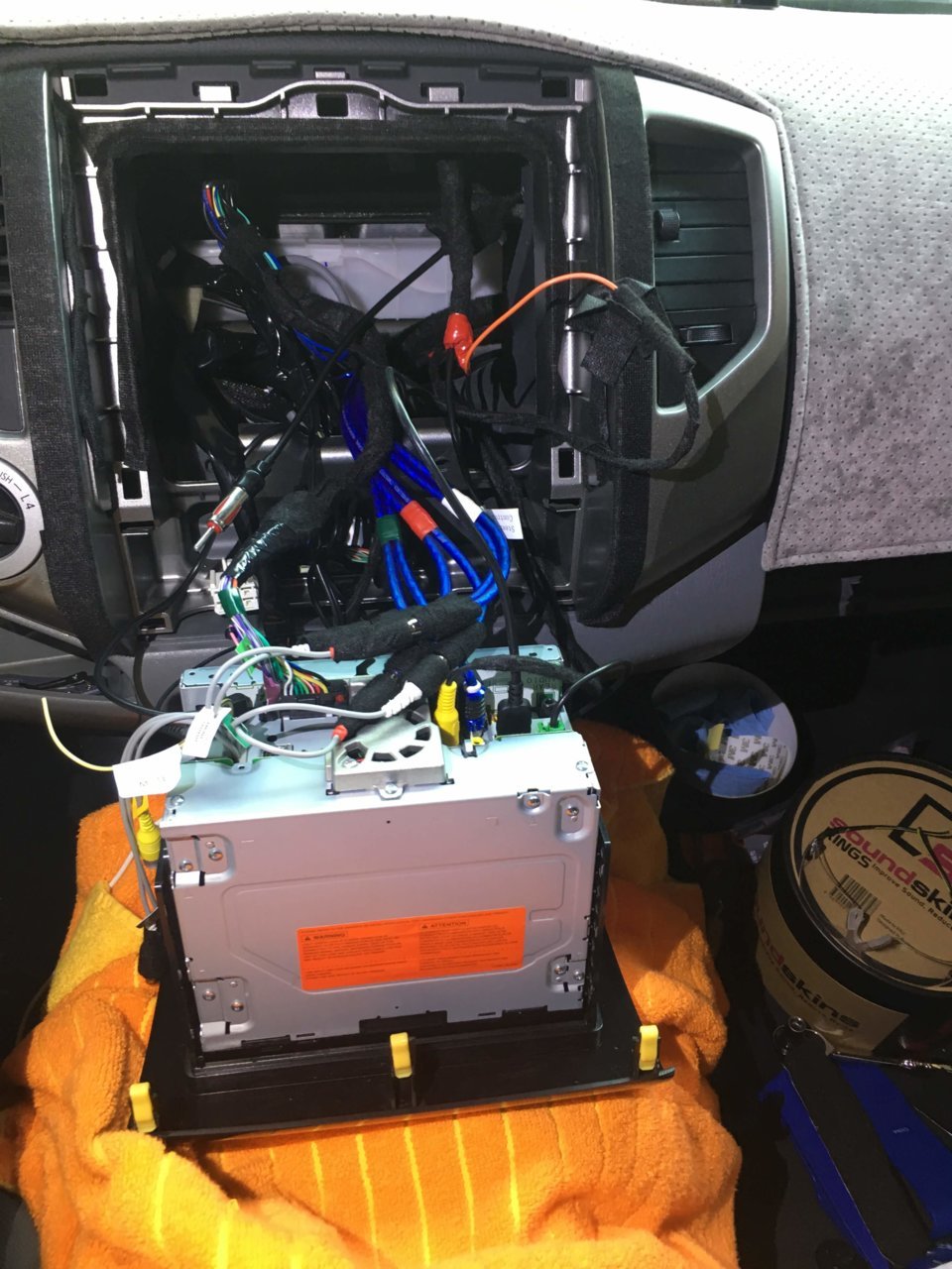

    Here's the head unit going into the dash. There isn't much space for all this crap so you have to plan ahead and be extremely patient & clever to get it all in without squishing all the wires.

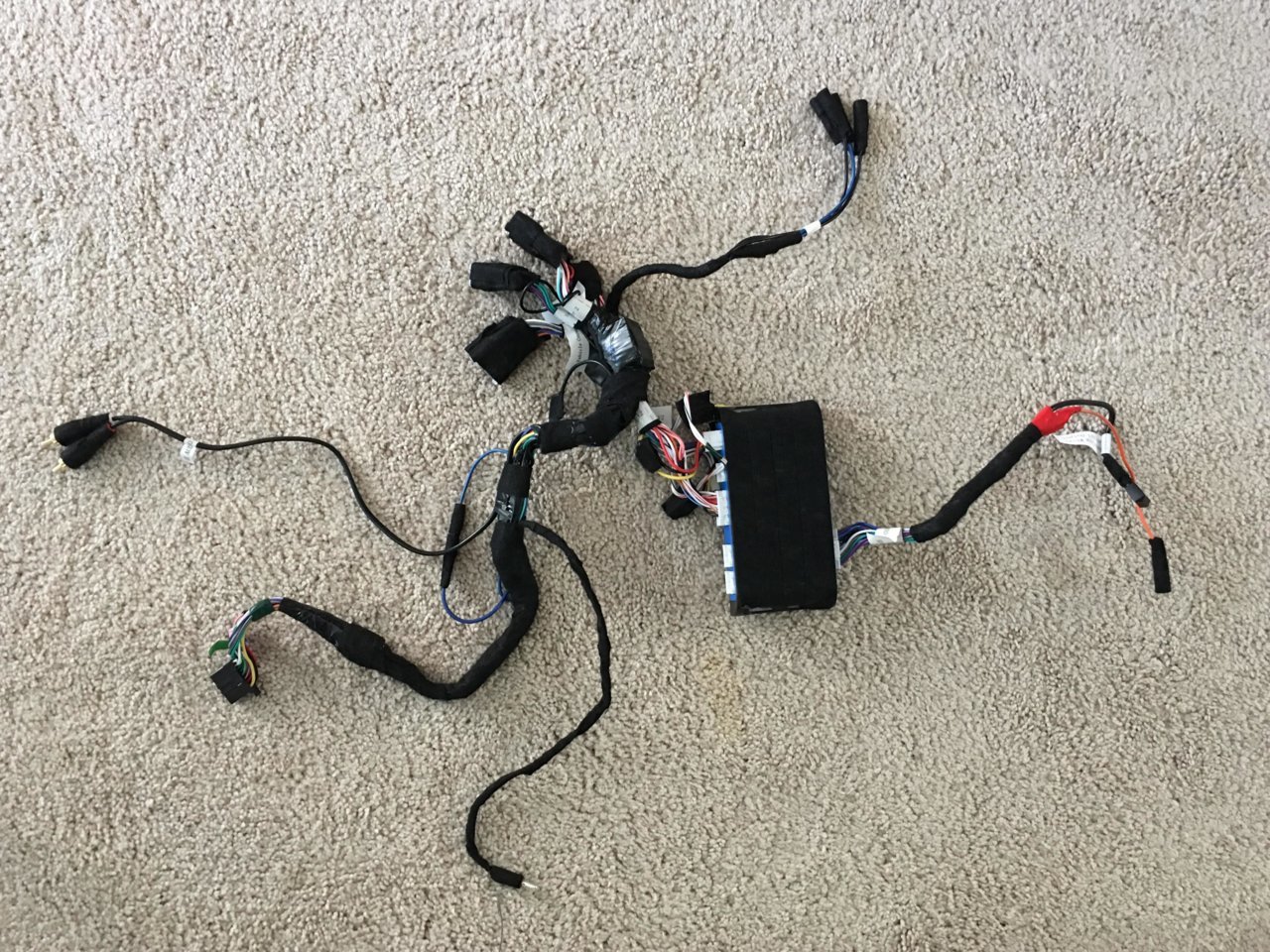

    This is the harness I had to stuff behind the head unit. It has the steering integration module, and all the other stuff. This picture has the oem camera integration harness included, but I decided to go another route by purchasing a 12v aftermarket camera from camera-source.

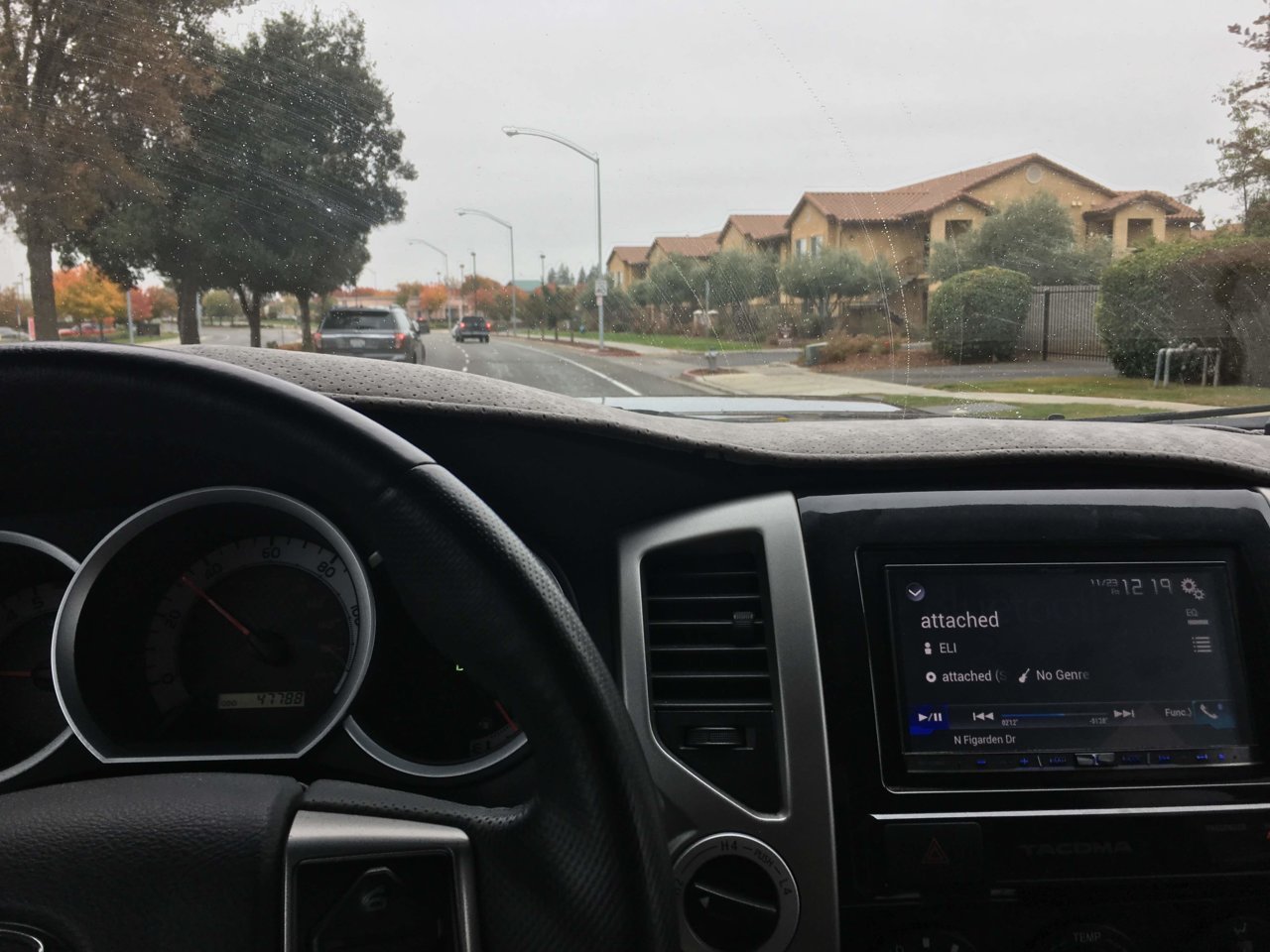

    Here's the aftermarket backup camera picture. I think it was an improvement from the stock camera, but quality does depend on lighting conditions.

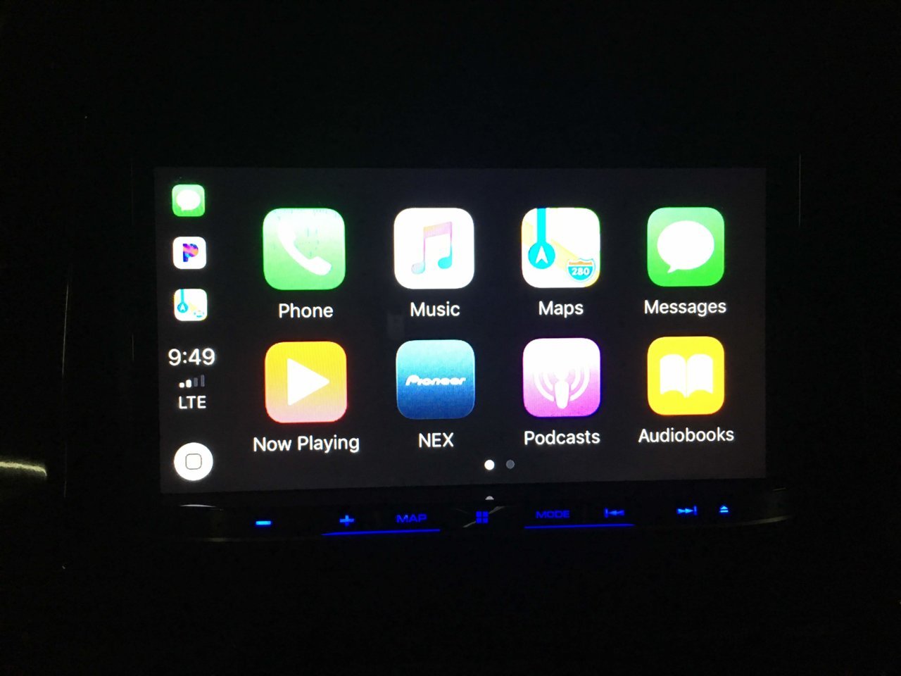

    Apple Car Play works great. The AVIC is a little bit laggy/slow, but once you figure out how to work around it's quirks I think it's a much better environment. Hopefully they will continue to get better with time.

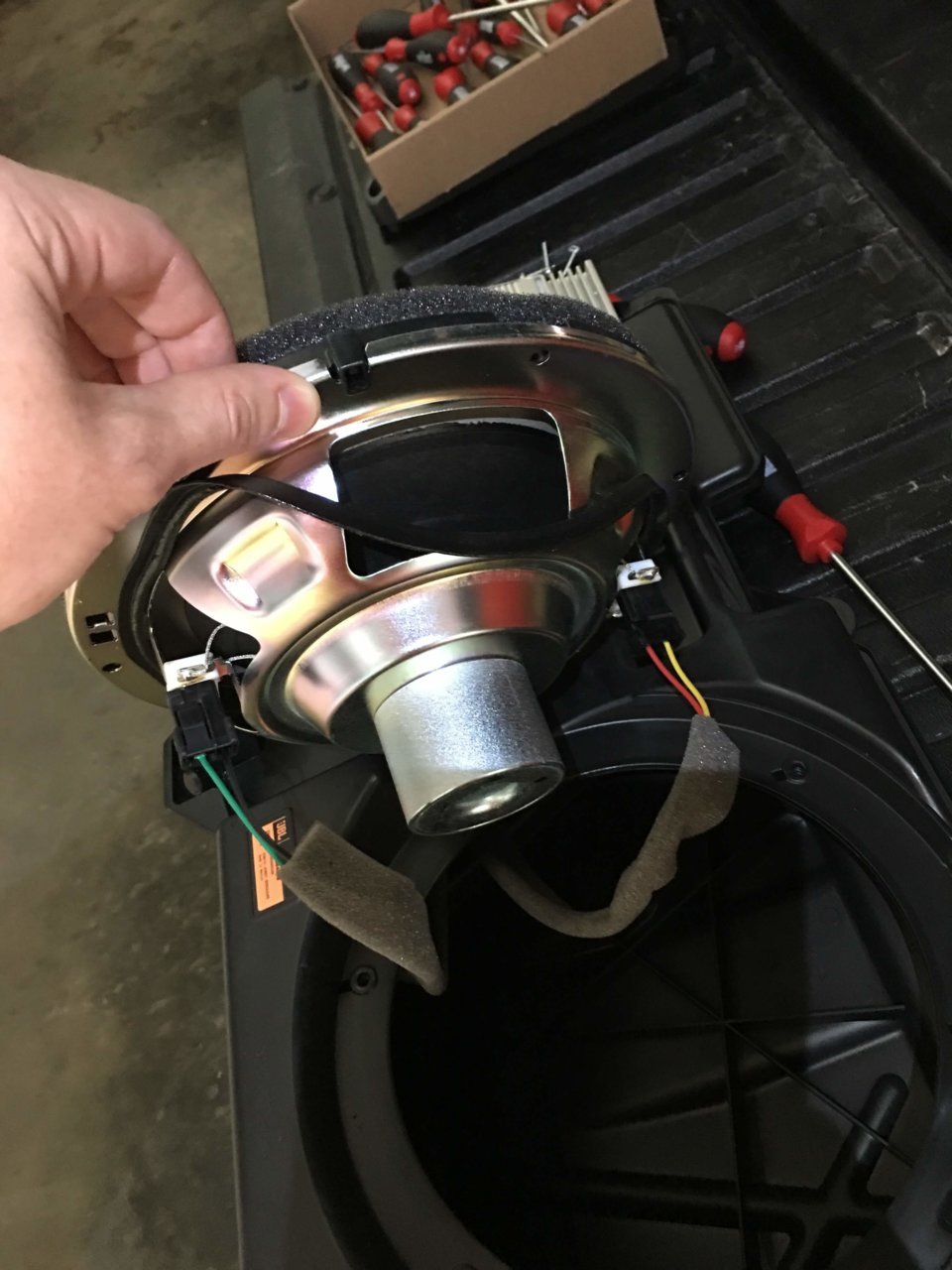

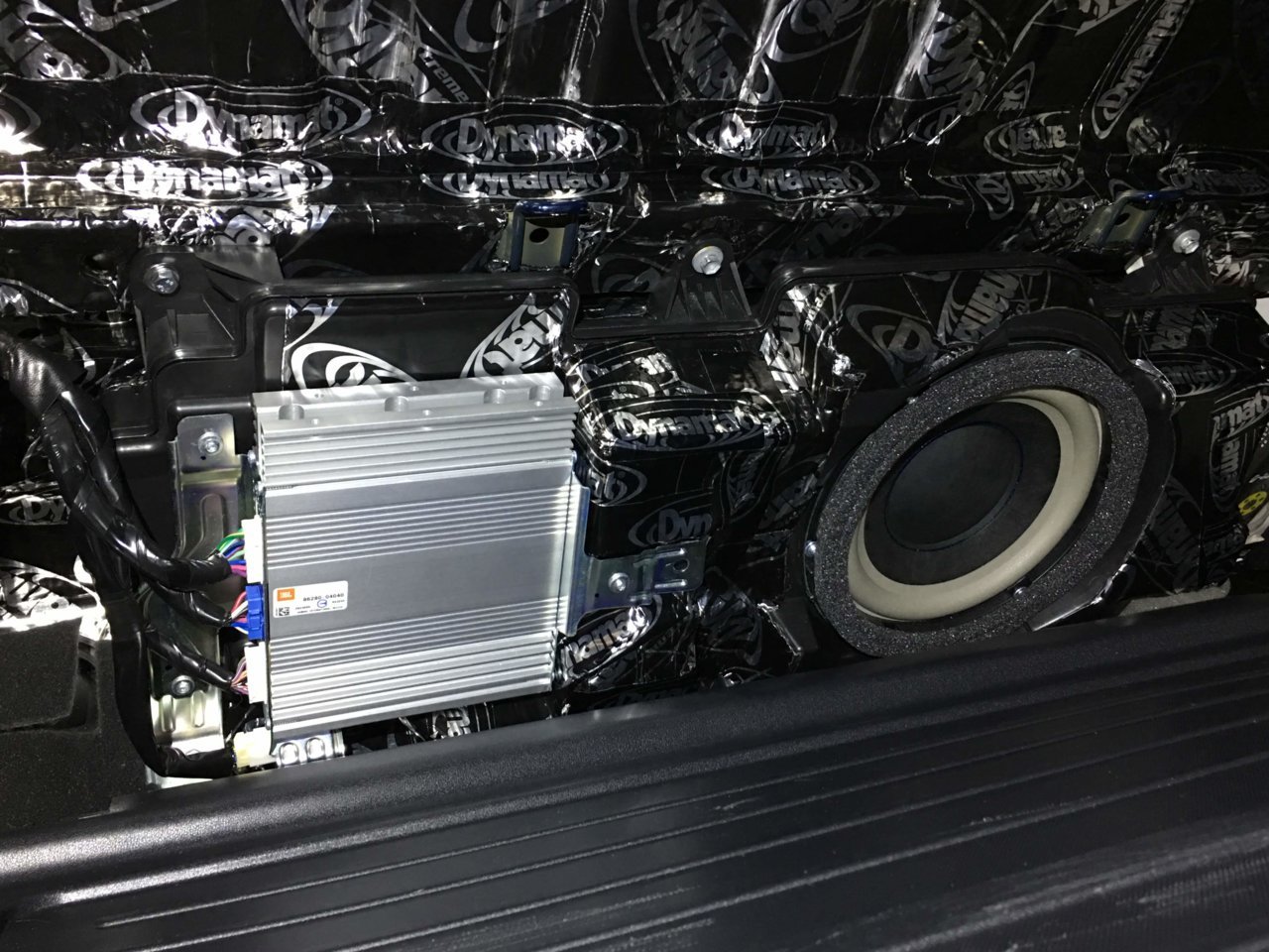

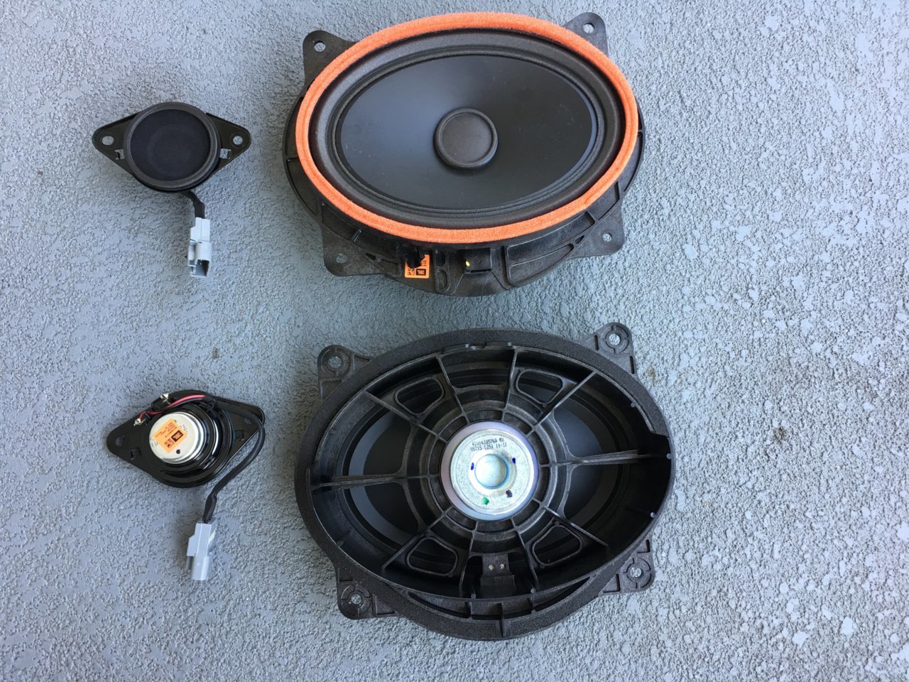

    I pulled out the OEM JBL subwoofer, series the coils, and ran it as a 4 ohm off my vxi on a 200W channel. It sounds pretty good, but we'll see if it holds up.IMG_1897.jpg
    I covered the factory sub in dynamat as well as the back wall. I will probably come back with some closed cell foam. (The JBL amp is now removed since I'm using the JL VXI).IMG_1902.jpg

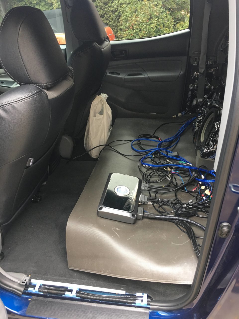

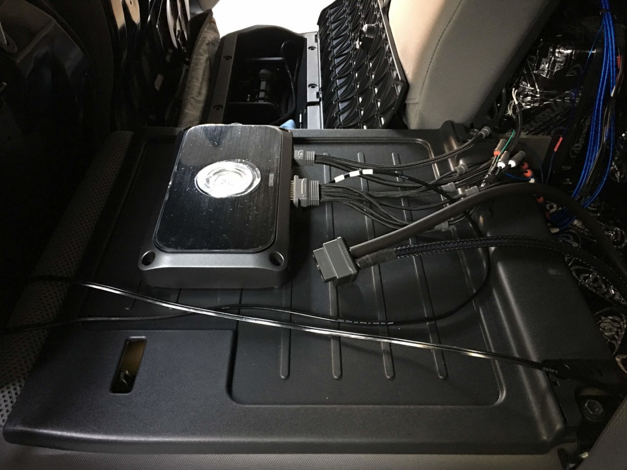

    Here's the VXI800/8i. I'm literally running it on the back of the rear seat right now. I haven't had time to mount it. Hopefully nobody breaks into the pickup and steals it.
    I will have to come back later and put the mat over this large service hole. The door panel needs to be modified in order to put deadening material over the larger service hole. I put quite a bit of sound skins in the doors. I started from the back of the cab with dynamat, then soundskins on the back doors and finally soundskins on the front doors. I noticed a huge road nose reduction when I did the front doors and a lot less vibration from the door panels. I work 50+ hours a week so I did the rear right door one weekend, the rear left door the next weekend, and the front two doors on labor day weekend.

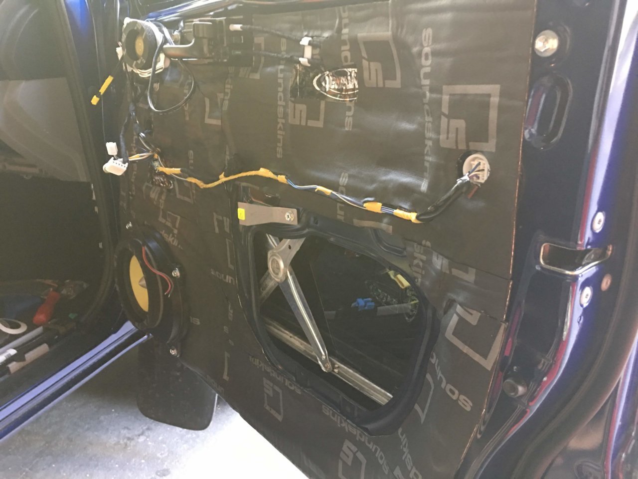

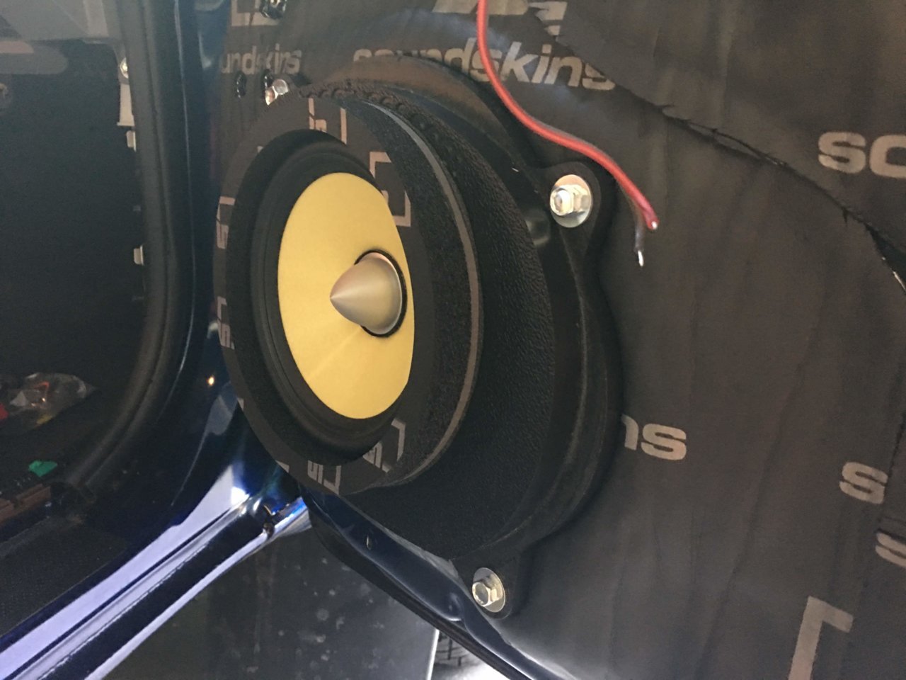

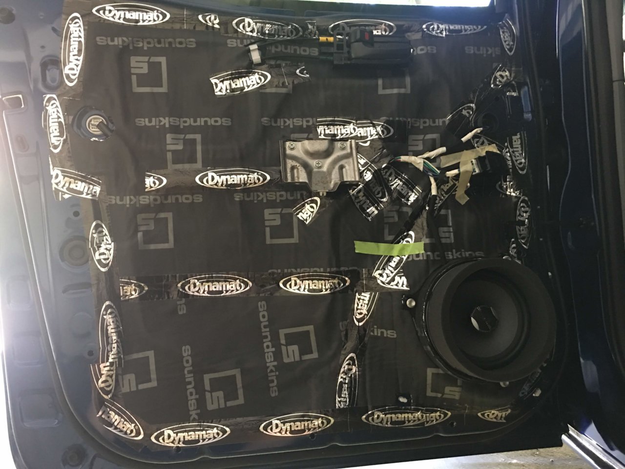

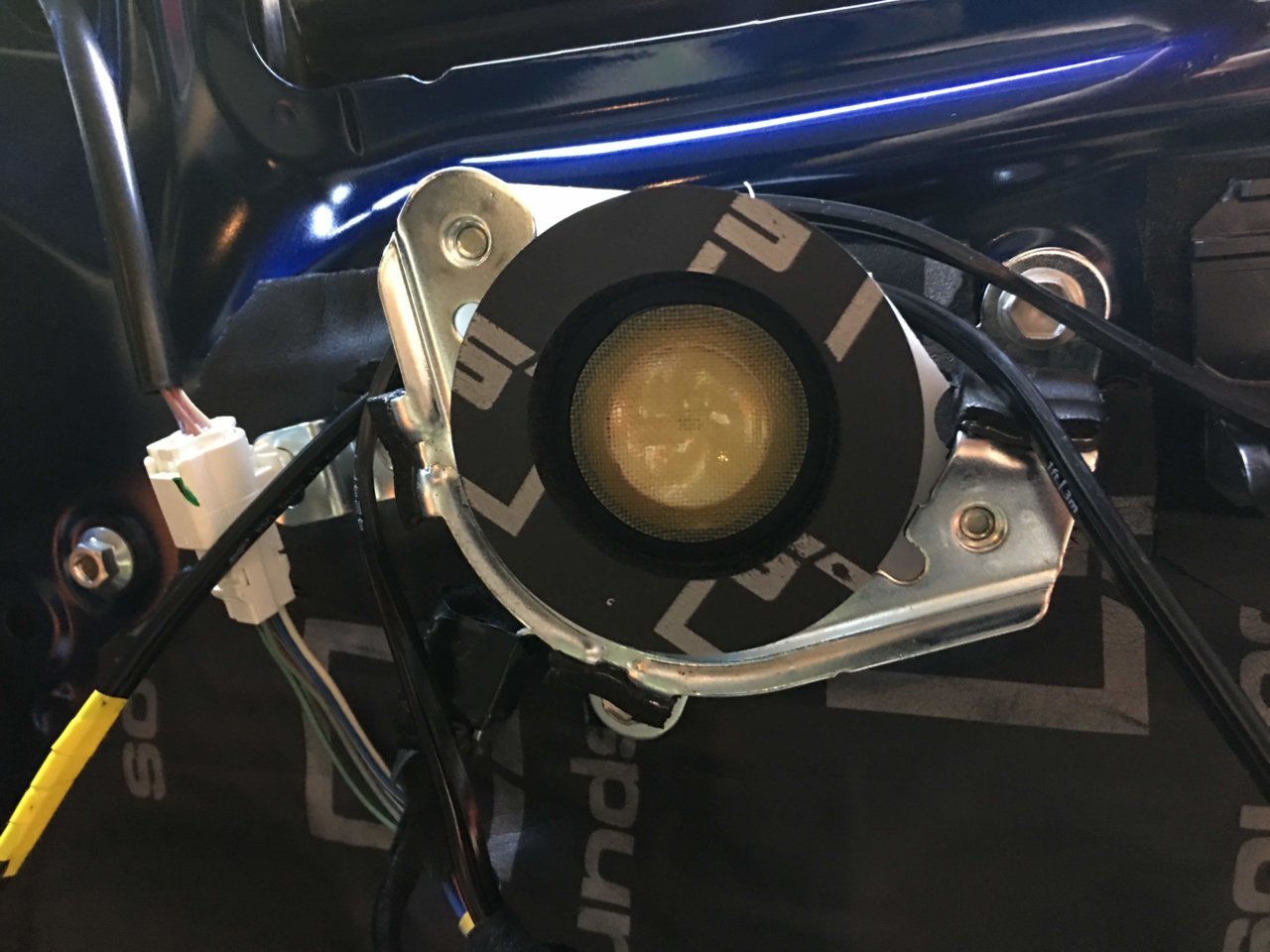

    I bought the ********* heavy duty speaker adapters and used the sound skins foam rings around the woofer/tweeters.IMG_1954.jpg
    The tweeter fits nice and snug.

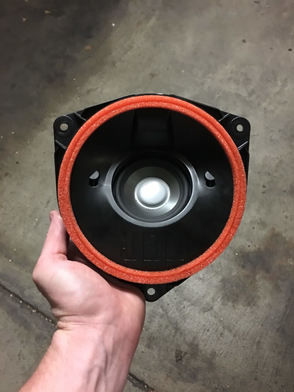

    These are the JBL front door tweeters/woofers. I think they had way too much mid-bass and the tweeter quality was extremely poor.
    Here's the back door totally finished up. Lots of soundskins on all the sheet metal and the coax speaker snug in foam rings from stinger.
    The JBL speaker from Toyota was basically just a tweeter. I picked up a lot of mid-bass from the rear of the cab which is nice.IMG_1843.jpg

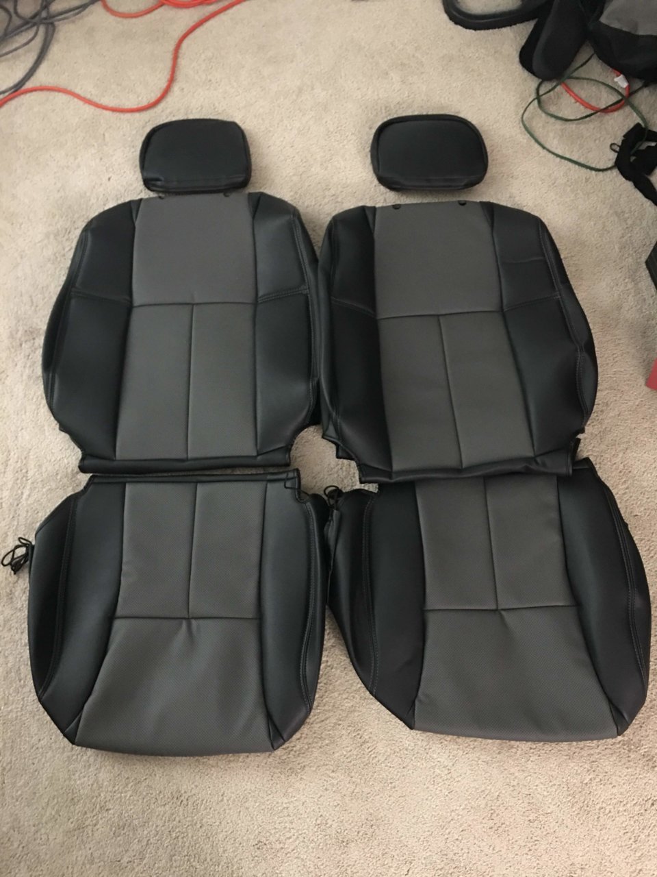

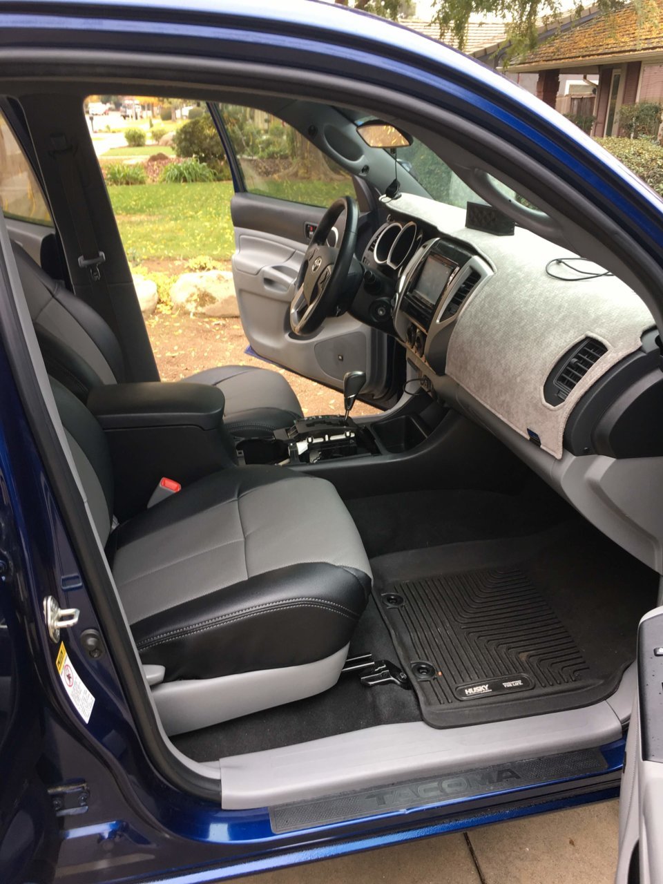

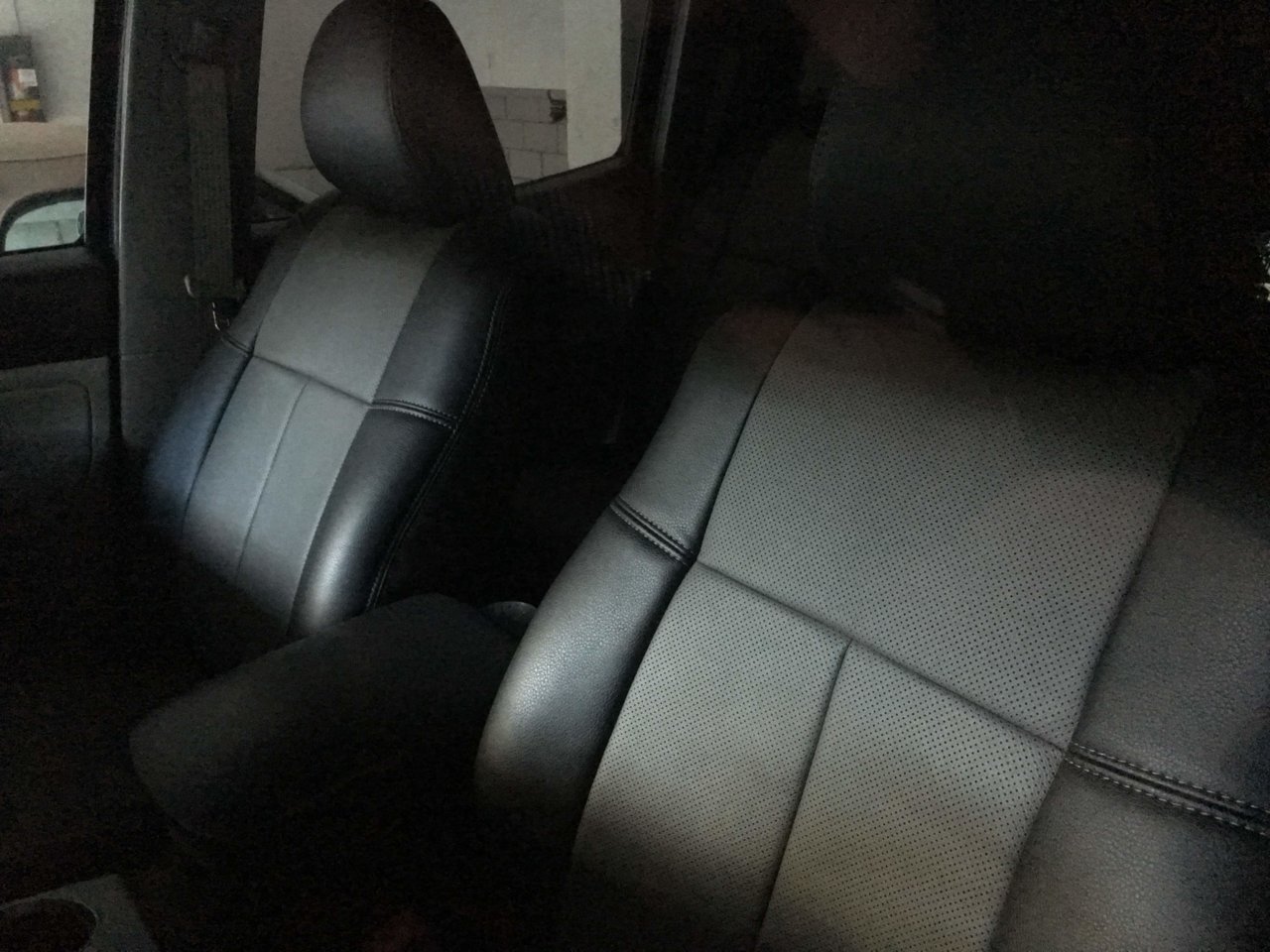

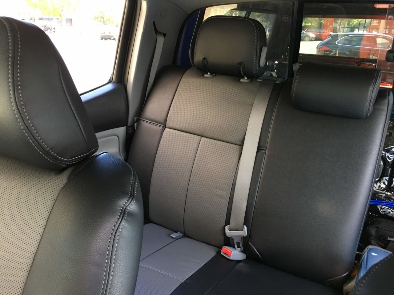

    1. I installed clazzio leather seat covers.

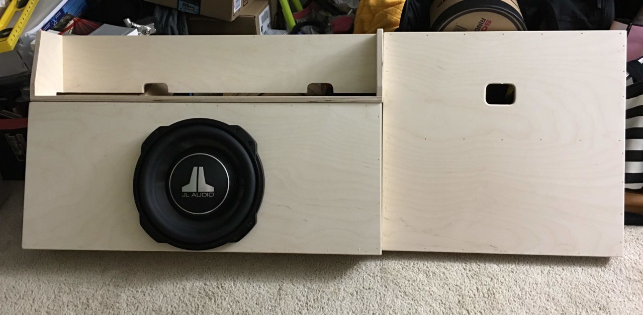

    2. I bought a JL TW3 Subwoofer and had MR Marv cut, glue and screw a nice hardwood.
    3. I bought a Maestro RR because I wanted idatalink and I was also having problems with the AVIC-8200 NEX crashing/locking up from what seemed like a problem with the accessory wire that comes from the PAC module.
    I went with black on the outside, dark perforated grey in the middle with dark grey stitching.
    Still haven't gotten the bottoms cinched up how I want them.
    The back seats look really good.

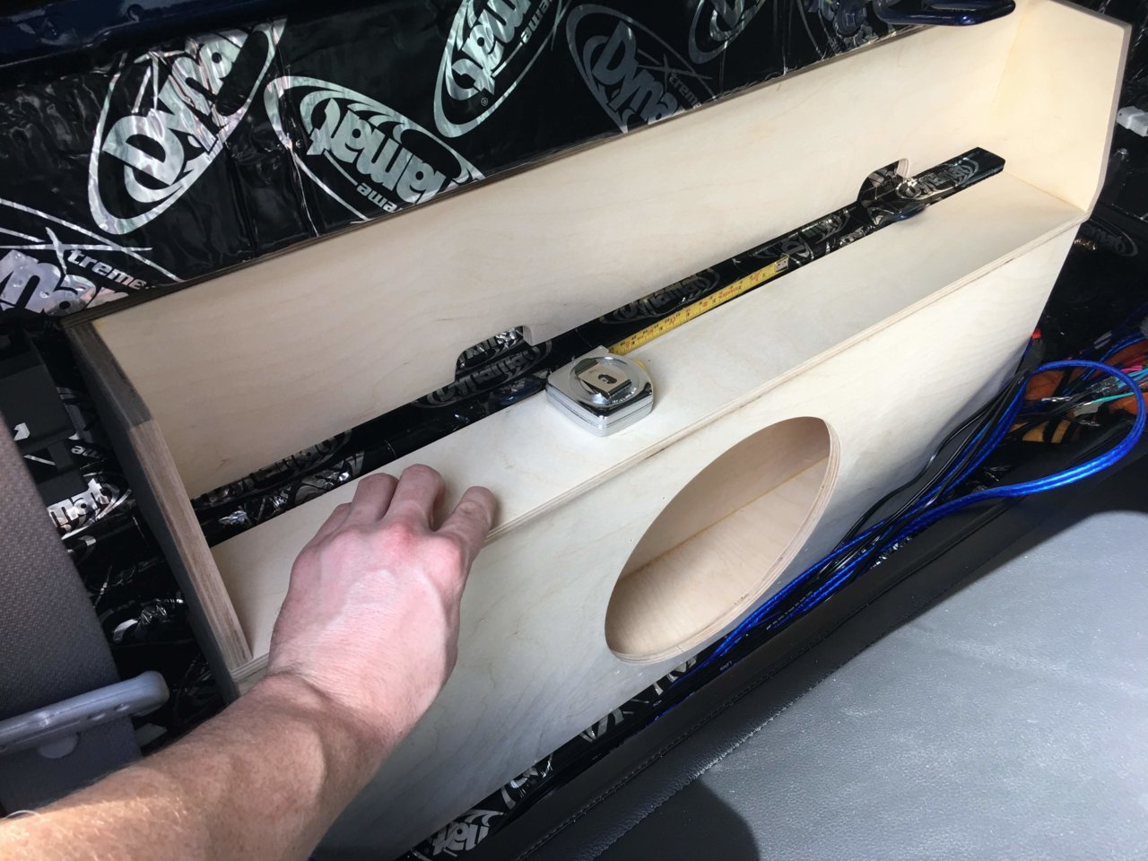

    Here's what I've got in the backlog. 10" enclosure with shelf and amp rack from @Mrmarv. I hope one sub is enough, I think I'm going to need to deaden the roof....
    Just need to do a few adjustments before I put carpet on it.

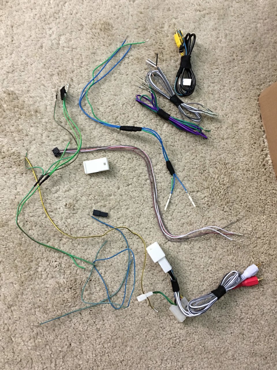

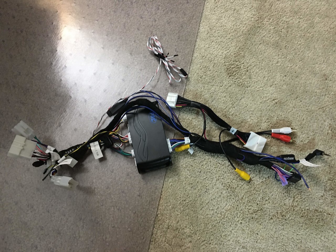

    I started with this PAC RP4.2-TY11 to integrate the factory steering controls, but to be honest I think the Maestro RR is much better for a number of reasons.
    • PAC harness is garbage and makes it very difficult to have enough space behind the radio.
    • PAC module loses its configuration every time you disconnect the battery. That means you might not get the steering controls the way you like them and you'll need to open the dash every time you disconnect the source. I found out from trial that the Maestro does not have this problem!
    • I wanted idatalink.
    I took the T01 Maestro RR harness and I de-pinned all the wires/connectors that I don't need. Since I'm using my own amp and an aftermarket backup camera I was able to remove quite a lot from the Maestro RR harness. It made installing the radio very easy compared to the PAC module. No squished wires, plenty of space for the Pioneer AVIC NEX Exhaust fan, and minimal patience required to stuff the dash.
    Wires with red tags are Accessory, Wires with blue tags are Remote, and wires with green tags are Ground. I use bullet connectors for the stuff that isn't part of the factory harness so I can remove this cluster and I always leave a few extra hooks to ground, accessory, remote, and 12. Everything in the harness that I wire is soldered or crimped first and then soldered. I also use clear shrink tube and do two layers on each and every joint.
    My backup camera is wired off Accessory and my amp is wired off remote. Later I can choose to rewire these if I want to thanks to the bullet connectors (They're not the best connectors tbh). I stuck the Maestro RR module to the bottom side of the dash top using Velcro.

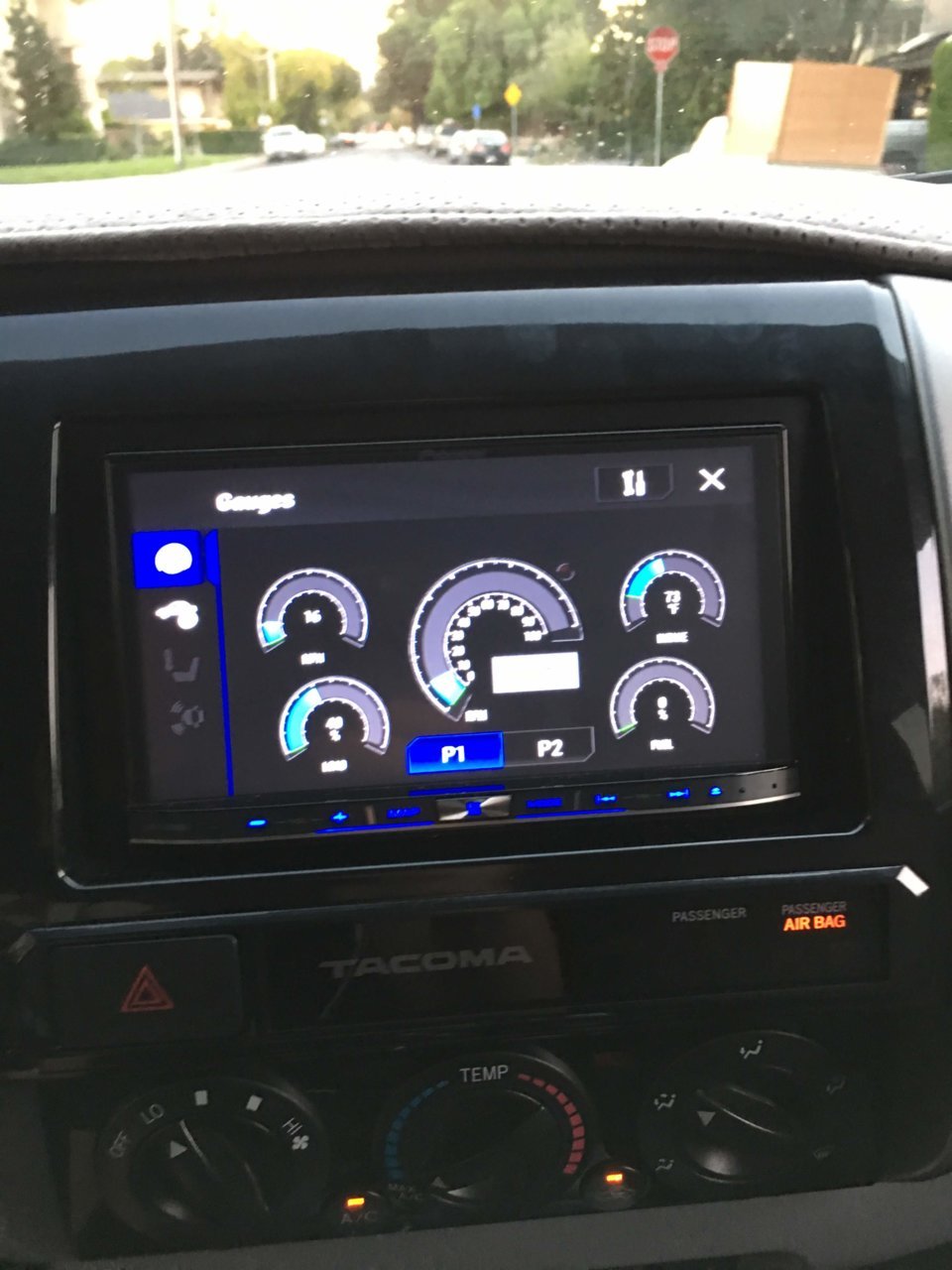

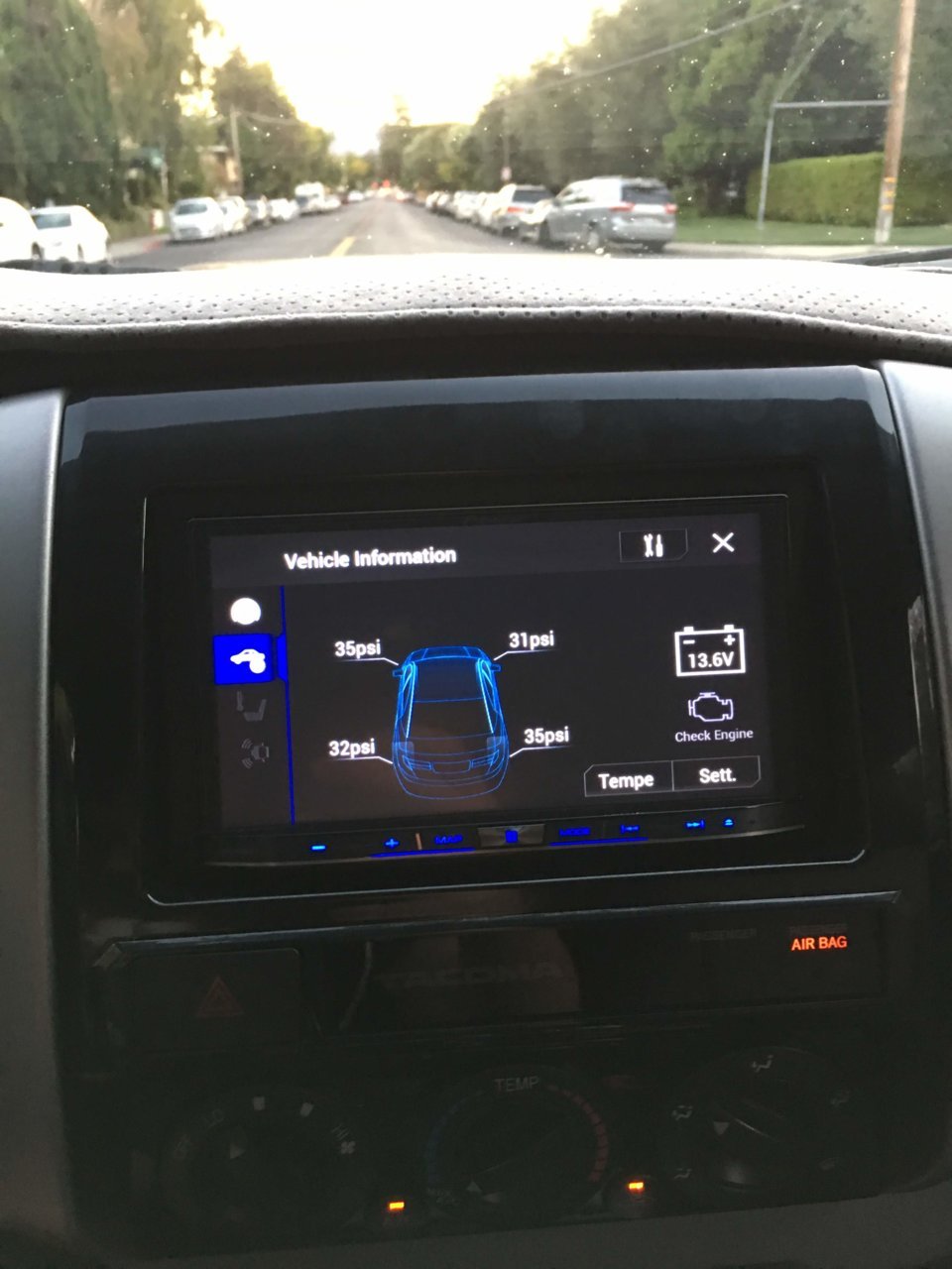

    I got the tire pressures, gauges, and such.
    Here's the gauges. All of the stuff Toyota figured you didn't need to see.

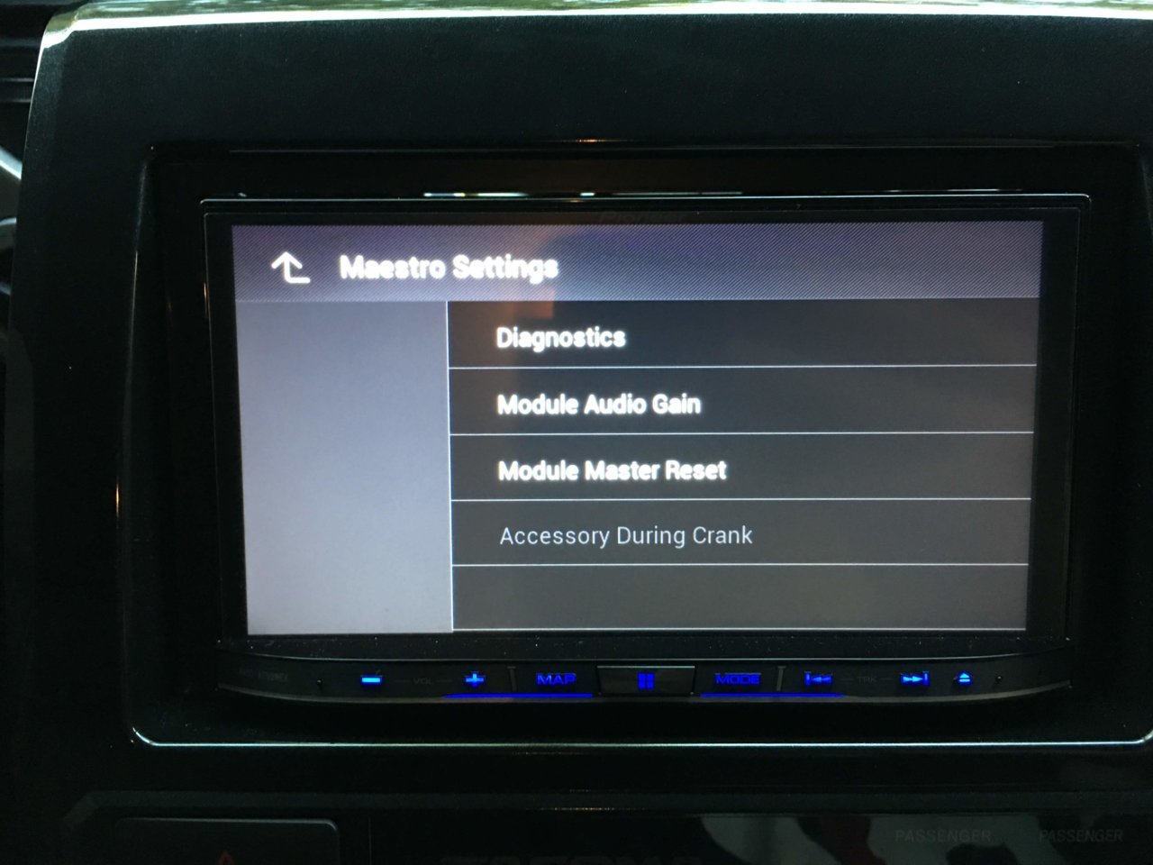

    Why can't I enable "Accessory During Crank"? I have a pending question open on the Maestro technical forums about this feature.
    Here are all the wires I was able to exclude from the Maestro RR T01 harness. For me this was a very simple wiring job because by the time I had de-pinned all the wires/connectors my install wouldn't use I had extra accessory, ground, and 12v wires hanging off the harness that I was able to use for my install. I had to solder far less joints on this harness than I did on the PAC harness.

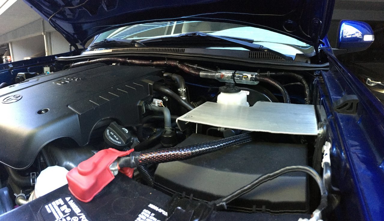

    Still need to do some work here on my big 3 upgrade. For now it looks like this under the hood.

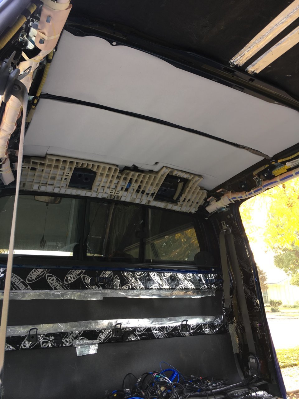

    All of this work did reduce the road noise by quite a lot. I didn't actually take any measurements, but I can tell based on how much lower the stereo listening volume needs to be. The outside sounds are much less intense.

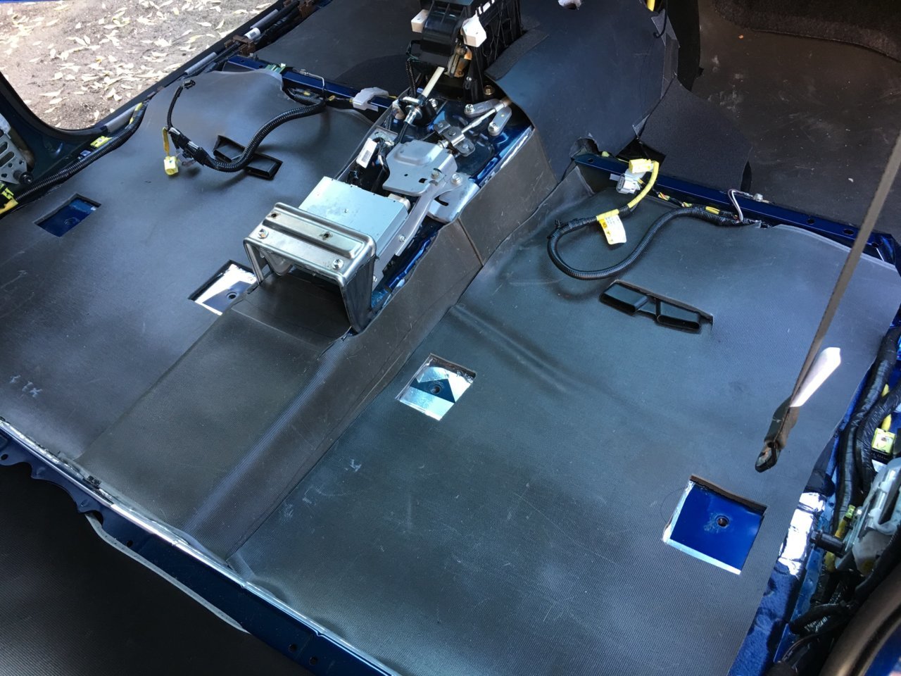

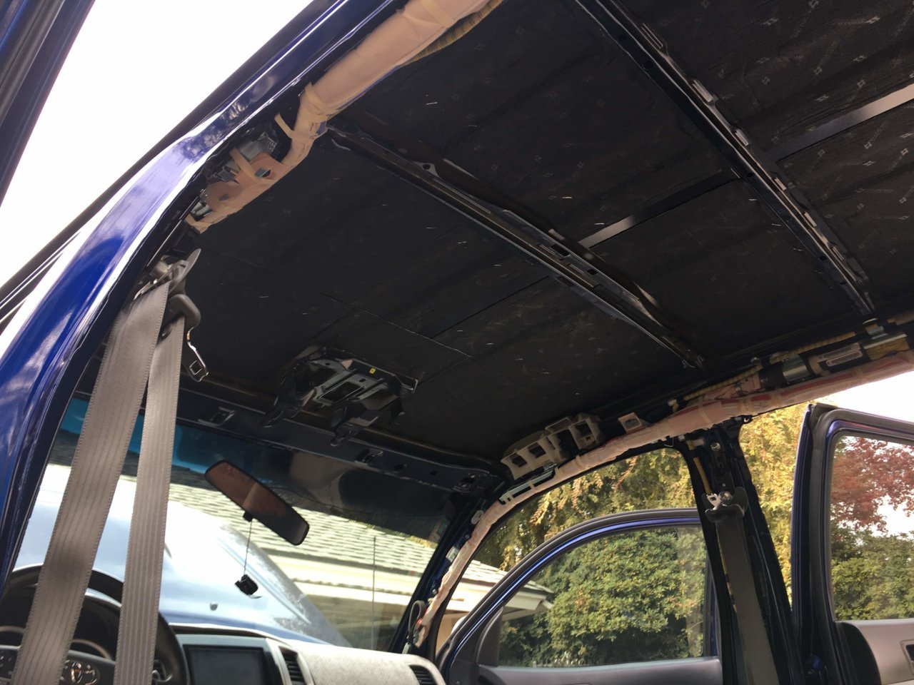

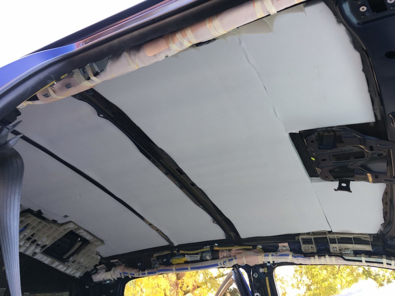

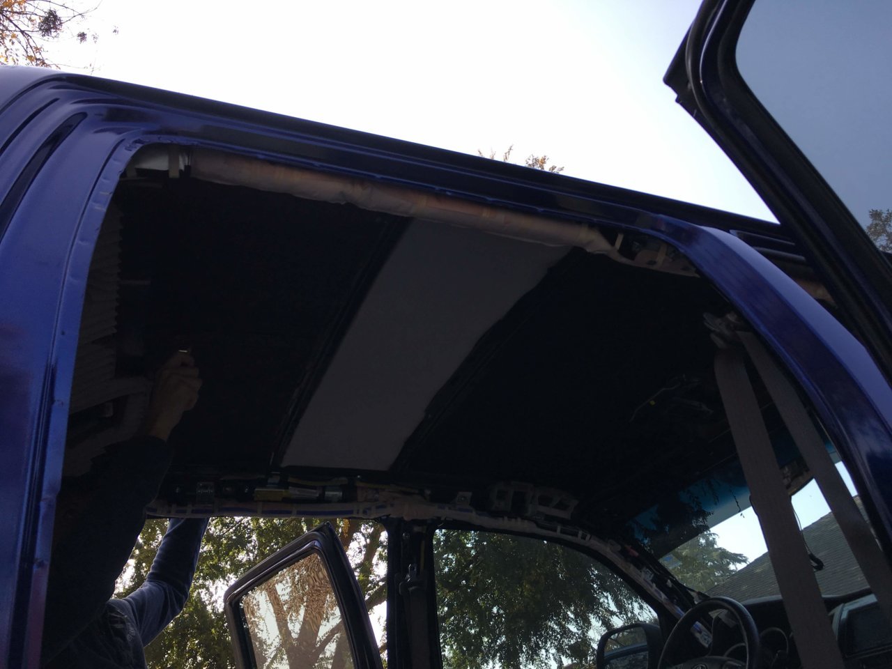

    This is the sound skin damper pro on the roof. It went from tin can to m1a1 abrams. Very easy to apply to the roof given the shape.

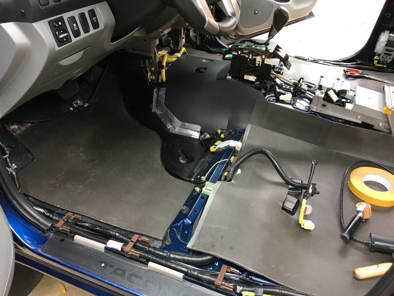

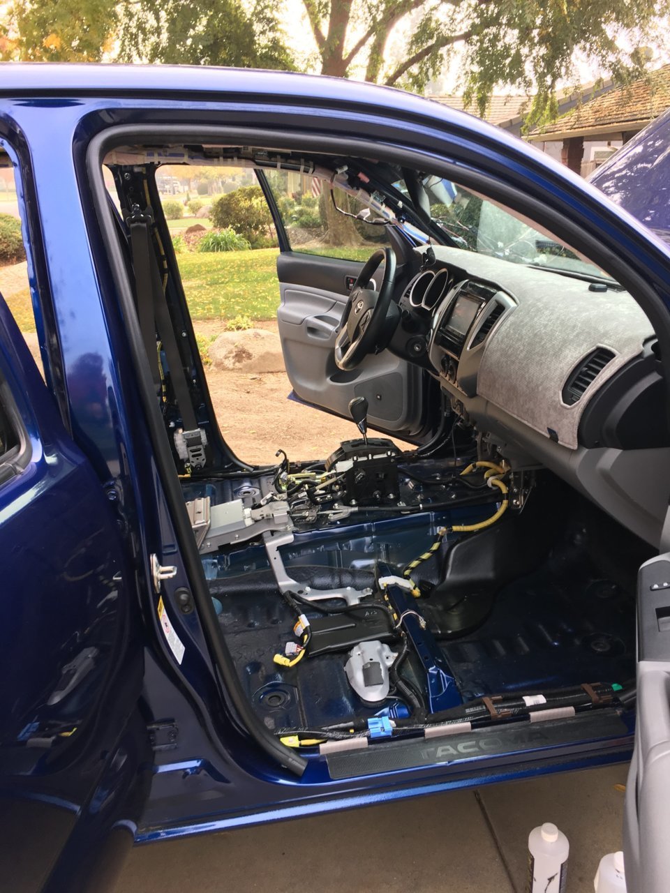

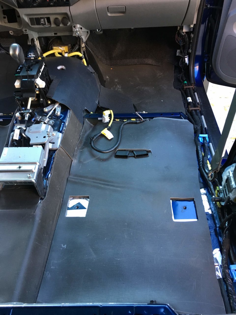

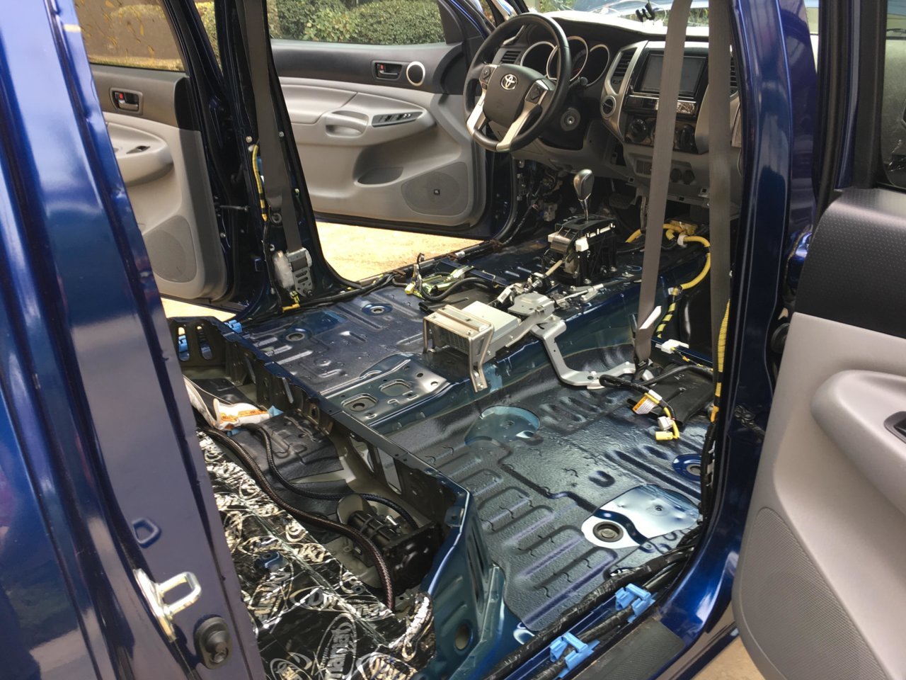

    Now its time to pay some attention to the floors. I already used dynamite on the back wall as you can kind of see.
    Gut it out.

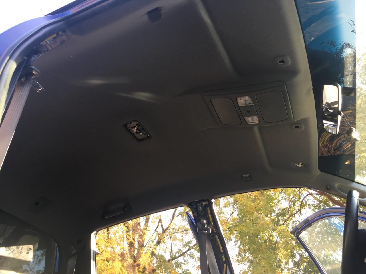

    Putting up the Melamine foam on the roof for some thermal insulation and maybe reduce some of the busy noise.
    I put a lot of detail work in the plastic thing on the back of the roof because mine was rattling from the sub. Put foam in it and use butyl rope
    to make it vibrate against the roof a lot less.
    Finished stuffing the Melamine on the roof.
    I dropped the headliner alone, but I had two helpers to re-install. It made the process very simple and we didn't damage a thing. (I did break one of the visor hooks getting the headliner down).
    I forgot to take pictures of the damper pro I applied to the floors... I just stuck it on top of the factory deadener. Here's the luxury liner pro layer.
    More views of the luxury liner pro layer.
    Leave enough room around the seat bolts so the plastic bolt covers can go back on.

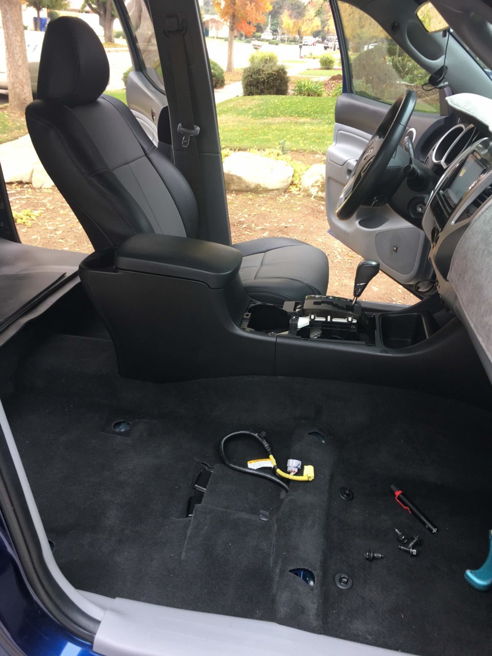

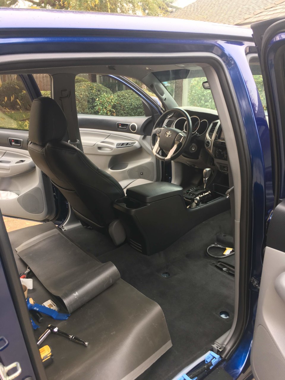

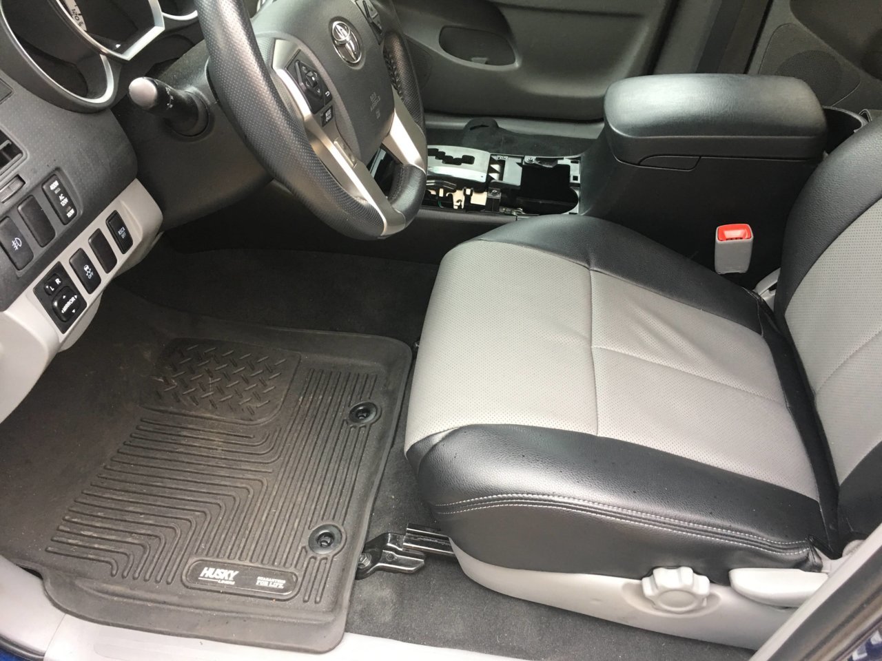

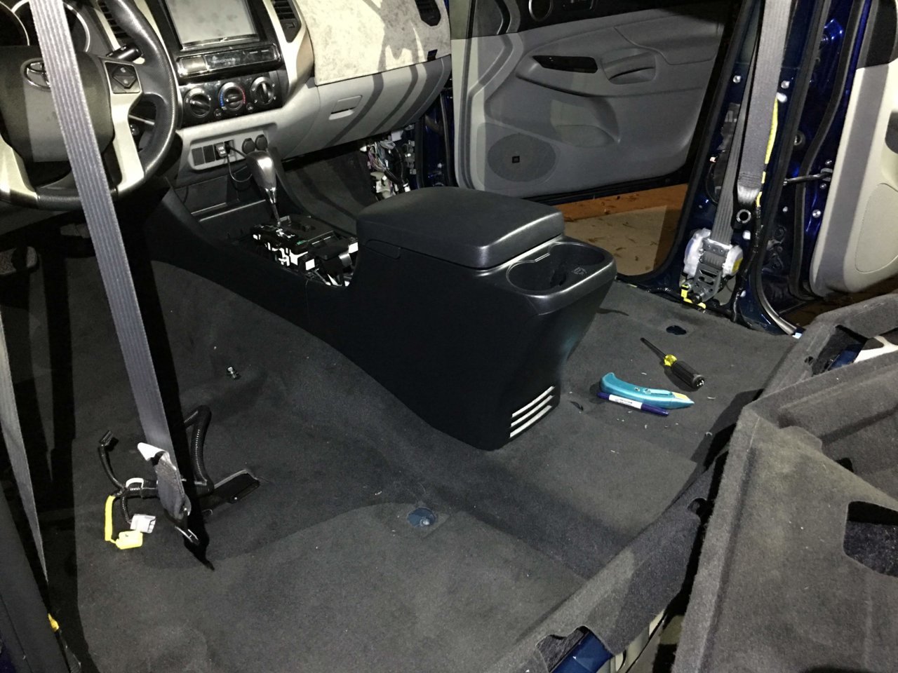

    Center console fit just fine. The carpet fit a little different, but it was fine. Most of the fitment issues are minor and under the front seats.
    I made a MLV liner for the center console. I put it under the factory console liner.
    Driver seat goes in first.
    Looking pretty good!
    I can't believe the floor mats fit so good.
    Same thing on the passenger side.

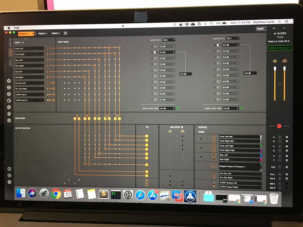

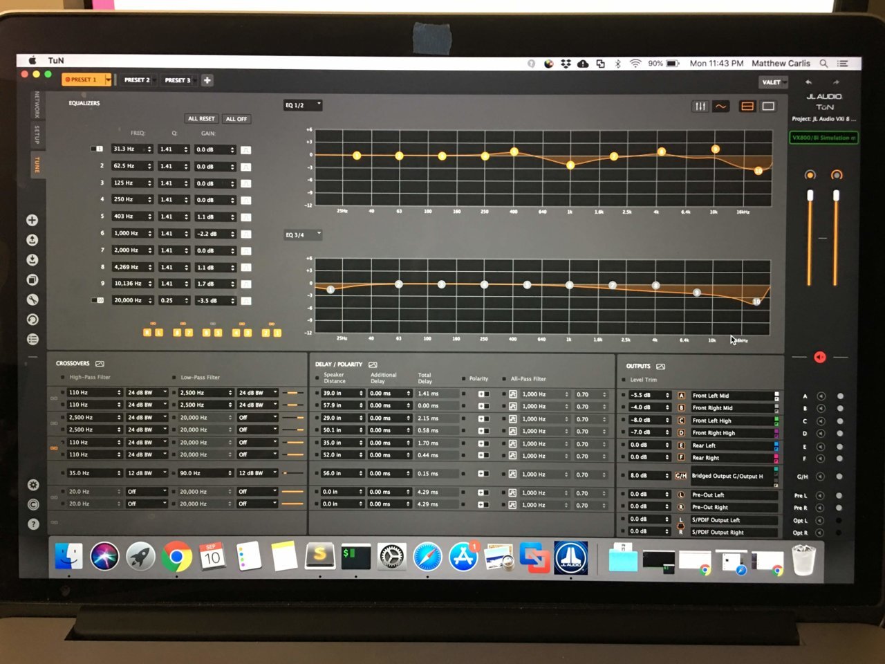

    I started playing with the iMM-6 Dayton Audio Mic and Audio Tools from on an ipad to try and tune the audio system. I think I have the timing alignment about right, but I have yet to try and do anything with the eq.
    Does anyone know if you can use the "Delay Finder" app to fine tune the timing alignment?

    Not sure about any app, but T/A with a tape measure is pretty straight forward. Your head will be moving around while driving so absolute precision isn't going to count for much. I've had to tinker a bit with off-axis subs, but always just sit there and dial in more or less delay 'till it sounds right.
    Great looking build so far! You're definitely the patient type...should pay off in spades.

    If you had to estimate, how long per door (Time) and how much sqft (Material)? I want to do my doors

    I spent way more time than you really need to. If there was one thing I would change about the install it would be how much time I spent deadening each door.
    I used 6.5 rolls of soundskins pro across all four doors. A lot of deadener. There's deadener on all three sheet surfaces in each door. Outer shell, inner-inside, inner. I wasted a lot of time trying to figure out what I wanted to do with the materials etc. I would say I spent about 8 hours per door average & I got better/faster as I went along.
    Do the front doors first for cost/benefit.
    I did the rear doors first because I wanted to practice on the doors least frequently used.

    In a fully active sytem would you say you have to apply kind of extreme eq? I was in the car with a mic for a while today and I get some harsh peaks on RTA. 250hz, 1khz +6dB.

    It all depends on the car & drivers. Each setup will be different. Generally speaking vehicles are terrible environments for acoustics & that's why DSP is so valuable. My truck has a couple modes - one really bad dip around 500 Hz and another around 200. So yeah, I have to make reasonably extreme adjustments to try and tame them. Luckily we have the tools.
