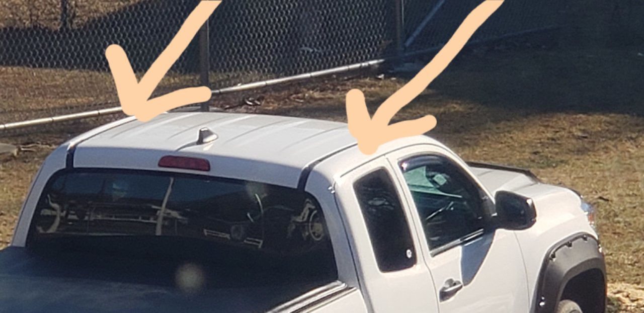

    So I have the access cab and rarely (ever?) see anything for the roof channels that have rubber covers..
    are there roof rack mounts for these or what use are they?? (See below pic)
    Planning on taking this on some camping road trip sort of tours maybe...

    The rubber inserts cover the channel when there is no roof rack ordered.

    assuming i remove the rubber covers ....
    Can I put a roof rack on the top...can I buy the mounts that attach to this channel.... Is it of.much value or usefulness?.

    From what I remember, the access cab does not have the mounting holes under the trim, there are roof racks made, but you need to drill holes and run bolts to install them.

    Here is a video showing how to install a rack on the access cab

    Thanks guys..imho not really worth it.. drilling holes and such......
    but at least I know now and I thank you for explaining it. I always wondered about it and my curiosity has been satisfied.

    That explains alot.... thanks for the video.
    So bottom line is that even though there is the channel the access cab does not have the mounting holes like the double cab does.

    You will need to drill into your roof. If you do it right, it shouldn't leak.
    then if you want to remove it (like i did) and not weld, i used set screws, rtv, teflon tape, and flex seal tape. It is possible to "undo"
