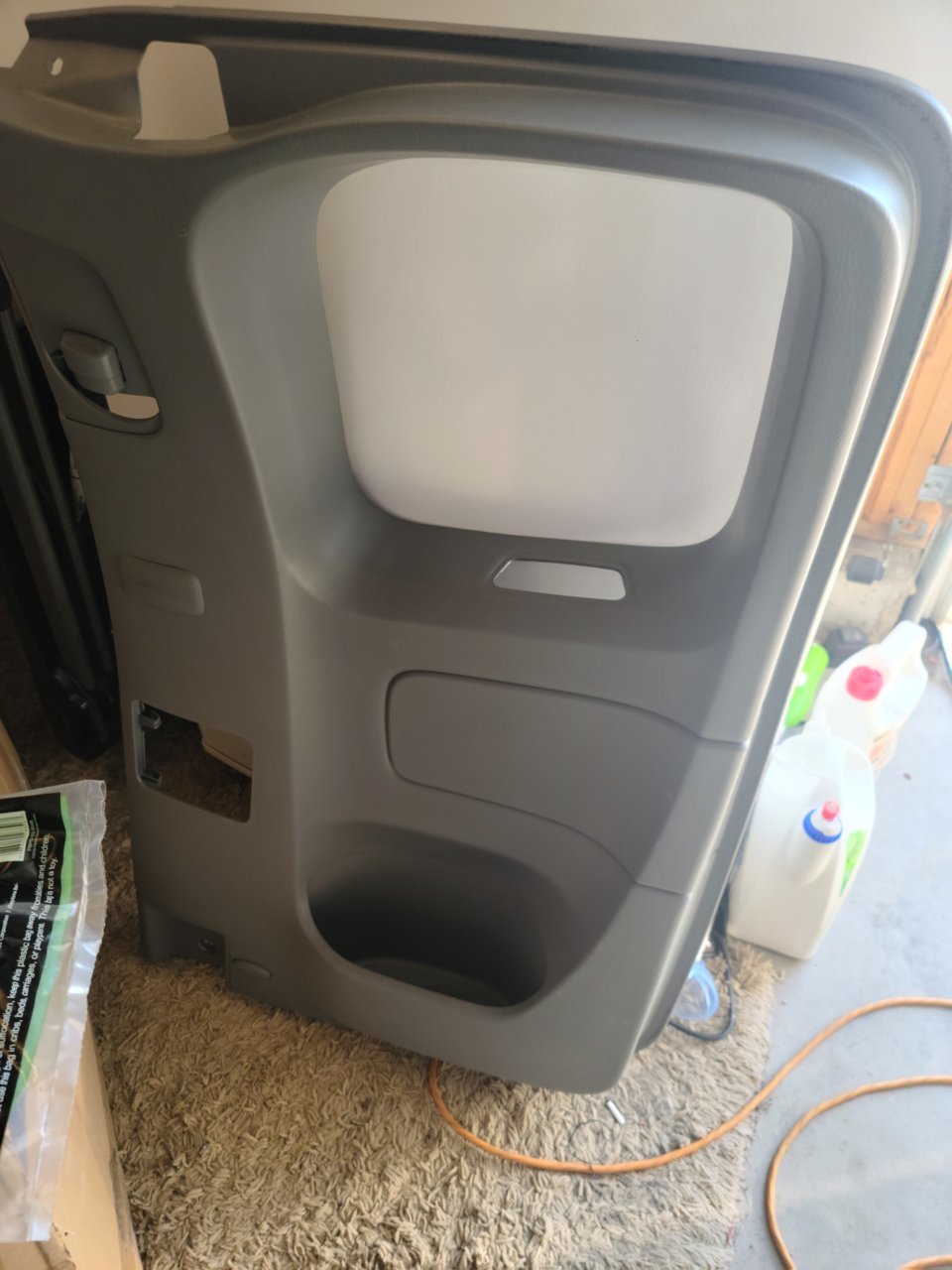

    I'm just curious about the rear access cab door trim panels if anyone has some experience with them!
    Currently I have a 14 Tacoma Access Cab, and I've done quite a few upgrades on the sound system, however I have 2x 6.5" Focals sitting in my garage right now because I refuse to mount them behind the panels I have now as they don't have any vents. I know they made the rear doors from 05-09 with them, so that being said, does anyone know if the mounting hardware/brackets are the same between the years? Like are they just plug and play from 08--14 or am I going to get one and find a mounting bracket a couple centimeters off on the old panels.. Anyways thanks for the input and if anyone has some suggestions on it I'd appreciate anything!20210719_103435.jpg 20210719_103440.jpg

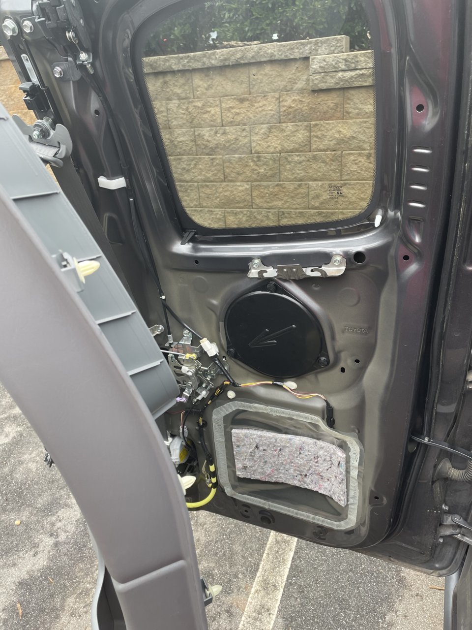

    No. I think it was 2009 or 2010 they stopped. There's these super shitty piezo speakers in the headliner, but there are no wires run to the rear doors. Kinda shitty
    Photo taken from another member, but this is what it looks like behind

    Alright!!! The day has finally come, and I got my brackets in the mail yesterday! New(old) door panels have been here since last Thursday, so I went ahead and knocked it out this morning. Pretty straight forward, doors fit perfectly, speakers fit perfectly, and I ended up having to change my amp setup. I have it set up so all my speaker level outputs can go to an RCA converter, then from the RCA converter (front channel) to my speaker amp, and my rear channel RCA's hooked to my mono sub amp. With the added speakers, I just put the rear channel RCA's into my speaker amp, then got another set of RCA cables to jump from my ch1 output on my amp to the input on my sub amp. Anyways! Hiding the wiring is the easiest thing ever in this taco, it's almost like there were meant to be speakers there in the first place 0.o
    Overall though, the sound improvement is so far beyond what I expected, and it was definitely worth the $350 (for the panels, brackets, and a new set of RCA cables)
    If you're thinking about doing this - stop thinking about it, and just bite the bullet. Pics below
