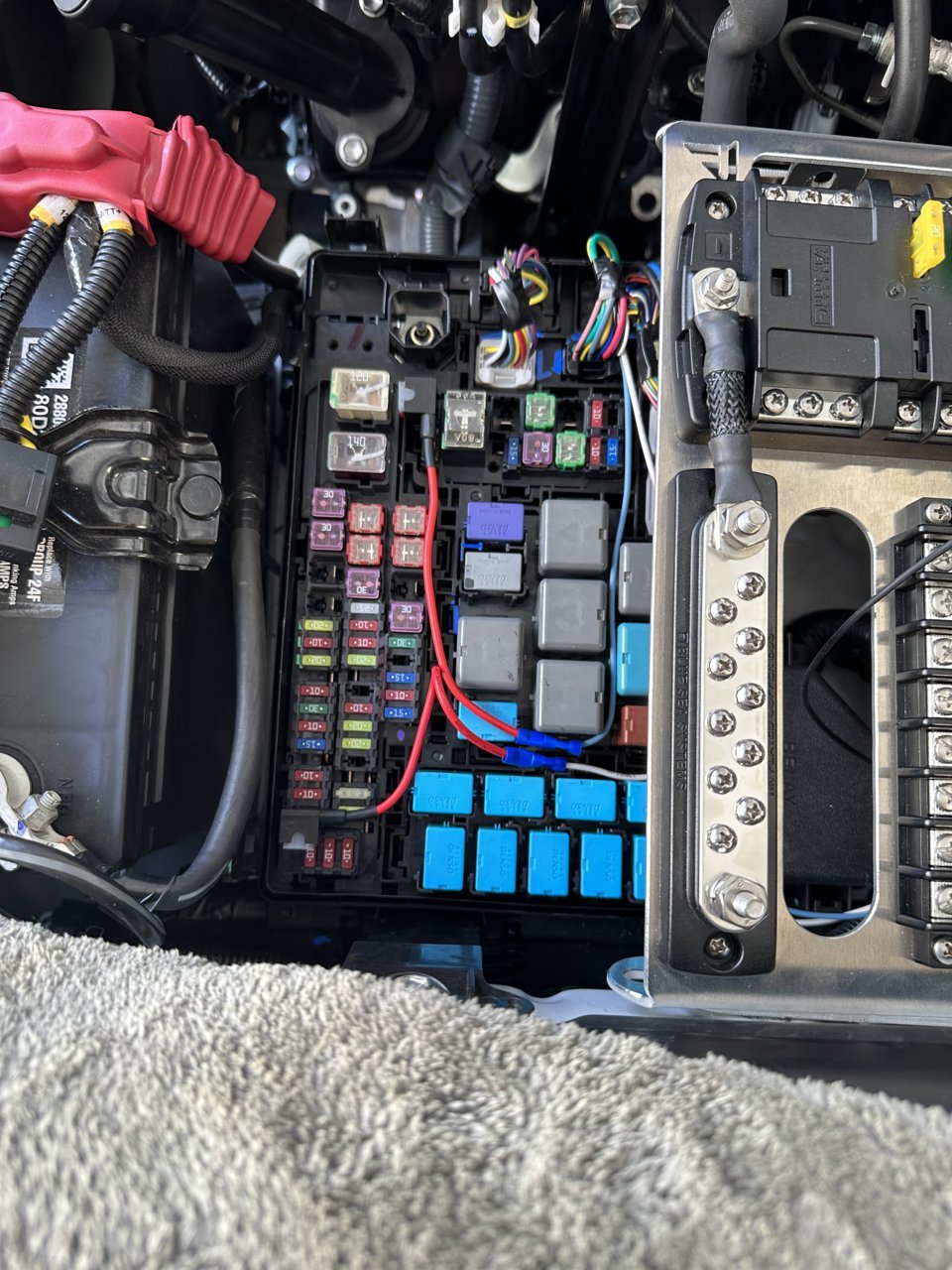

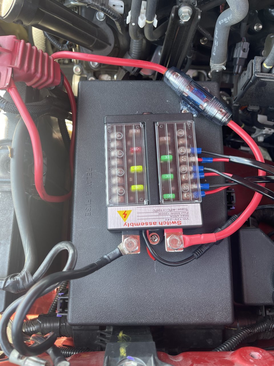

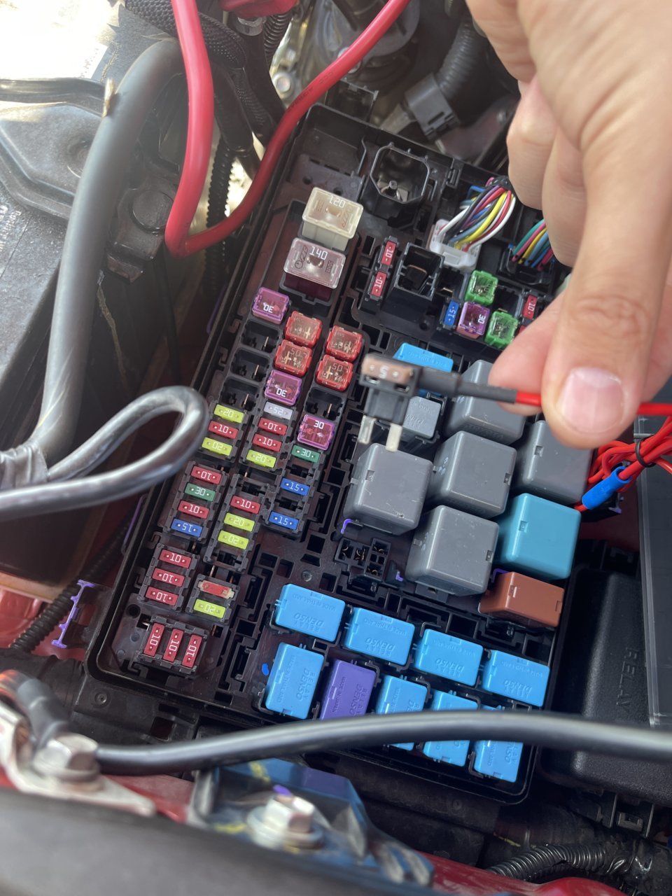

    This is what i have install and this is the small wire that have to be plug in the acc fuse so it doesn’t drain the battery

    In that fuse box I think most plug into INJ or INJ2 spot. But please let someone else chime in to confirm.

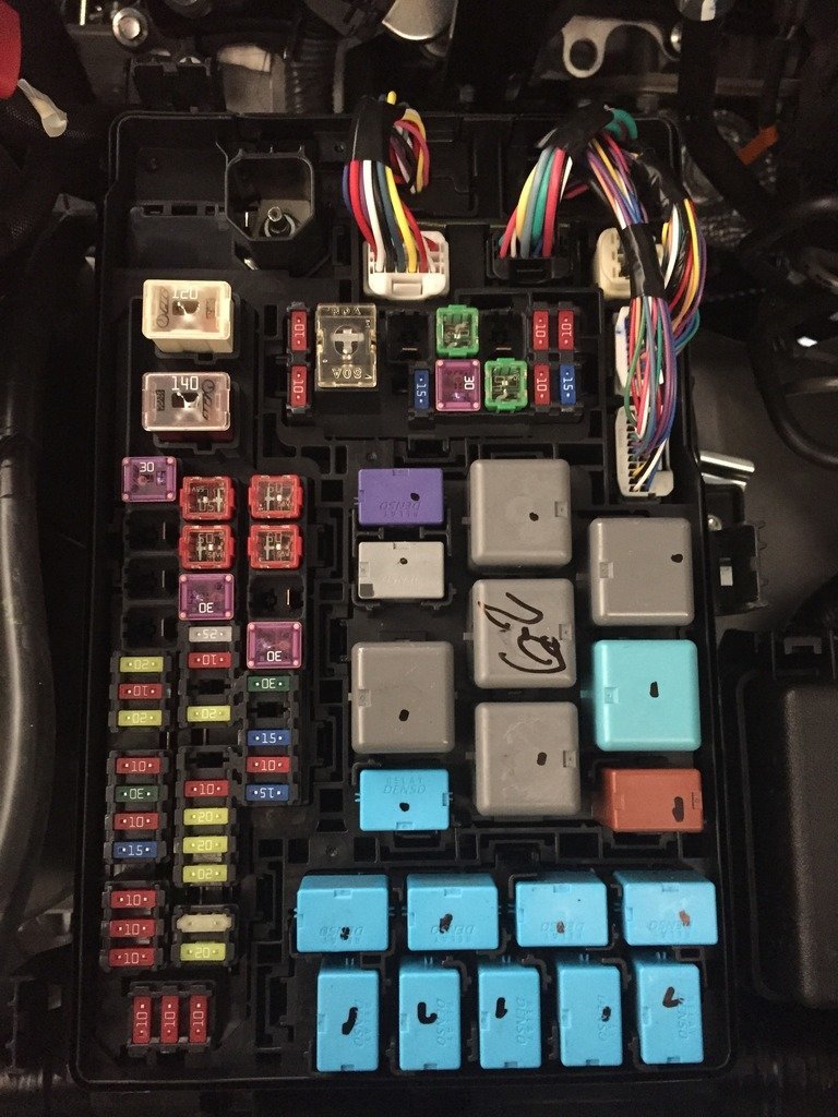

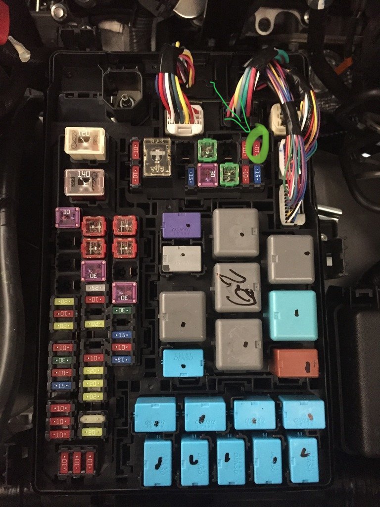

    I just installed the Auxbeam box also and the acc fuse on my ‘17 Tacoma is the very top right.
    I overlooked it 3 times when looking at the diagram cause I was looking with the other small ones I missed the group in the top.
    ** EDIT **
    Top right is not ACC it’s AC so if your AC fan is on your panel is on but if you turn your fans off there goes your panel. ‍♂️
    For me this is not an issue cause I’m never without my fans but will probably correct this in the future.

    Top wire tap is what your looking for, bottom is if your have the option to dim your panel when the headlights are on. You can run them through the wiring loom, won’t have to drill a hole into your fuse box.
