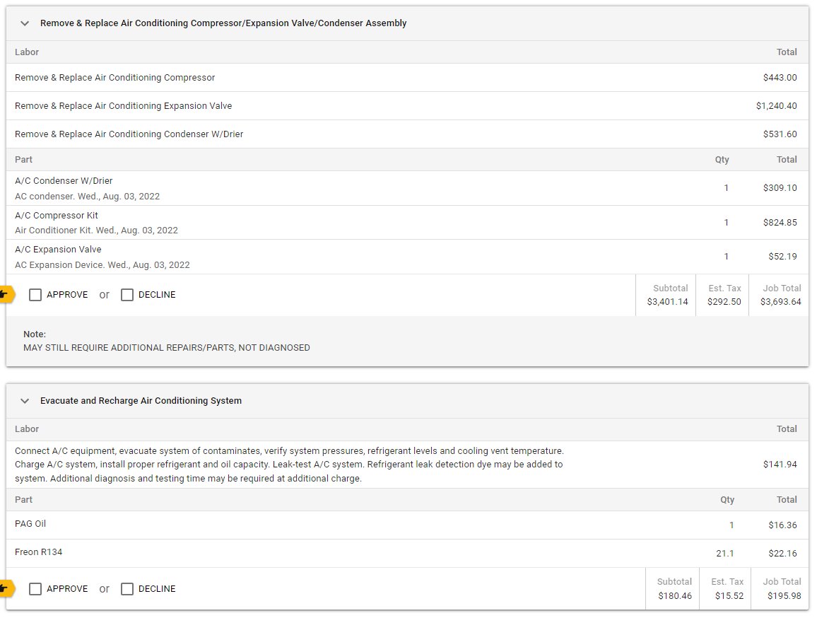

    2007 Tacoma 2.7L 5sp: AC compressor seized most likely due to oil leaking out of condenser (can see green stains at lower corner) so I need new compressor, condenser, o-rings, expansion valve & filter and maybe new Schrader valve cores. Evap and lines need flushing then system set to vacuum, oiled and filled with R134a.
    I usually do my own repairs (former marine diesel mech) but I don't have AC tools and my knees are arthritic so got an estimate from dealer (a little over $4k) and local shop (just under $4k...see below).
    I don't know why labor for the expansion valve is so high. It can be removed through opening in firewall from engine compartment. Maybe they think the dash needs to come apart? Am I missing something?
    Anyway, I've done a bunch of research and using OEM parts and buying tools (Robinair AC manifold gauge set, Robinar vacuum pump, flush kit, leak detector) and fluids (PAG oil, R134a, dye, flush fluid) and having old R134a removed (if there's any left in system) should come out to $1500 (could be a lot cheaper with aftermarket parts and cheapest tools from Amazon but cheap stuff usually means it will have to be done again sooner rather than later).
    I have the service manual and there are many informative posts on this site and good videos on YouTube.
    Anyone else go down this road? Any words or encouragement or derision?

    Thanks for the encouragement. The condenser has a leak so it needs to be replaced anyway. But yes, even if it wasn't leaking I know that it needs to replaced anyway since it can't be cleaned plus I believe the drier is built into the condenser.

    I would ask why the expansion valve is so high. They very well may be planning on removing the dash to get to it. The service manual states to remove the dash which is a waste of time and money.
    You can get to it via the firewall opening.
    Also make sure all the lines are flushed clean.

    I doubt they plan on pulling the dash. Well, not if they are smart.
    Good techs bill book time and work real time. It's how dear old dad was able to be paid 50-60 hrs a week while physically putting in 40.
    Tricks of the trade. Rebuild a carb while you have down time, and when the next arrives, bolt off, bolt on, next please. Or figure out how to change a clutch on an enclosed driveshaft vehicle w/o fully pulling the engine or diff.

    A lot of times we give the customer the option to forgo the exppansion valve and see what happens. Most of the time its all good. Even though you can see the valve, it may be bigger then the opening to remove it or the plate it screws into may fall out of place. If the valve is getting replaced and the dash must come out, it would be wise to change the evaporater and possibly the heater core. Probably the evap temp sensor also. GOOD LUCK. Find a good reputable independant repair shop and gget a quote.

    The valve will come out through the firewall and the evaporator should be firmly held in place. Several people I know have replaced their valve this way. It's tight, but doable.

    if it was me, I'd replace:
    -expansion valve, orifice tube/filter, condenser, compressor, flush
    some cars had a reciever/dryer separate. Others have it integrated in the condenser. Sometimes it comes out to replace or do a flush. Othertimes it's not removable
    Expansion valves are designed to regulate flow. There is usually special tools of more freely flowing dummy "expansion valves" to bolt in place during a flush, to give the flow it needs to perform the flush.
    It takes longer to make one, but if you don't have that, you can take the old valve and drill through it to achieve that flowrate.
