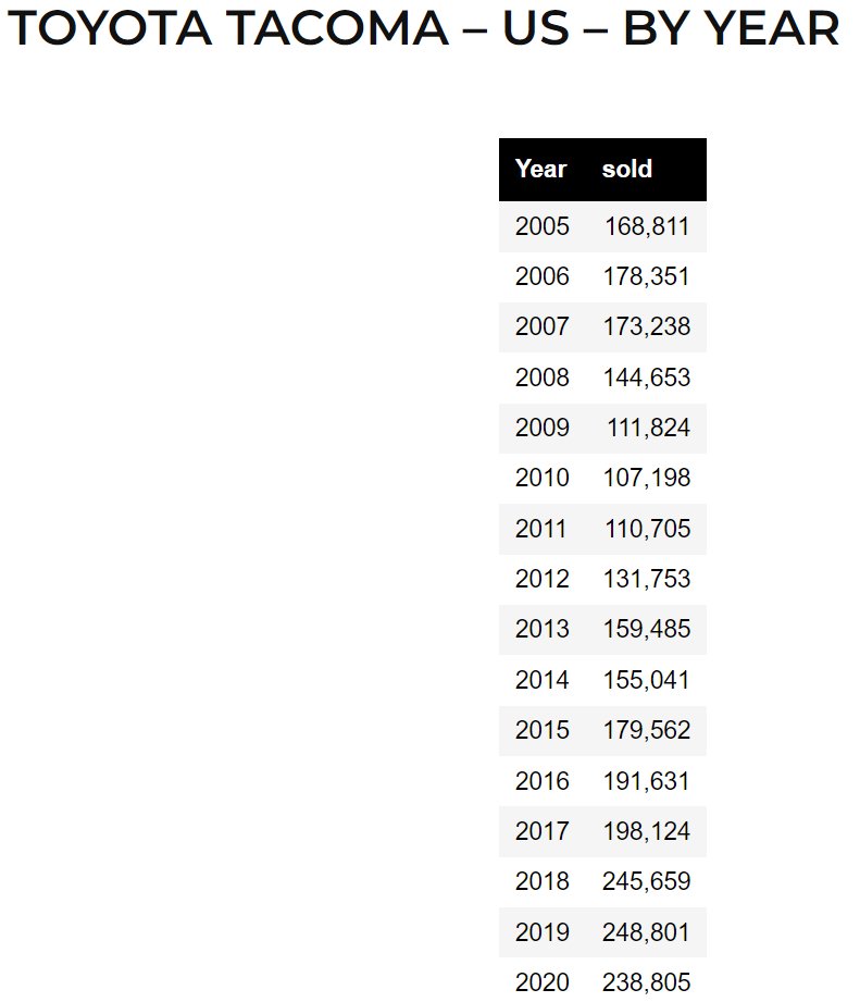

    I wonder how many people have this issue who just live with it or end up trading the truck if it gets really bad.
    Considering Tacoma US sales are +200K trucks per year makes you wonder how many are impacted.

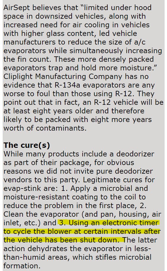

    This was an interesting read from a long time ago:
    http://www.imcool.com/articles/aircondition/evap_stinks.htm
