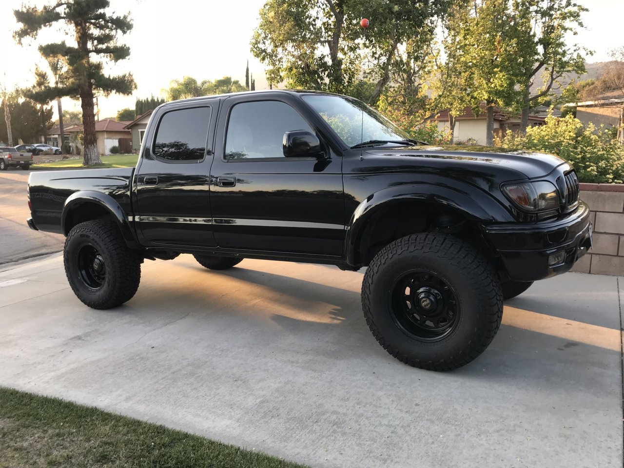

    E1B8FFAE-919B-4AE2-9CC0-118CD05F93AB.jpg Hey All , I just picked up a 2003 Tacoma pre-runner , I live in California and it’s hot out here , the AC is not blowing cold enough and my friend Who I purchased the truck from just put new parts in the AC before he sold me the truck , and had it changed up , I was wondering if there’s anything I can do about making it colder ? Also I’m New to Tacoma world and love this website !
