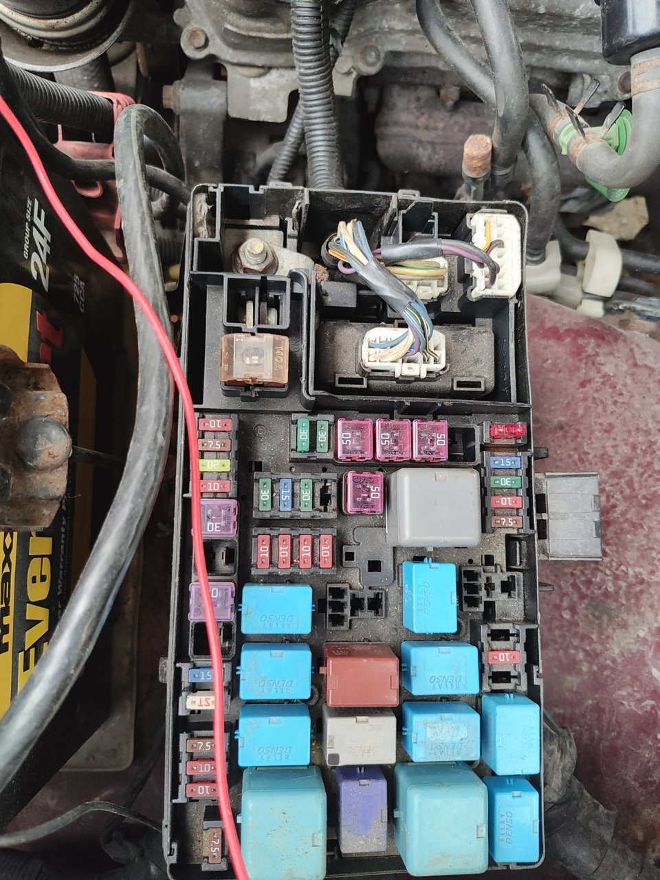

    My ac hasn't worked since I bought it (05) from a guy who put a motor (07) into it. I checked the fuse box and realized the 100 amp one was missing. I bought a new one and tried to plug it in but there was nothing to plug it into. Idk if it is missing a wire or 2, or if It just doesn't need a fuse but on the fuse box it shows one. Anyone have a 05/07 Tacoma that could check their fuse box? Thanks

    The 100A fuse is for the Inverter (AC SKT), which your truck likely doesn't have (only TRD Sport/OffRoad models had it).
    The A/C controls are powered by the 10A A/C fuse & IG1 Fuse, the blower is powered by the 50A HEATER fuse & HEATER Relay, and the A/C compressor is powered by the IG1 No 2 Fuse & MG CLT Relay which is controlled by the A/C Amplifier.
    Does the blower work buy it doesn't blow cold? A/C light flashing?
    Have you checked if it has refrigerant in the system?

    It has refrigerant, the clutch is not spinning when I turn it on. Blower works, ac light is flashing. I checked fuses, probably the compressor?

    Swap the MG CLT relay with the horn relay, maybe you will ge lucky and it's just a bad relay.
    If not there's some other tests we can do.

    Ok what if you jump pins 3 & 5 of the MG CLT relay with a paperclip with the engine running, does it do anything?

    Finally had time to try the paper clip, didn't change anything except the light didn't flash

    Did the A/C clutch engage when you jumped out the relay?

    Make sure you have power at Pin 5 of the MG CLT Relay, if that's good jump the pins again and make sure you get power at Pin 1 (Violet) of the A/C Compressor connector. If that checks out then your A/C clutch has failed.
