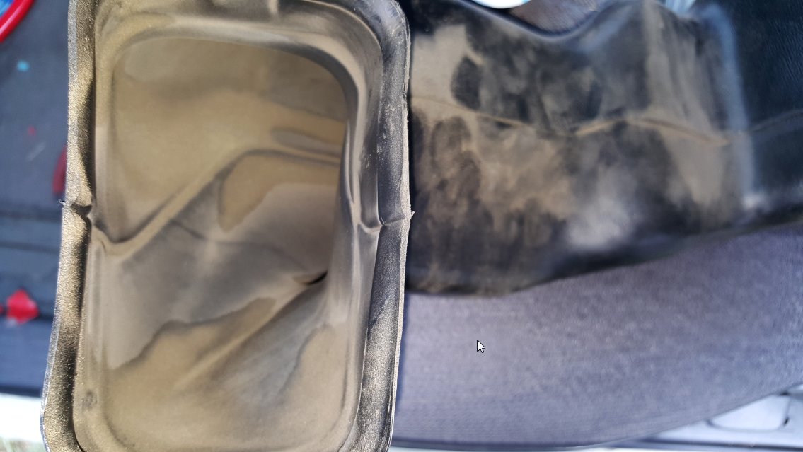

    I have bad news for you guys: any spray or deodorant it is not a solution to clean vent system, but just mask one smell with another. Kind of like scent candle in a toilet - instead of stinking a shit it will smell like a shit in the forest.
    Unfortunately out trucks did not came with cabin filter, so whatever that truck is inhaling it will stay in the heater and AC cores and in vents. When I was fixing my AC (cracked aluminium pipe going to expansion valve - that sucker cost 100 bucks) I had to get into guts behind the glove box. I found a mixture of leafs and mud inside ducts just in front of the evaporator. Evaporator was actually quite clean, I guess condensation is washing it quite well. But that mixture of dead leafs and mud was quite stinky - smelled like old pond.
    The other day I had to remove some ducts for other electrical work and while I should not be surprised by amount of dust collected in last 22 years, I really was. The plastic vents were literally painted with thick layer of gray/brown fine sticky powder (this is non smoking truck).
    Normal washing with garden hose did not clean it - I had to use bottle cleaning brush to get all that crap out.
