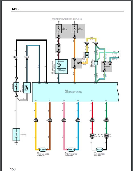

    Don't see a relay. Correct me if I'm wrong.
    Screen Shot 2016-09-05 at 4.51.06 PM.jpg Screen Shot 2016-09-05 at 4.51.23 PM.jpg Screen Shot 2016-09-05 at 4.51.49 PM.jpg Screen Shot 2016-09-05 at 4.52.00 PM.jpg

    I do see a something listed as a relay block on the bottom of the third page. It says it's on page 21. I don't know if this is what I'm looking for or not.

    R/B No.2 is the engine fuse/relay harness. Located on the LH side, between the battery and brake booster. Although it contains several relays(starter,heater,tail & pwr outlet relays), no relays for the ABS are listed. It does house both ABS fuses (30A and 60A) in the location. So I'm guessing you blew one of ABS fuses. The 30A is easily removable. But the 60A is bolted to the underside of the R/B No.2 assembly. Which requires disassembly of the fuse block. Be gentle. Good luck.
    2003 FSM w/ EWD, Here. Most of it is relevant for the 04.
