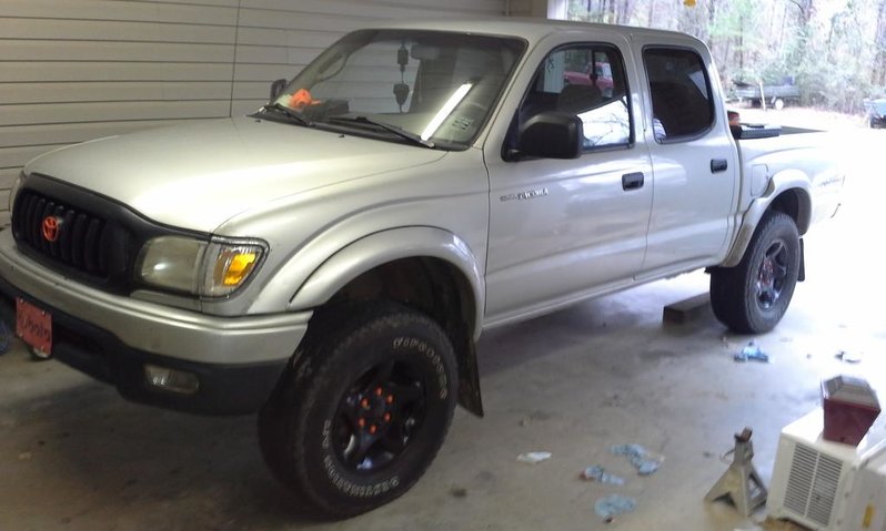

    Ok so they're now painted but a question. When I was painting the temp was between 45 and 50 degrees in the garage but I had a buddy heater down close to the wheels as I was prepping, priming, etc. Should the paint still hold good and cure or am I screwed?

    It's all in the prep. If you took the time to clean, scuff, prime and paint the wheels with good quality products then you should be ok. 45/50F is really too cold but.... If you simply cleaned and sprayed the paint then you might be screwed come spring time.

    Hey OP don't mind the clown who posted the negative post. I did mine in the garage and it was cold outside and mine came out great, I did take a lot of time to clean them first and let them dry, three coats of primer on each wheel with 30 mins of dry time in between coats then I put 3 coats of black wheel paint, they came out great, I also left the wheelsbon the truck. Post some pics when you are finished.

  14. Jan 1, 2015 at 9:29 AM

    Looks great. Enjoy
