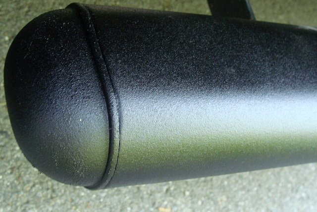

    This is what it looked like when I did the project
    close up
    I will take a pic at lunch of now been on six months....

    Thanks - this is a great shot of the texture and color depth, can't wait to see it now.

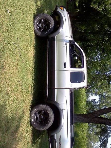

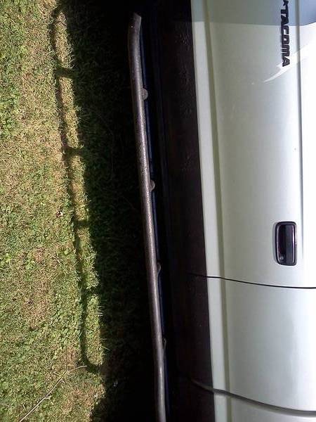

    I think herculiner holds up well for the cost. You can spend less than $100 and will hold up well and look if prepped and applied correctly. I've had my rocker panels herculined for a couple of years now it is holding up well. I get compliments on it all the time. I do need to recoat a few spots that thinned out a little bit but I think I didn't apply enough to certain areas. I think raptor liner would be a better alternative, but not everyone has access to an air compressor to spray their truck.
    Herculiner did not hold up very well on my sliders though and I would recommend rustoleum spray on bedliner to do sliders.

    Thanks for the input and especially the pictures. In the center pic it looks like the aggragate bunched up in a few spots, is that so, or is the finish relatively uniform? Its also nice that your in Ohio so I know your experiencing the same weather & road conditions. Do you get off road much? Truck does look sweet by the way.

    Yeah it kinda clumped together a little bit when I applied it. It was my first time using the stuff and I don't think I mixed it or applied it entirely correctly. If I were to do it again I could probably get it pretty uniform and it may even look better after I recoat the rockers if I ever get around to it lol. I get off road occasionally and you can just power wash dirt and mud off the panels and take a brush to it as well with out any problems.
