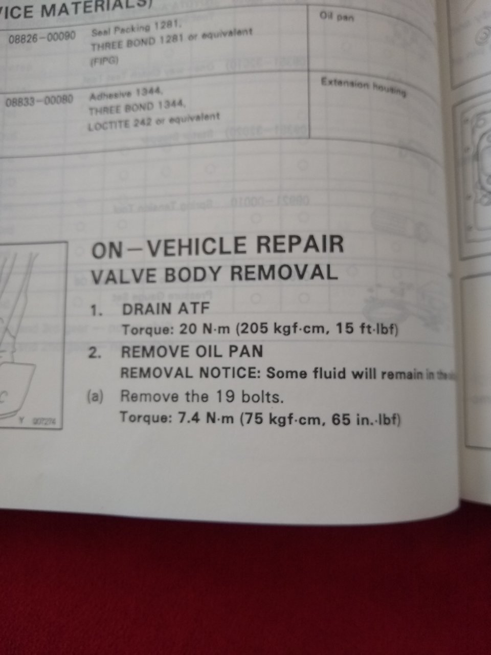

    Does anyone know the torque spec for the drain bolt on the A340F?
    Just looking to do a drain and fill

    11 ft/pds.

    Snug enough so it doesn't drip, I'd guess around 20 ft/lbs or so?
    Land Cruiser manual states 15 ft lbs, I was close. This isn't gonna be one of those specs you have to nail exactly. So nice and snug with regular ratchet or wrench. No breaker bars and no railroading/hamfisting it and you'll be okay.
    I can appreciate you wanting to do things by the book though. Absolutely nothing wrong with that :cool:
