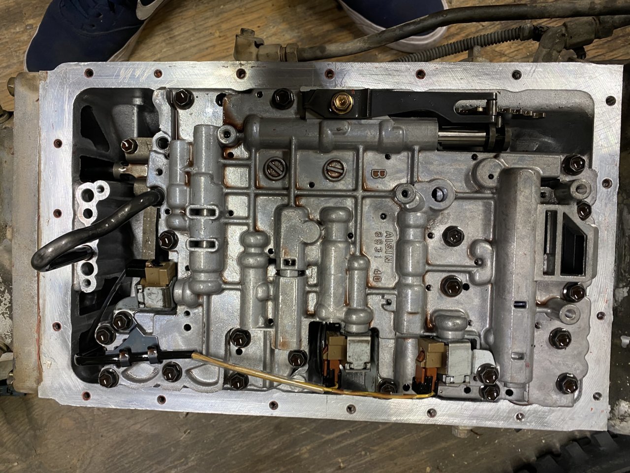

    I just wanted to post a update here incase anyone wants do do something similar in the future. The valve bodies did change, there are 4 different types of valve bodies in these transmissions. However you can swap them between transmission housings with no problems. Including swapping from a electronic controlled valve body to a kick-down cable valve body and vice verse. I bought a 4Runner transmission that had a older short valve body with the tubes that connect the valve body to the transmission case. I was able to swap in my newer long valve body that has the tubes cast in as one piece. Even though my valve body was from a prerunner you can buy a 4wd filter and run the deep 4wd pan. As far as I can tell the newer valve bodies were made to fix some issues with passages leaking so I was glad I could use my newer valve body from the prerunner trans. I ended up rebuilding the entire transmission and transfer case so I could be sure they were in good condition and would last a long time. For anyone contemplating swapping output shafts on these transmissions, if you have a good transmission with low miles I would highly recommend swapping the output shafts. It is not as difficult as it’s made to seem on here. The hardest part of the whole thing is simply getting the transmission in and out of the truck. if you follow a tear down and rebuild manual you can swap everything over in about 2hrs. Make sure you have some long flat head screw drivers and some good snap ring pliers. They really make a huge difference.

    Below is the page from Transgo to help identify which valve body you have.
    Below I have drawn in the tubes one the older design to show what I mean about them being cast into the newer style.
