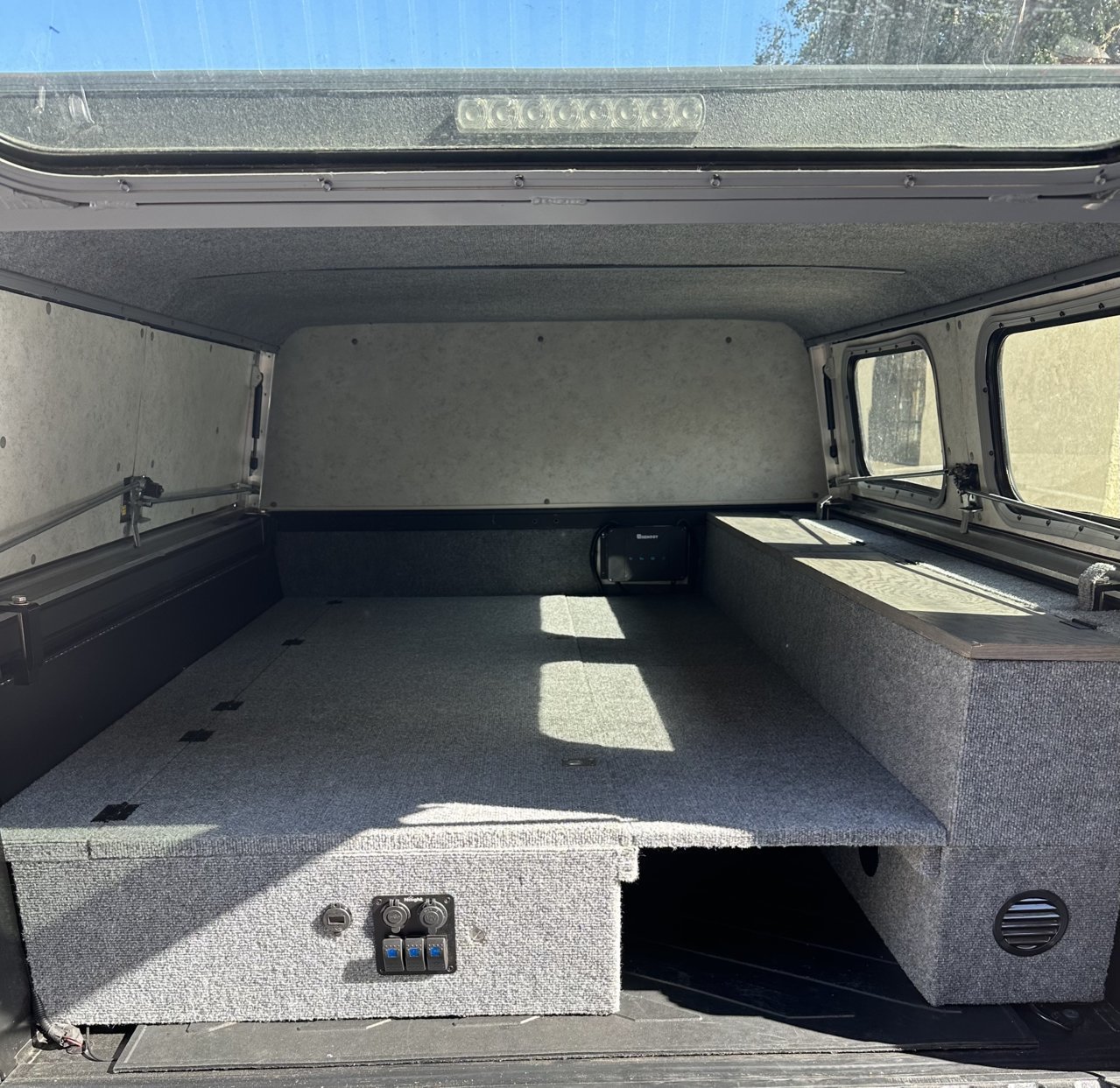

    I got busy and forgot to update the thread. I got it finished. Unfortunately I didn’t take step by step pics. I covered the sides with vinyl wall protection material a friend had left over from a job and the top I used 1/8” hard board covered in carpet then screwed to the square tube frame.
