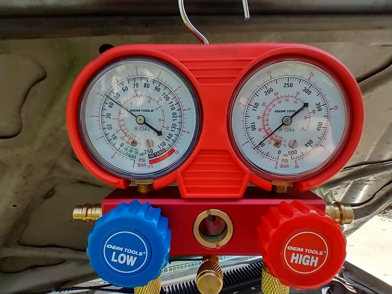

    So I did some more troubleshooting;
    1. Took off the skid pan and checked out the compressor. Belt didn't seem too loose.
    2. Hooked up the ac gauges. Here are the pressure before starting ac and after. Are these readings indicative of anything more than just empty refrigerant?
    After
    3. Turned on the car with ac full blast for 5 mins. Didn't hear anything coming from the compressor.
    4. Went to check inside the cabin. Sound is definitely coming from inside where the evaporator/ac blower is. Next step is to open it up and and see under the dash.

    Not a HVAC tech but it looks like either you don't have enough freon or the compressor isn't working or clicking on.

    Lastly after cleaning the pressure on low side when back up to 0 and high side went up to 75

    Compressor is working or the pressures would not have changed. Your low side is actually drawing a vacuum and the high side is low so I suspect you’re low on charge. Here’s a guide for charging.
