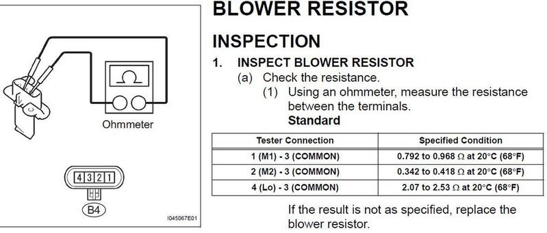

  10. Jul 23, 2023 at 10:59 AM
    Chuy
    Chuy Well-Known Member
    Aug 4, 2008
    #8328
    4,003
    Lakeside, CA
    07 V6 DCLB 4X4 Sport
    Silver Taco
    Stelcom66 likes this.
