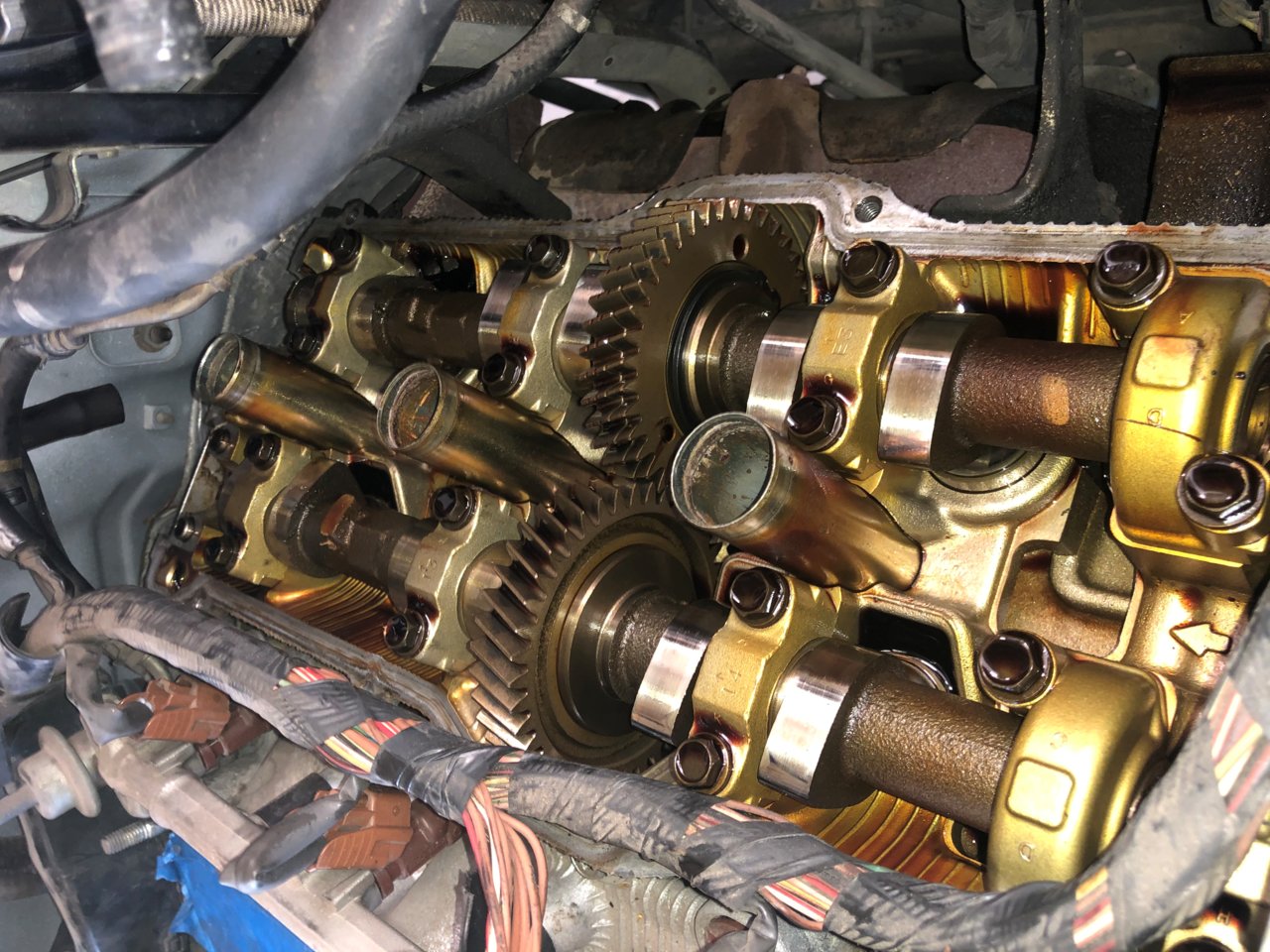

    Obligatory valvetrain picture from the passenger side:vt.jpg
