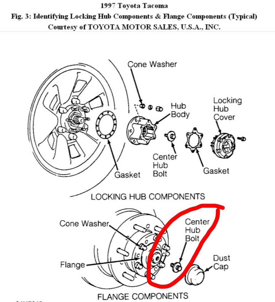

    Im doing a manual hub swap on my 02 tacoma. It currently has the ADD system. I got all the parts from a 98 tacoma. Only thing I'm having trouble with is finding the center hub bolt. Dose anyone have a part number for this. I've been searching all over for it and can't find it. Also from what I understand you can't do the hub swap and leave the ADD actuator attached but you have to put a hose clamp on it to keep it on at all times. Is there an option to do the swap without tho hose clamp? That way the auto would work pluse you would have option to disconnect the axles using the manual hubs? Or is that not possible.

    There is no center hub bolt with the manual hub swap. The manual hubs keep the cvs locked into place, not a bolt, or at least I've never used one or seen one installed before. Might be a thing of the past.
    I had a 4runner with add that I did the swap on and never messed with the add. Just installed the manual hub set up and it all worked as usual.

    All the info I find on the manual hub they all have this bolt. Did you run it without it? I think it's a backup incase the C clip fails.

    Part No.: 90119-08466
    BOLT, W/WASHER
    I got mine on toyotapartsdeal.com for $1.25 each.
    And yes, you can run without them.

    Hmm never seen that bolt with both my manual hub set ups I've owned. Makes sense it would be there.
    Yeah just locked them and unlocked them as a non-add system and no issues. Although I did have the multi mode 4wd/awd system so maybe that made a difference.

    Like previously said, it's a backup to the c-clip. It's also convenient to use to pull the axle all the way through the hub so you can get the c-clip on.
    However, I ran mine for years without the bolt, without an issue.

    My 98 has manual hubs and I just had them apart. There is no center bolt at all.
