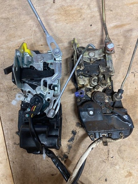

    I removed my old latch and compared the two parts on the bench to see if I at least had a shot, and here's what I found.
    Basically some minor differences, but overall things looked like they matched up pretty well. The even had the same style harness connector which was a happy surprise. I tried looking at wiring diagrams to see if I could determine if anything was wired differently but I think both of these latches may be aftermarket, as I wasn't able to match up colors on the diagrams for either year. I figured what's the worst that could happen right? :nuclear:

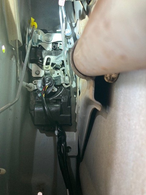

    So I hooked the new one up to the door harness and.......it worked perfectly normal. Sweet! It also bolted right in and all the control rods seemed to fit decentlyIMG_1117.jpg
    Most importantly, the latch where it contacts the striker didn't look like it had been beaten to death over decades of mistreatment. (comparison of installed new latch next to old annihilated one).
    I tested the door and handles before buttoning the thing up and oh man, it closed like a dream. It's never been so easy to shut.
    I did have a couple issues that honestly may have more to do with the condition of my truck than the new part but I'll lay them out here and what I did about them.
    First when I went to open the door from the outside, the handle didn't work. I feared it was going to kill the whole project but then I found that the lever on the new latch wasn't quite catching the clip on the outer door handle. A small amount of persuasion got the bend in the latch lever to catch the outer handle just fine. Now it works every time.
    Second, the rod going up to the manual door lock nubbin on the windowsill felt pretty stiff when moving it by hand. When I went to use the power lock, I found that it was so stiff that the lock actuator would try, but then back off and not actually move the lock. Again, a little persuasion was all it needed :smash:. I spent a little time finagling the bends on the rod running from the latch mechanism up to the door lock nubbin and eventually got it shaped in a way that didn't seem to interfere as bad. I put it all together and, while that manual lock still feels a little stiffer than the original part, it moves enough by the actuator for it to work via the door lock button :thumbsup:
