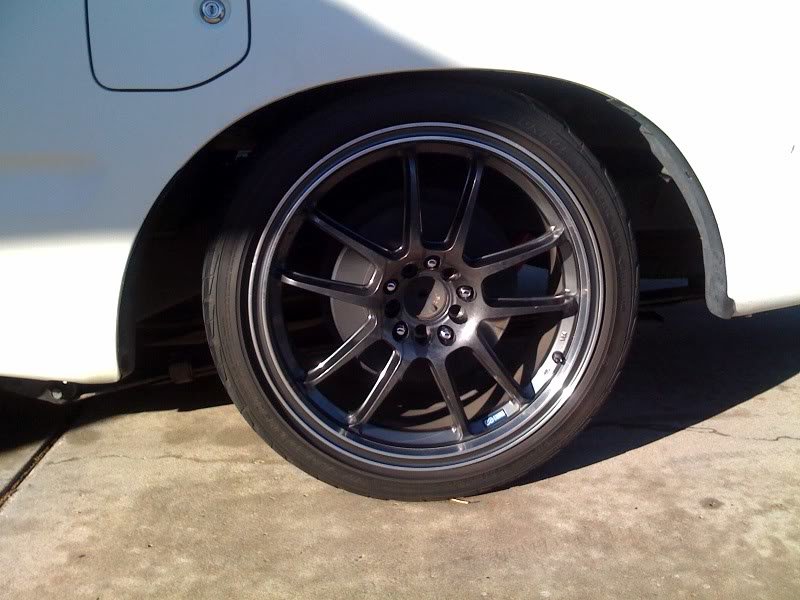

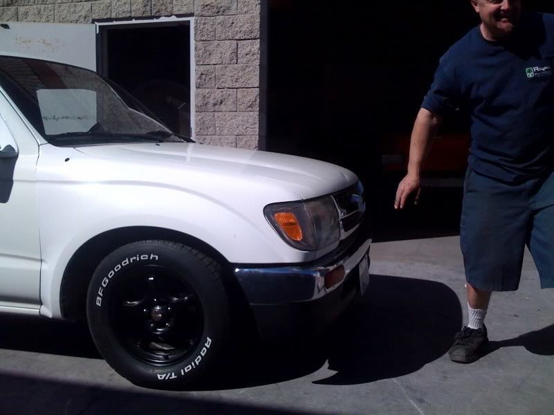

    My old 98 with 15s and 18s..
    Got the 15s from discount tire and the 18s off another member.
  10. Mar 25, 2015 at 1:25 PM
    Artruck
    Artruck Well-Known Member
    Jun 27, 2013
    #107173
    1,687
    Lawrence, KS
    '09 Super Basic
    As a general rule I'm not a fan of the white lettering out on tires, but that looks pretty sweet on you truck.

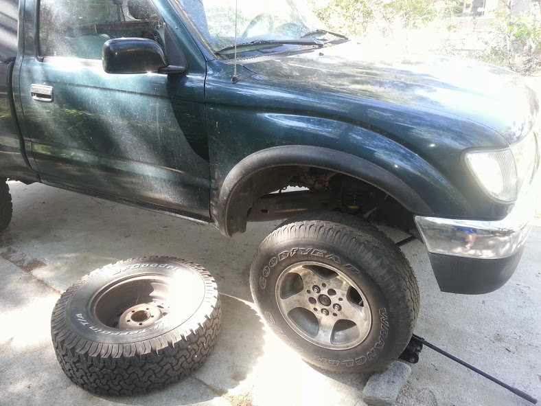

  17. Mar 28, 2015 at 12:25 PM
    #17
    highvelocitytaco
    highvelocitytaco [OP] Well-Known Member
    Mar 25, 2015
    #151747
    72
    queens ny
    1996 2.4 tacoma 2wd
  18. Mar 29, 2015 at 8:19 PM
    #18
    Tour991
    Tour991 Supplier of used parts
    Nov 24, 2011
    #67616
    10,643
    James
    South Reno/Tahoe
    97 2/4wd, 2014 DCLB 4x4, 99 T4R Limited (sold) 2024 4runner TRD Pro
    this is my 97 i had the jeep canyon rims on it for a few weeks. they fit just fine.
