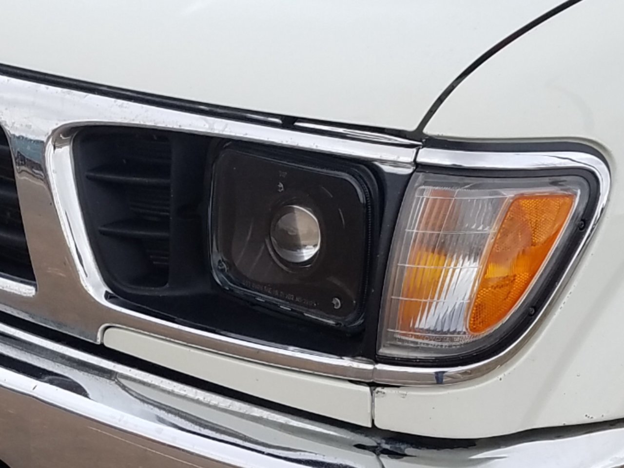

    LED are ok for a cheap fix,
    Projectors are the best but expensive and a chore to do.

    Projectors are so nice, even if you have to save up and dedicated time to the install they are amazing93C5C54D-61A4-40D4-A69F-73C730228586.jpg
