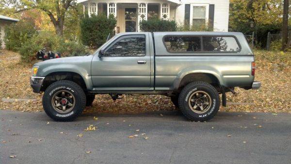

    New Update on 12-14-14: 100,707 miles as of this photo
    [​IMG]DSCF3262.jpg by ChazLylePhoto, on Flickr

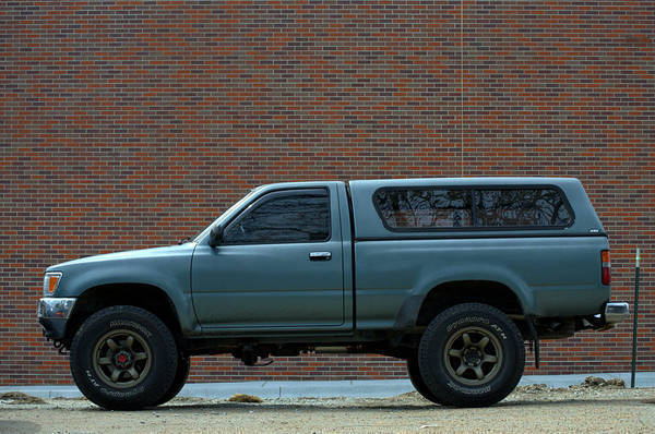

    Here is how my Pickup sits as of 4-28-13:
    Well I finally decided to keep track of my progress and start a build thread.

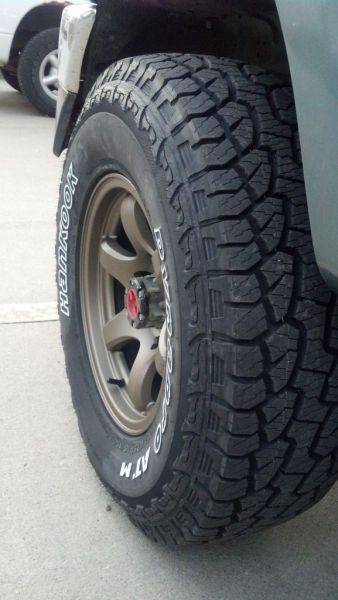

    -16x8 Konig Countersteer Offroad 4.5" BS [18lbs]
    -P265/75R16 Hankook Dynapro ATM RF10 114T [40lbs]
    Suspension:

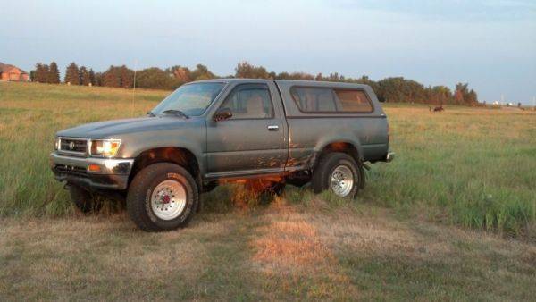

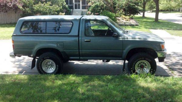

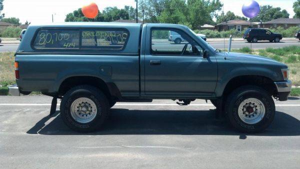

    These are some of the pictures I got from the dealer a state away while i was negotiating. It had stock wheels/tires (28") and I had them put on the 31s off another Toyota Pickup they were scrapping because it was too rusty.
    You can see the rear wasn't horrible, just sagging a little.

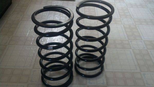

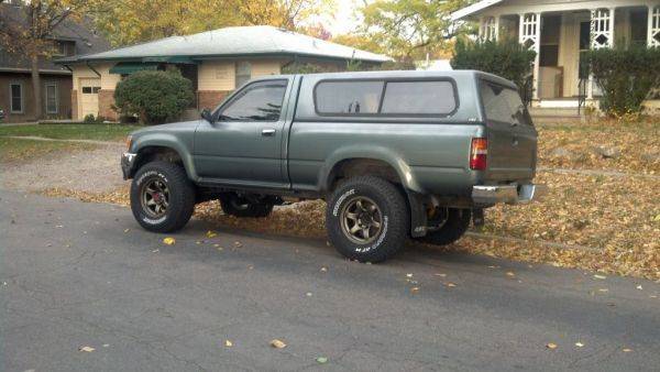

    No Cut ZUK Springs [100# rated rather than the usual 125# that most use]
    Installed those between the rear bumpstops along with OME shocks and steering stabiliser:
    More South Dakota Parking, something in the water me thinks. . .

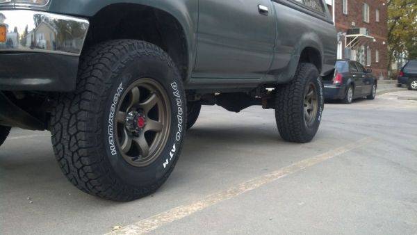

    AND new wheels and tires are on, perfect fit and the lighter weight makes a huge difference when your pushing 119hp with a 22re

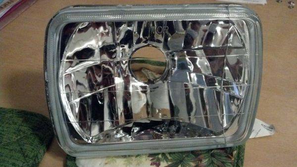

    Working on my retrofit now but my lenses cracked in the oven :mad:

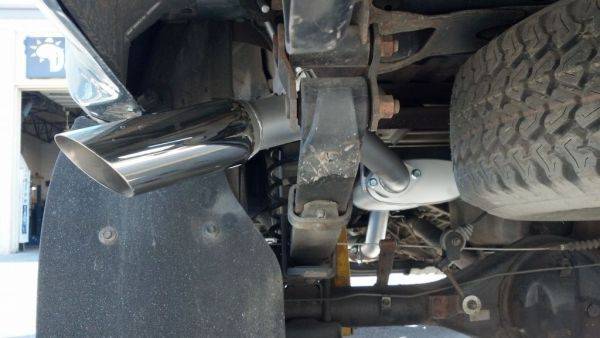

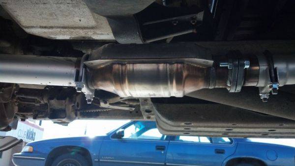

    All parts are in, NEED A RESONATOR to say the least, maybe a little bigger muffler. More annoying than I anticipated haha but the difference is in throttle response is more than butt dyno noticeable and getting up those hills in 5th is significantly easier. less downshifting around too to make it up certain hills too, here are some pics, more to come :D
    drives great, not horribly loud but definitely more annoying than I personally like.

    Any reason you left the cat in place? I probably would have just scrapped that thing out. Is that an 18 inch magnaflow?
  11. Nov 8, 2012 at 12:20 PM
    BuzzardsGottaEat
    BuzzardsGottaEat [OP] Well-Known Member
    Apr 27, 2011
    #55669
    8,574
    Some Toyotas
    Round tires
    Its a new cat, 12.5x2.25 from LCE so MF
  12. Nov 8, 2012 at 12:22 PM
    chadderkdawg
    chadderkdawg Don't ask questions you don't want the answer to..
    Apr 29, 2011
    #55763
    8,148
    Des Moines, Iowa
    09 FX4 F150
    I plan on using an 18 in MF on mine, they typically have a much throatier and quiet note. You may consider upgrading, or putting a small glass pack somewhere in your current setup.

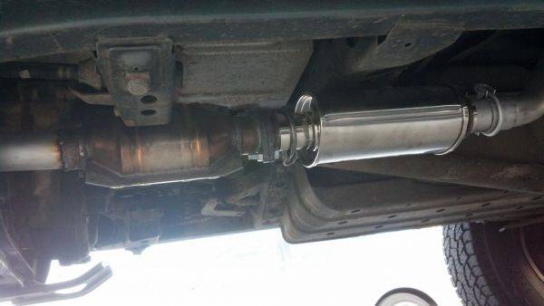

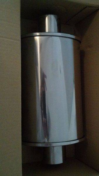

    Vibrant Ultra Quiet Resonator should be here Monday-ish. There's not a lot of room between the pipe and the frame but I hope to mount it after the header and before the cat. Will post up if I am satisfied with the result asap.
  16. Nov 14, 2012 at 1:58 PM
    #16
    BuzzardsGottaEat
    Apr 27, 2011
    #55669
    8,574
    Some Toyotas
    Round tires
    Vibrant Ultra Quiet Resonator is in
    Had to kind of hack job it all to make it fit haha the cat was where the resonator is. Had to swap them positions because the resonator wouldn't fit up by the t'bar
    Mucho quieter, still a bit of cackle from the super powerful engine but it was like that even before the header and everything.
    More to come after the holidays :D someone has to buy me something so it'll probably be me!

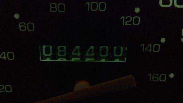

    Not bad for a 20 year old Pickup. Got another 3-400,000 in it I hope :)
    Headed for a few hundred mile road trip for the holidays tomorrow. Looking forward to see how the new set up handles the usual hills on the highway, what the gas mileage is looking like now, and how the new lightweight wheels and tires contribute. The resonator really help but I'll roger up on any highway drone or anything. I'm very happy with it as is. May do some sound deadening at most if it's too much. That is all for now. To sleep with me, early start tomorrow.
